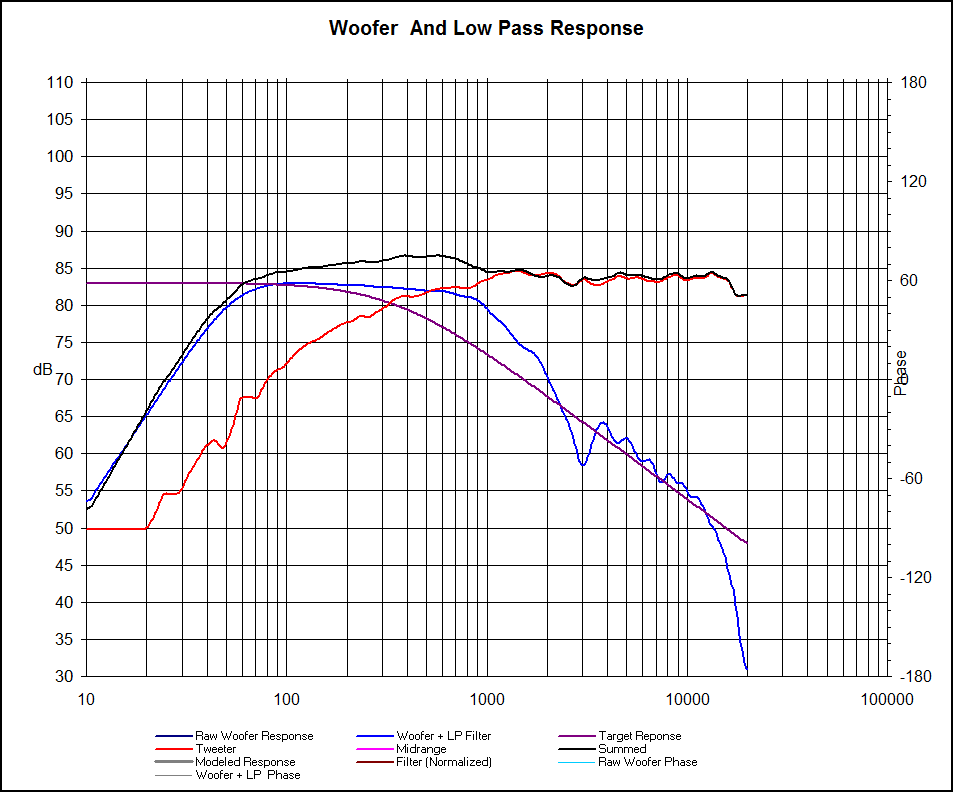

Why is an aluminum cone driver bad for BW1? Breakup? I am not sure a paper driver is any better band width wise from the plots I have seen.

I am only using these silly BW1's as they seem to be required to get perfect SR? Recall my initial design on post 1 in Akabak assumed LR4 at 500Hz! Is there a way to get perfect SR with higher order filters?
Metal cones have a higher break up peak and also high ringing (CSD) compared to paper. Otherwise you'd be correct that the bandwidths are similar. Typcially, an aluminum cone driver needs to be crushed about 12db at breakup more than a similar paper cone driver. At 6db/oct that means 2 oct lower than you are now

I'd answer that question with a rhetorical question: Why get perfect step response?
I did see your OP with LR4 and didn't bother asking why go to BW1. Seems to me to be a step backwards. But everyone has their own goals so I didn't mention it.
To answer your question directly, with active you may be able to do LR2 and then delay the woofer until you have perfect step response and perfect phase summation. But I don't know, never been bothered to consider it. I'd rather have the woofer breakup buried in a grave and have a 1/4 millisecond of step response offset than have perfect step response and hear that awful sound of woofer break up.
I don't see a problem with delaying a woofer if that's what is required to achieve summation. If the tweeter is lagging phase, then lag the woofer too. Perhaps I'm missing part of the conversation around this?
No, I don't think you are. It's just that the woofer is already physically behind the mid. So delaying it further would seem to cause the time arrival to be even further off. But, it brings the phase in line and I'm assuming that it brings it around a full 360 so it's right again, but my mind is struggling to visualize this.
Delaying the woofer was the only way to get phase correct, thus proper summation in my sim with these BW1 filters
Posted while I posted Seems we agree.
Yep, we do. I've been trying to help meet his goals anyways, but it's damn hard. LR2 would have been just about finished 20 minutes after reading the first post.

What he said That's why I have been trying to get you to take a good look at that breakup for a while now. you're only down about 10-15db based on your measurements. Should be -40db at least with that driver.
That's why I recommended to Byrtt earlier that the brother of the 10f, Scanspeak 22W/8534G00 would be a better choice. The dayton's great, especially for the money, but just like even the most expensive drivers it has to be used within it's limits to perform

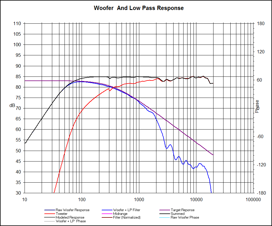

Ok I see what the issue is. What is being missed is what the XO filter does to phase, thus acoustic time. In PCD, change the low pass filter from say 400 to 200hz. See what the phase does. Now add delay. See what the phase does. The phase keeps moving left, or from positive to negative.
Now do that to the tweeter except with the high pass filter. Maybe change from 200 to 400. Now try adding delay. The high pass is moving the phase from negative to positive yet the delay is changing phase from positive to negative. So really it's not all about where the drivers phyically are. It's also about their phase angle (natural) and the filter poles.
In PCD you can also play with the z offset to further see what happens to phase. This is essentially identical to delay, just in distance rather than time.
Ok I see what you mean. I could see why it worked in PCD, but I wasn't quite grasping the differences in phase and time once put into the real world.

It seems that you guys are concerned that the woofer is not down low enough in the stop band. Well that won't get better unless I go to -12 or -24dB per octave filters. But looking at my response curve it is within +/-2dB (above XO) so reasonably flat and HD plot, albeit at low SPL doesn't t show any distortion that appreciable. I recall an earlier woofer only HD plot showing essentially no contribution from the woofer at the breakup frequencies. So it seems that the XO is doing its job from separating the drivers even though a lower order filter is used. Acoustically it is ending up around -12dB/octave.

"Another thing you might try, is to target a BW1 on the woofer for 2-3 octaves past the crossover and then roll it off much steeper in the breakup region. Sims show it cleaning up the little phase problems in the treble and it starts getting the breakup down where it should be.
This may or may not effect the SR, but it should help if you find the breakup objectionable. Try listening to the RS225 on it's own with the xo attached. This'll help you pinpoint issues with the sound.
I don't see why you can't achieve the BW1 target slope on the dayton if that's what you want.Acoustically it is ending up around -12dB/octave.
This is what I got with basically the same settings as you when you measured the woofer xo acoustically at 900ish and it matched your measurements perfectly so you should be able to match my sim without much problem.
Once again, and I'm not the first to mention it, you can't really get good distortion measurements at 82db @.5 meters. You're in the mid 70's at 1 meter. You should try 96db at .5 meters for the minimum. Or adjust for around 90db at 1 meter, but remember that if you measure distortion nearfield, the numbers probably won't be accurate higher up where we're interested in.
Also, try a CSD to look for ringing.
