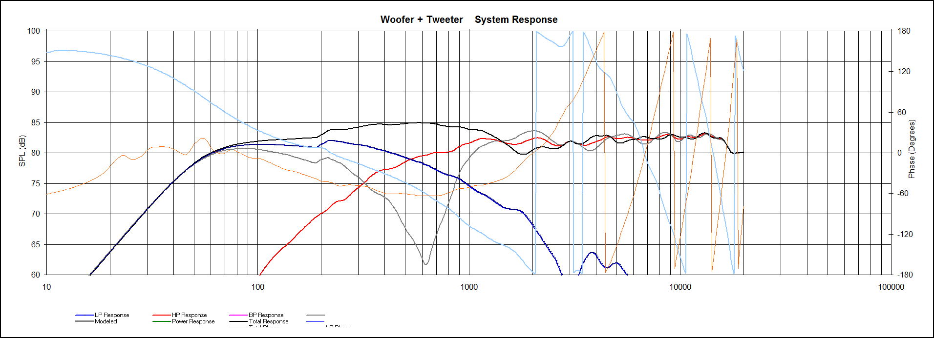

This is what I get with your settings, xo on woofer @250, xo on 10f @350. -.22 delay on 10f. polarity reversed (case D) Gray line null is pos. pol. My peq settings are different so the response is probably different.
Anyways, see how the phase crosses but does not track even though the null is fairly deep and symetrical? And the point of the null is centered on where the phase crosses and not necessarily where the acoustical crossover is.
Your null is certainly at 350 and mines not, but that could be due to peq settings and overall level of the 10f in mine
The placement of the null is based on the FR too. Phase will change with FR and with reflections it's altering the phase. I'm betting that if you took it outside, your null would change too
That would lower it a little, but not much. I have a bit of peq on the 10F and the roll off of the rs225 is smoother in mine. Since yours dips past the crossover that could have some effect on the observed xo point and overall response.
My point was just that with a deep reverse null, it doesn't always point to real great phase outside of the crossover as shown in the graph
satx, the reverse null can tell you everything you need to know about phase if you know what to look for. In your simulation you can see the response "flips" at 2khz. This tells us the response is out of phase there.
The only thing the rev null can't tell you is the phase angle which frankly doesn't matter. All we care about is whether summation is maximal for the entire overlap.

See how both drivers cross at 500hz? That means the null should hit the floor right there, but it doesn't. This tells us the phase is not very good around there.

Yes, you're right. I didn't want to get into the width of the null vs xo order and the symmetry.
I've been talking about the cancellation shown with proper polarity and the flip elsewhere when reversed for days, but X's assertion is that if the step is good then the phase must be good regardless of what the FR tells us.
And the graph I posted was just to show that the null may be wide and fairly deep, but you can still have poor phase tracking either side of the crossover, pretty much what you said above if I'm not mistaken.

Tuxedocivic, what are your thoughts on delaying the woofer to bring the phase in line. Does this work in reality or is this a simulation anomaly? I've never done it and really have no idea. It doesn't seem to make sense to me.
I don't see a problem with delaying a woofer if that's what is required to achieve summation. If the tweeter is lagging phase, then lag the woofer too. Perhaps I'm missing part of the conversation around this?
I still wonder why it is that the good step response seems to be at odds with a good phase response ? Probably indoor reflection as the limitation? Given that, is the SR more indicative of a better XO or good phase?
Step response only tells you time alignment and is quite coars. Phase tells you time as a function of frequency. Phase is a better indicator of summation. You can be 360° out of phase and have perfect summation and bad step response.
