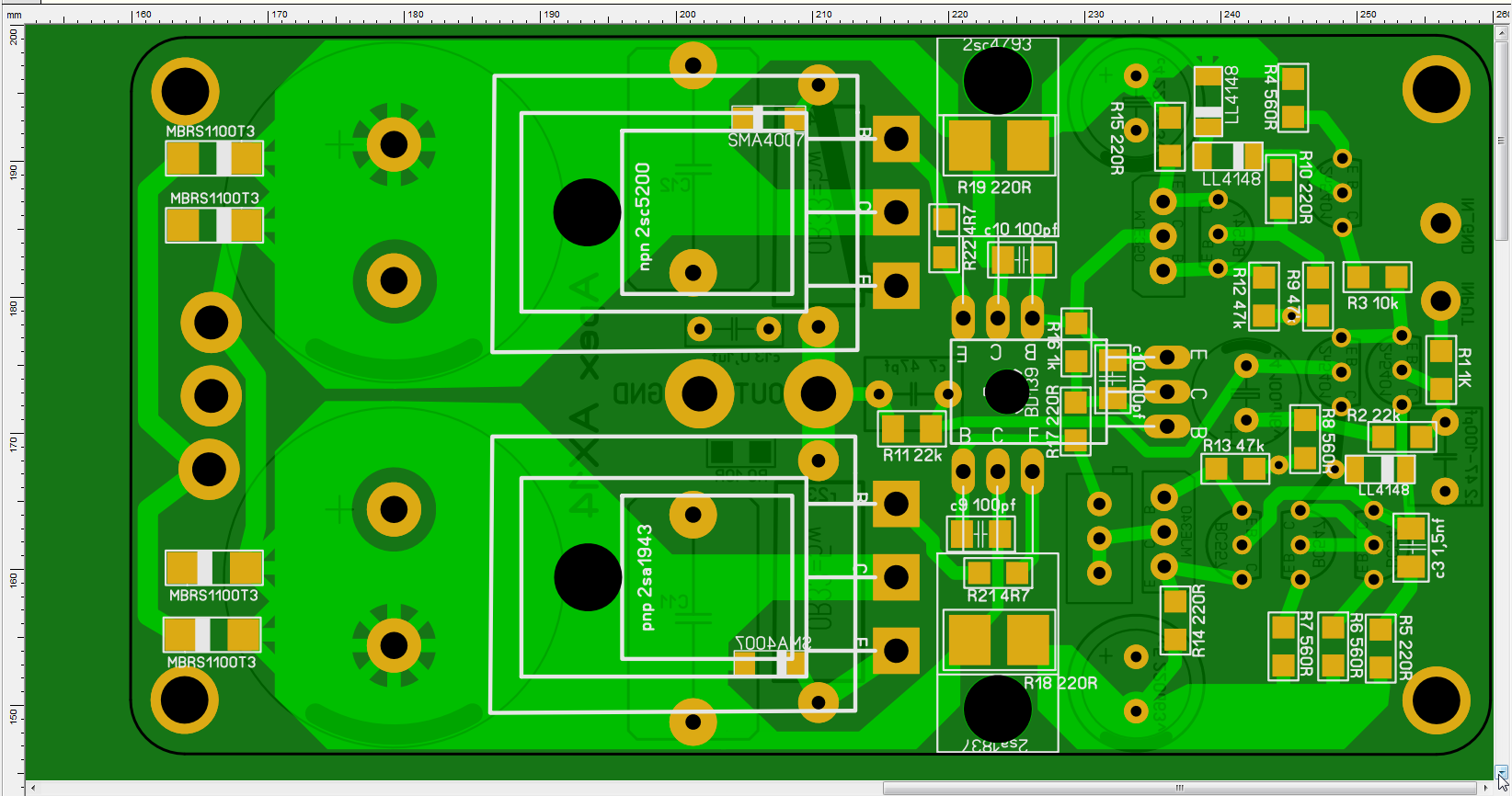

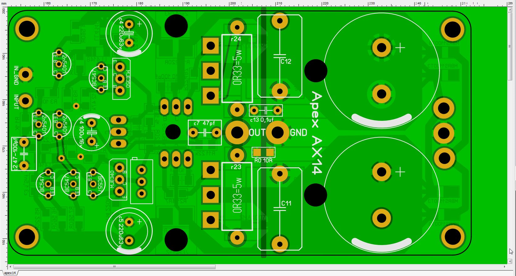

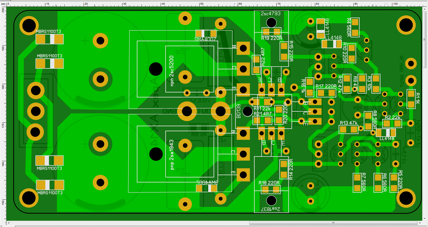

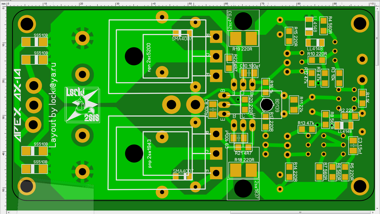

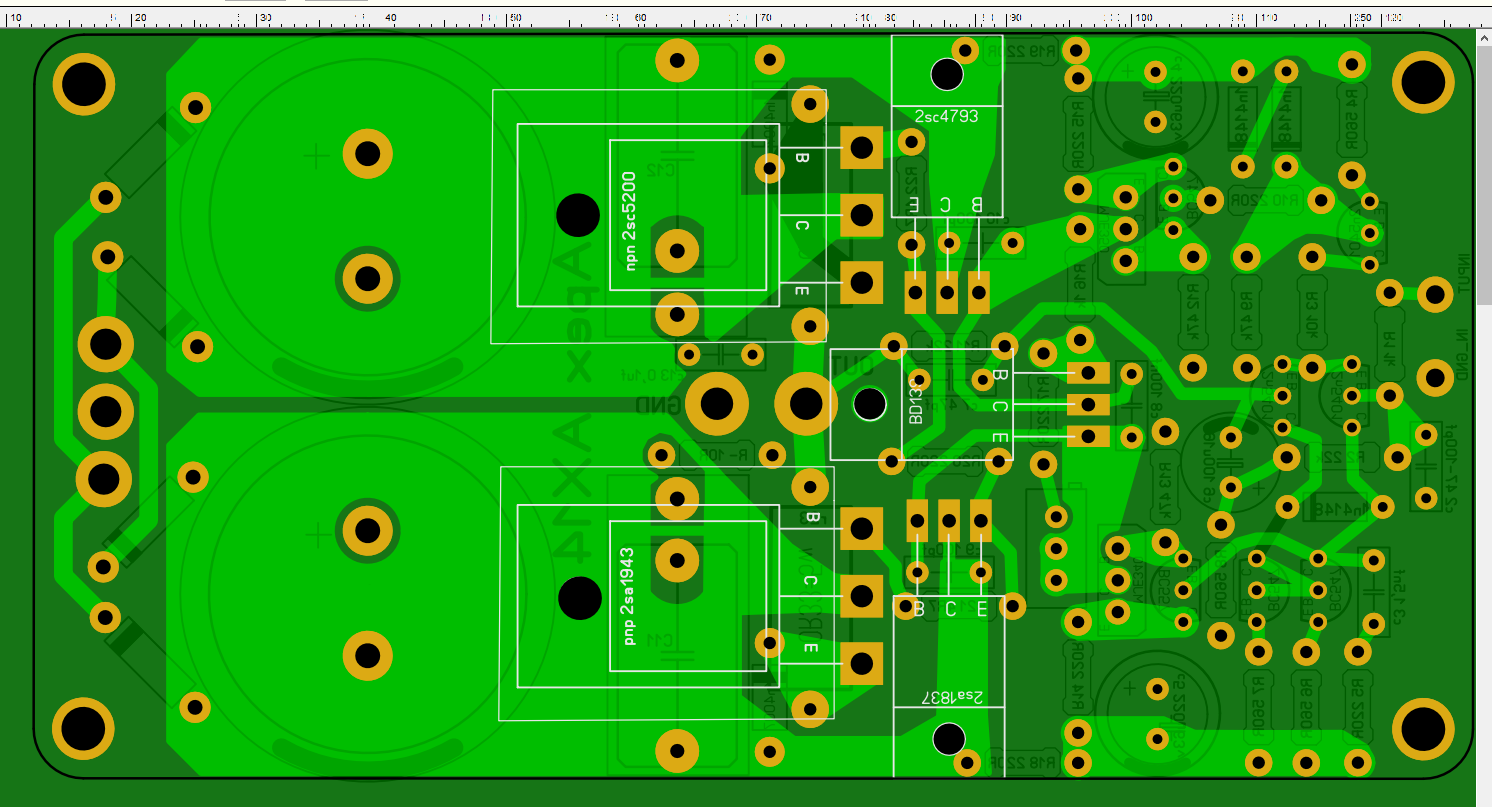

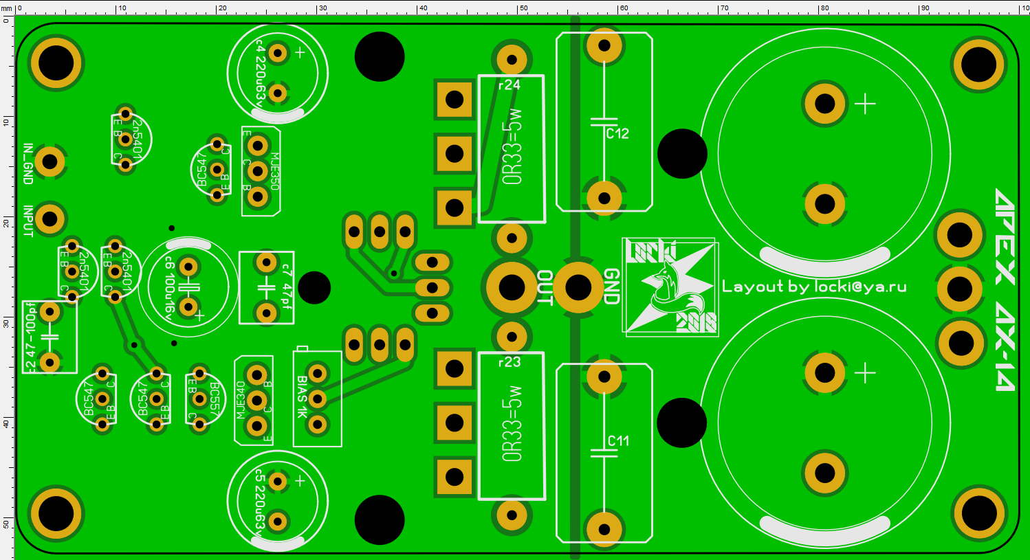

Hi. Мake an amplifier layout, was parallel to the radiator. Please see if everything is correct and important, here is the 10 Ohm resistor. Do I understand correctly that it should be (as well as the capacitor C13) combined signal and power ground?
So... 100mm long for China manufacturer -)))
transistors smd... just too lazy -))))

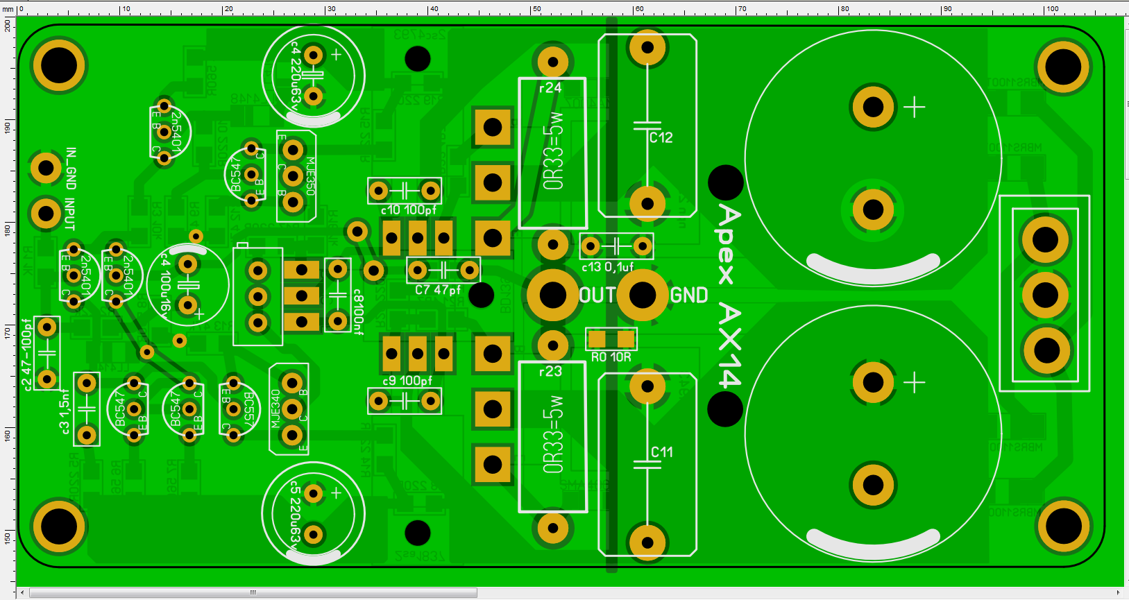

there is only one question left. 10ohm resistor is needed to combine the signal and power ground?

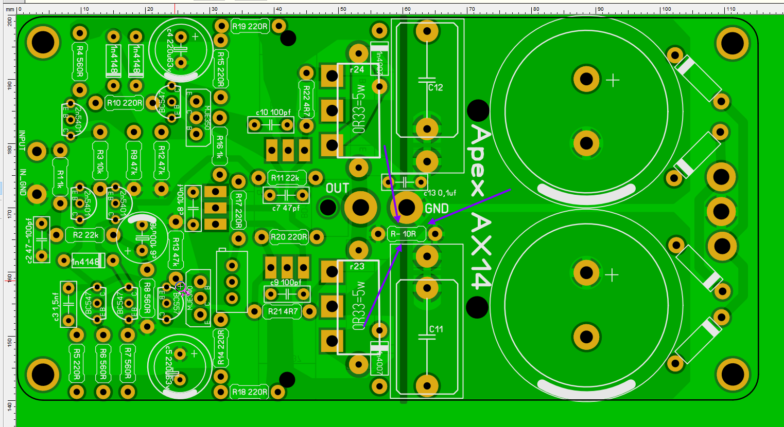

Hello Astaro,
Nice layout. Do consider mechanical mounting convenience of o/p devices.
Also MBRS1100 @ 1amp might be a little weak for this amp. I could be wrong also.:)
regards
Prasi
I believe in the original design, the input ground joined the power ground at the PSU and there was no 10ohm resistor.
It is still the case. This resistor is there for safety reasons; like when people forget to tie the input gnd to the supply ground at first power up (wasn't the original value 10 ohms instead of 100 ohm?)
And yes, I too believe it is the better way to wire power gnd and input ground separate to the power supply gnd.

just in case will install MBRS2H100T3G. (100V, 2A)
And how about resistor? it is needed?
Even 2A will not cut it. The AX14 amp is rated at:
* 80 watts in 8 ohms: you'll need at least 3,2 A
* 100 watts in 4 ohms: you'll need at least 5 A
Way better to use diodes who have a large safety margin. You could use something like a BYV42.
About the resistor, see my previous post. It is there for safety reasons but since you are including the power supply on the amp pcb you should short the resistor and make sure you have a direct trace from the input ground to your "star ground" on the pcb.

I have the transformer, it after rectification gives 2 x 30 Volts (160 Watts). It so small voltage to put something instead of the Schottky. And 2 Watt diodes, I think, enough. I will not organize a disco at home-)) may be I 'll find 3 watt diodes Schottky -))) I will think about it. Nowhere to hurry.
Sure, I would simply advice to select diodes who can handle at the very very very least 4 amps. This way your safe on the power supply side (I guess your transformer is rated around 4 amps). If you want to keep it simple and small then the bridge rectifier Prasi mentioned is a good alternative.
Even if you think you will not turn up the volume too much, you never know how many amps your amp is drawing at a given time. It would be a shame to blow up the power supply by accident. There are other issues to consider: if you don't have a speaker protection you could easily blow up your speakers in the process. The AX14 amp deserves a good power supply.

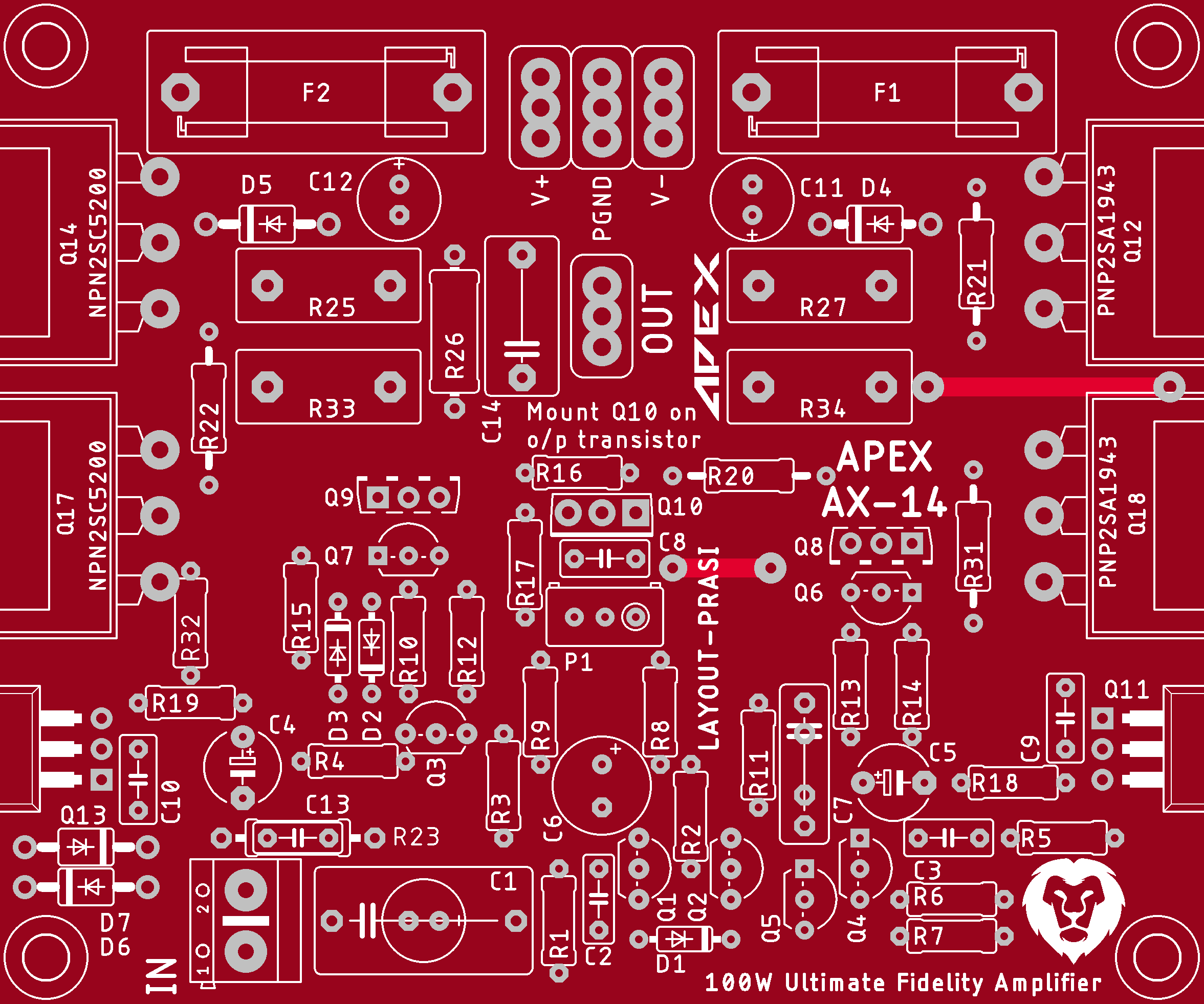

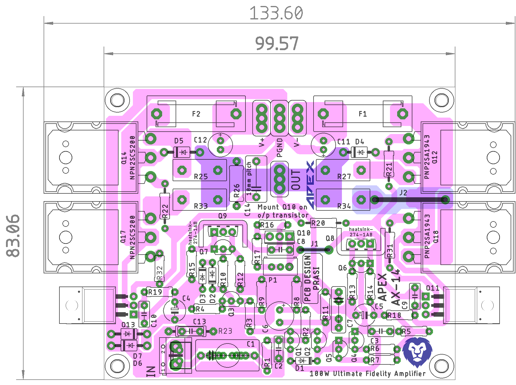

I have it shared here. You may download gerbers.
W61084ASN13_apex ax14_total new_2pairs_rev1- Share Project - PCBWay
let me know if its not convenient, I can post here as well.

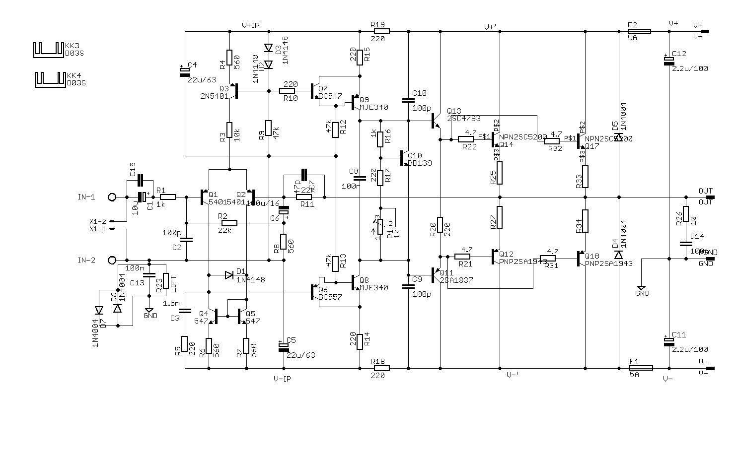

Hello Chatchai,
Please find attached herewith the stuffing guide and sch. It only contains ground lift components (10R+ anti parallel diodes as an option) as additional. These can be also left out and i/p ground can be connected to PSU ground as per original APEX advice.
Also it is with 2 pairs of o/p devices.
Otherwise the schematic follows the original AX-14. I am collecting the parts to build it.
