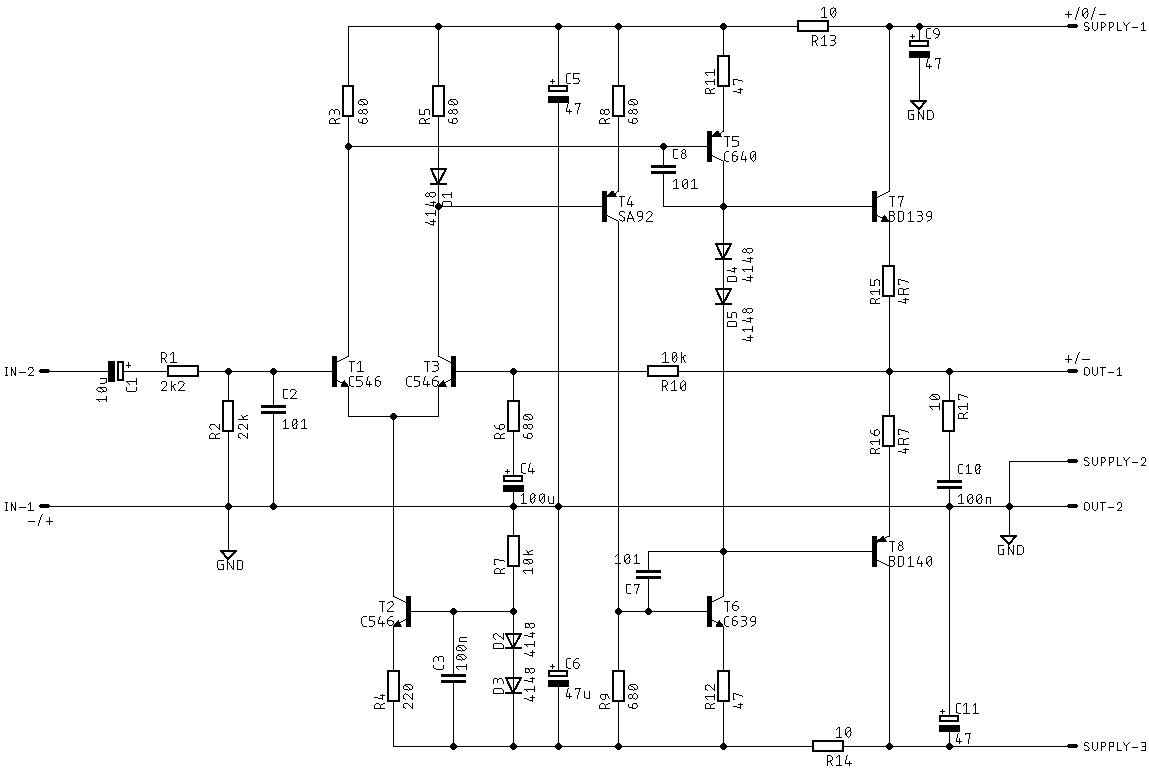

Replacement from BD139/140 to 2SA1837/2SC4793 can be done and sound imrovement will be fine...as i know nobody have build P8 preamplifier so you will be the first one.
Apex uses easy available electronic parts so they are used because you can easy get BD139/140 in local store and 2SA/2SC is hard to get and there are some fakes on ebay.
My suggestion is to build P8 preamplifier and then replace BD with 2SA/2SC but watch pin orientation of each device (ECB => BCE).
If you don't have layout for P8 preamplifier you have three choices:
1. design yours
2. use from prasi => 100W Ultimate Fidelity Amplifier
3. use from robydream => 100W Ultimate Fidelity Amplifier

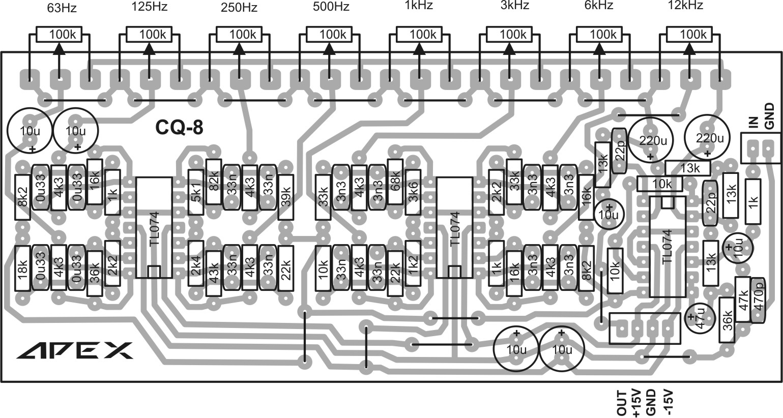

hi
any one have schematic for this Apex EQ ?
It is very usual that Mile does not provide the circuit alongside the PCB layout with components. How about drawing one by yourself?
funciona???Here is my PCB for AX14P and it's work well
hi
i want to use this in small box then i want redesign this with small POT and smd part. apex schematic and designs have good quality and Principle design. i decide use it. in internet we can find many EQ but i used Apex B80 amp and want Apex EQ too because off good quality.
thank you
hello guys is been a long time I just want to share this image I'm trying to make me a new layout of the AX-14 cause I like it so much that I want it make it as artistic as possible this is my draft maybe I still need to tweak it even more do you guys like it ? Note: is not done 100%
