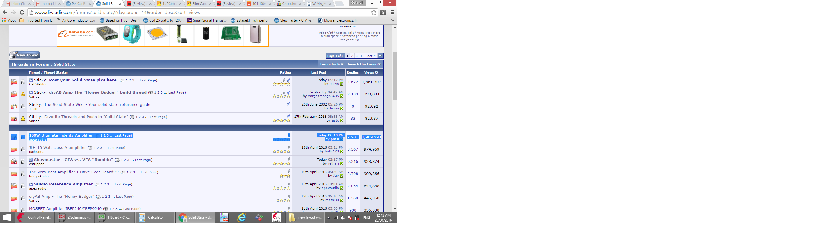

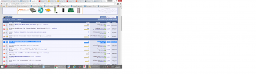

Congratulations Mr. Mile,
You are numbah one:D! in solid state in terms of no. of views. It may be from a long long time, but I just noted , so I though to share for all the fans.
I think this thread is still no. 2 behind John Curl Blowtorch. However, it is the number one thread where people actually build stuff all the time. Apex Audio has the top 4 out of 5 most viewed threads in SS Forum.
Yes, congratulations and thank you for all your contributions!
Yep, this is people's thread, where one gets addicted to amp building. I dont know about John Curl from pre-amp, in Solid State APEX rules,
