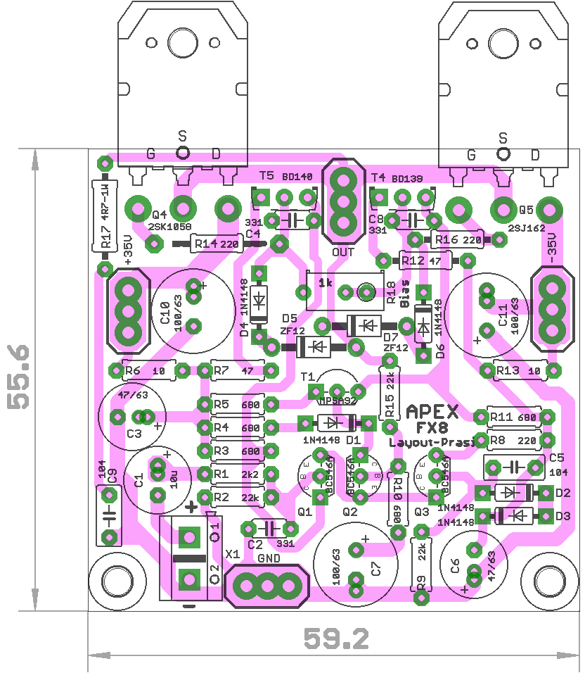

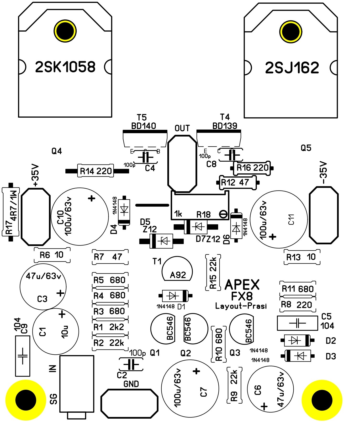

Silkscreen issues:
1) There are two R1's - one should be R17.
2) D1 designation is missing
3) C11 designation is missing
4) There are two R12's. One should be R15.
That's all I found.
Thx,
BF
Pl see attached file as a reference for silk screen designations. Terry slightly modified the layout to improve it. Other than that both have been tested and no issues. BTW I used 300pF caps for C2 C4 C8.
reg
Prasi

Thank you for responding. You are correct. I was posting about Still4given's copy of your layout. I used your layout to confirm what appeared to be minor defects in his.
Speaking of your layout, however, I have a few questions for you, too:
Where did C10 and C11 came from? I don't see them on Mile's original schematic, and haven't been able to spot the correction in the various posts...
Is there something against posting a Bill of Materials for FX8? I have created one, of course, but was surprised to not see one. I don't want to interfere with someone's (Apex Audio?) commercial activities, of course.

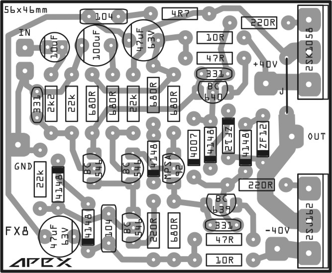

Is Q1 deliberately oriented to face Q2? If not, then wouldn't a 180 deg rotation of Q1 create several simpler routings in that area of the board?

1. Its a good practice generally to locally bypass rails with elco caps, Rod Elliott recommends ( see P3). I did it for Fx-8. Also See Fx 9 schematic, Mr. Mile has incorporated those.Prasi,
Thx,
BF
2. Since this is a simple circuit, one can easily read off the layout and most parts are easily available anyway, so nobody bothers with a BOM. Mr. Mile is generous enough to post his designs for us diyers. Many times he has stated, there is no commercial interest.
3. Q1 /Q2 orientation, Mr.Mile can answer that one.
Facing to each other they can easily be tied up together (to thermally couple them) using cable tie. Sometimes people use a little heat compound between the surfaces. Not a must of course.
But don't be fooled by the words "simpler routing", especially if it doesn't correlate to "proper routing".
To clarify, I also rotated Q1 for better routing (but still touching Q2) and in original Apex' PCB they are not face to face either (see attachment).
reg
Prasi
Hi Prasi,
Where did the 330p come from? I don't see a schematic with those. It is stable with 100p so I'm not sure anything is to be gained by going higher.
Benz,
Good catch. I guess none of us caught it because the values are there. Makes sense that you would catch it when making a BOM. I have a very large supply of parts so I rarely fool with a BOM, especially if it is a small amp like this. I'm attaching an updated silk.
This FX8 has some of the flattest 50hz square waves i have ever seen. There is a tad of overshoot in the higher frequencies. I used 100p per the schematic. Mile's layout seems to use 330p. I don't have those in stock so i stayed with the 100p.

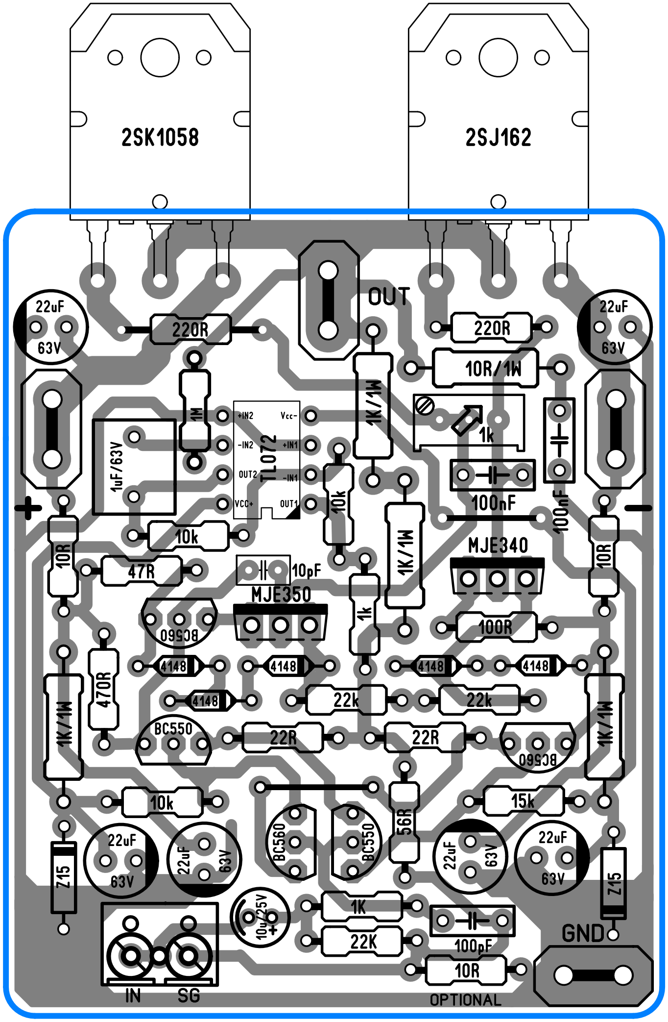

Sprint file for A15.
Also finished layout for FX9 I need to recheck for mistakes.
Nice FX9 pcb.. replace 10k with 15k...
