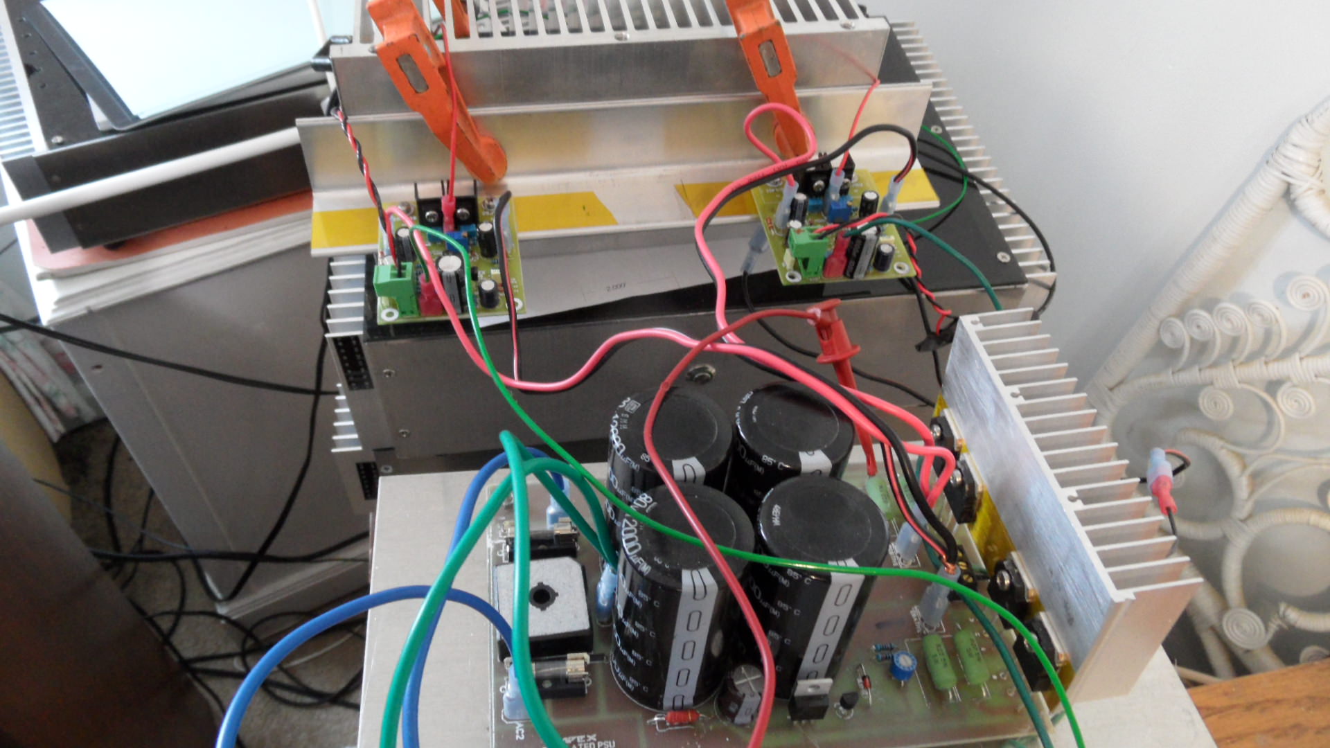

Got my 2 FX8 up and running. They really do sound sweet. Need some more burn in to do honest compare. i used BD139/140-16's as thats all i had at the moment. Bias set at 130mv and dc offset was from -.2 to +.2mv. All very Easy to Build & set up. Running +-36V from Apex PSU.

OK. It's all kinda of rough,but it works.
I would call it clinical.Nice job. Wait till you see mine. guaranteed to be Messy!
Wow...that's some really low voltages. Did you try to match Q1 and Q2 or did you use 2 random transistors?
Where do you measure the bias while adjusting the trimmer?

They run very comfortably with those little heatsinks. Haven't Tried BLASTING For a long time with them yet! I choose to mount the latfets that way for my future heatsink requirements.
Ammel68,
I used a Peak Atlas DCA55 to group them. Not very closely either. hfe +- 5 to 7 between them. Measure bias with dmm in Amp mode on +plus rail

Using Dmm in Amp mode on +Plus rail.
Easy enough...much appreciated.

I was wondering that. They might run cooler on their own sink. The Latfets like to run hot. I don't know if it would be better to keep them cooler. Maybe Mile can chime in and let me know.
Thanks Rick. Where do you measure the bias?
Another (safer ) method would be to put a 0.5-1 W resistor (say 22ohms) in series on each supply rails and measure the voltage drop across each of these resistors. You can then calculate the bias current using ohms law and adjust the pot to have 130mA. use reading on any one rail (say +ve rail).
