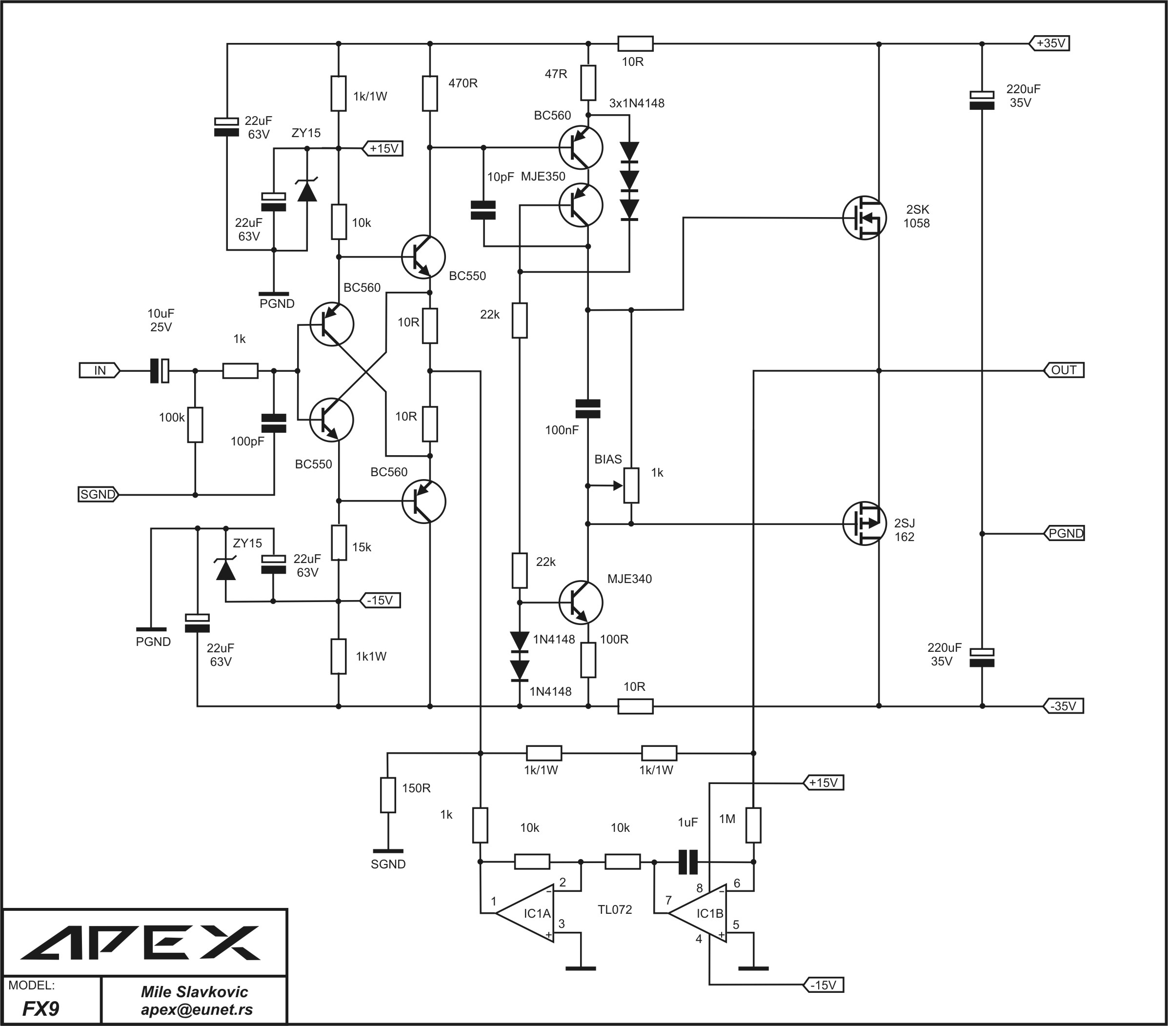

FX8 is my new favorite amp and FX9 is new idea for CFA with laterals.
Hi Mile,
Intersting. Are you going to do a layout? I would build it.
Hi Mile,

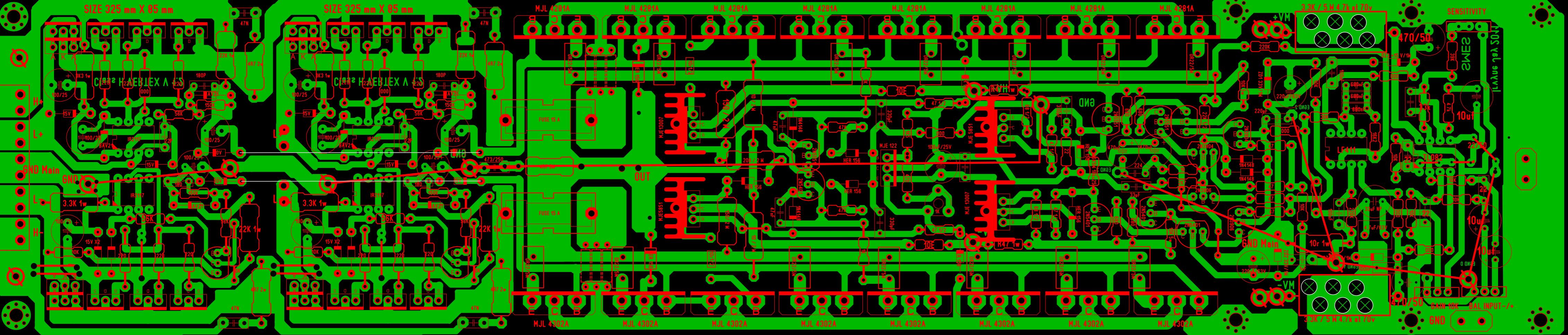

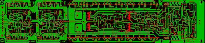

No but there is A15 in post #5972 and sonal kunal made pcb in post #5994.
I missed that one. Too busy trying to get the shuntie working. I may try that one. I would prefer the FX9 though. I love simple circuits. Maybe sonal will get interested enough to do a layout.
