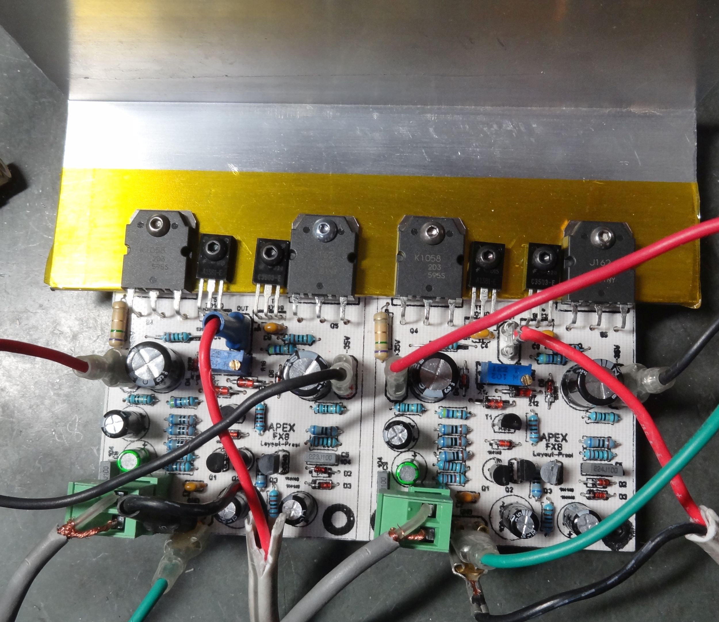

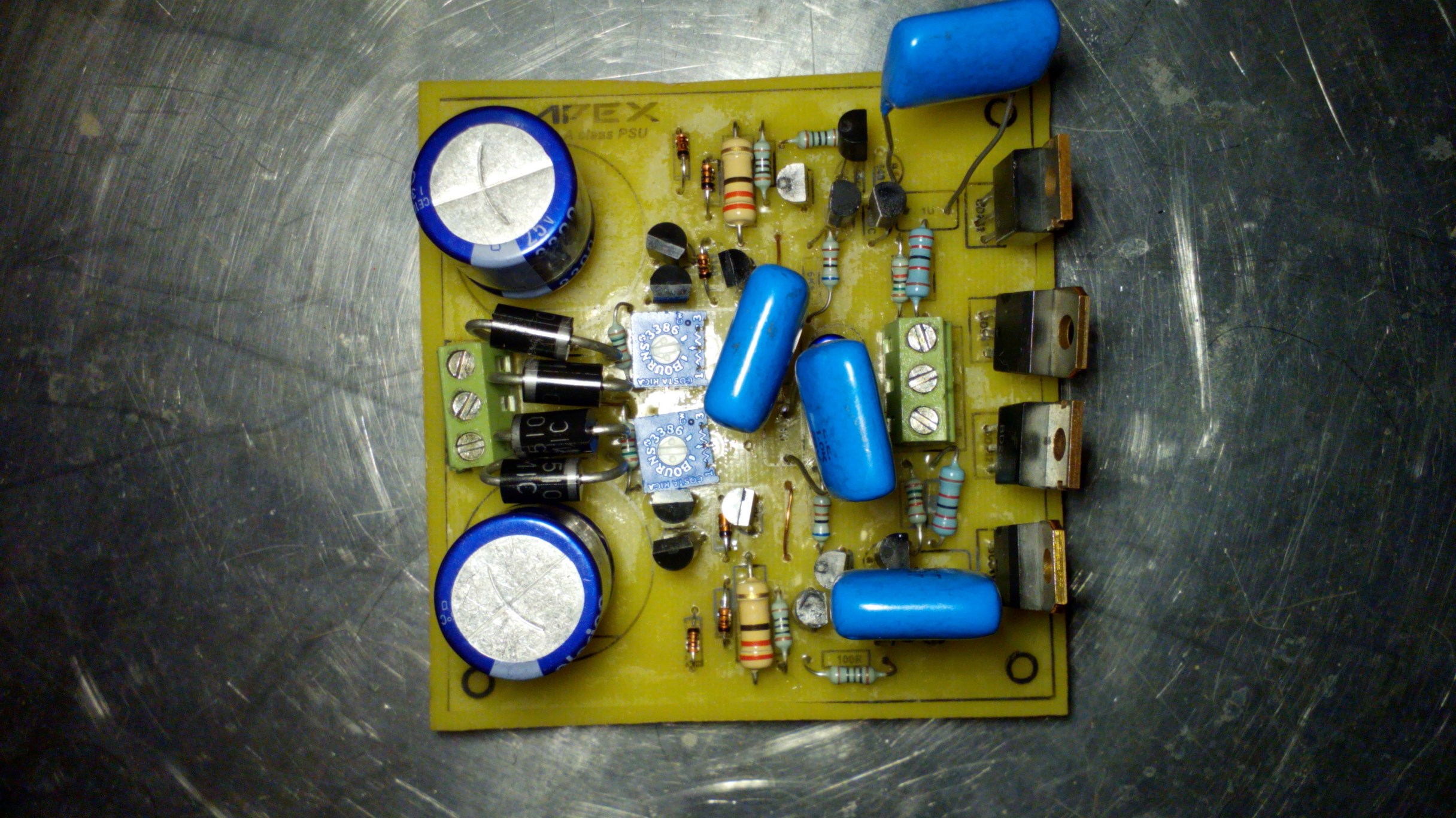

The FX8 is singing. I set the bias to 128mA at the rails. Clipping looks perfect and square waves look nice and square. Sound is lovely as you would expect.
I will hook them up tomorrow and give a listen. I will be surprised if there is any difference in sound. when you get this low in THD they pretty much all sound the same. So far I have only played them through my test speakers. A pair of JBL 4311B. Very good bass response and clear highs. I'm only running them at +-31V right now. I measured 19V AC into 8ohms at clipping. I'll do some better testing tomorrow and take some pics of the scope. So far it is a really nice little amp. I didn't have any BD139's so I used KSC3503E, KSA1381E. No sign of oscillation, very stable.

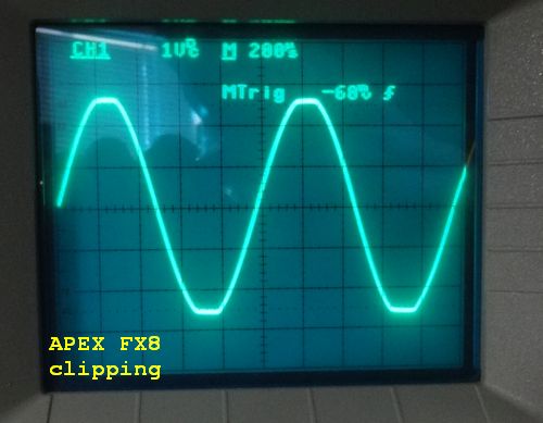

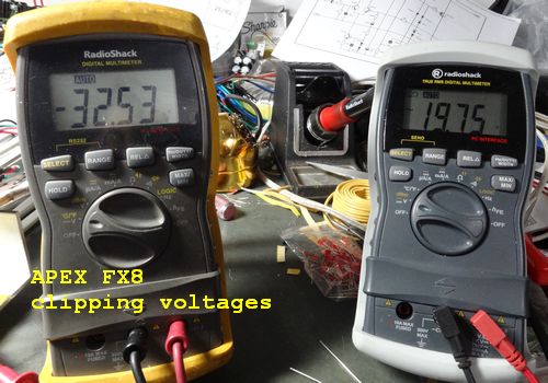

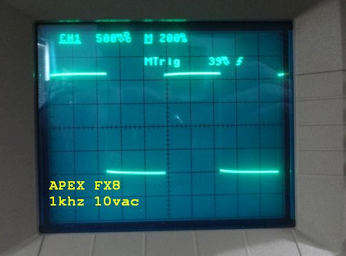

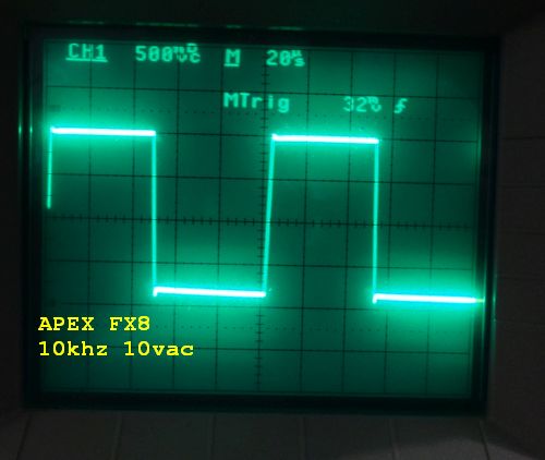

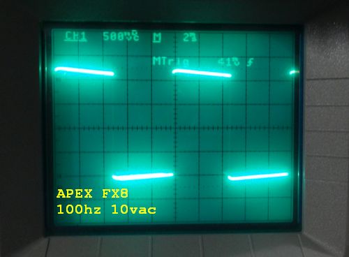

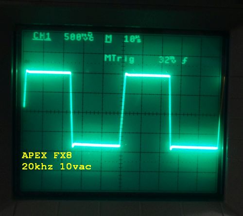

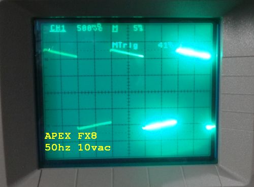

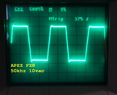

I got a chance to hook it up to my A/B setup. I don't have an AX14 hooked up right now so I compared it to some other amps. Held its own against the Honey Badger, DX MKIII, and a Peeceebee. To answer Thimios' question, the bass is very good. Strong and solid. These little Latfets never cease to amaze me. Attached are some scope shots. Forgive the lighting.
The voltages shown are at clipping. Negative rail on the left and AC RMS output on the right. This into 8ohm resistive load.
Blessings, Terry

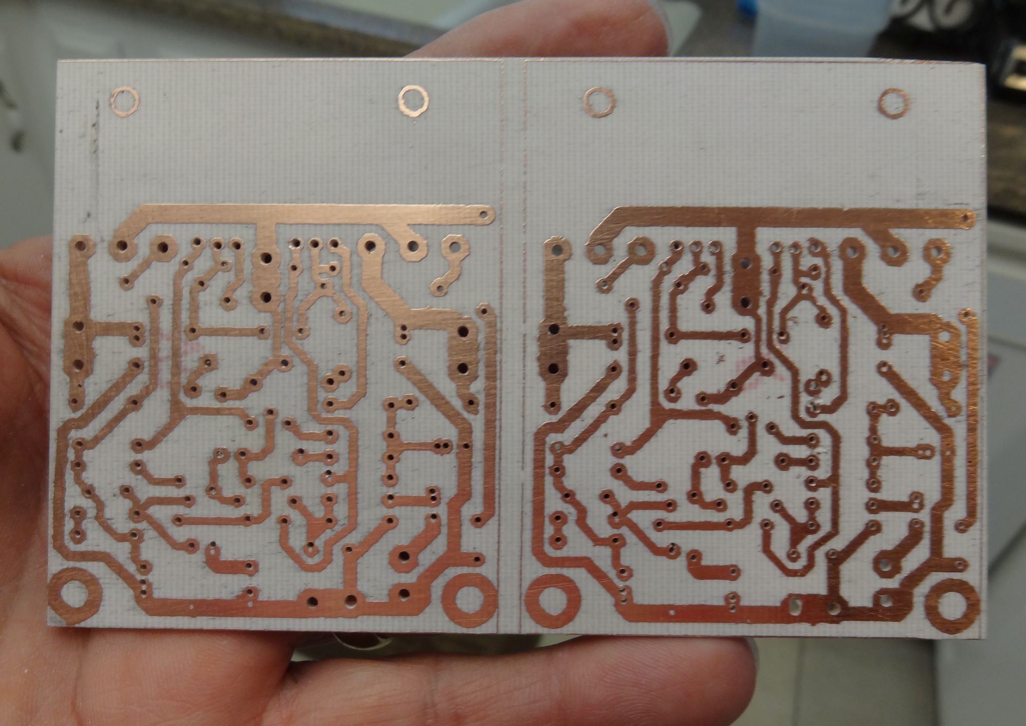

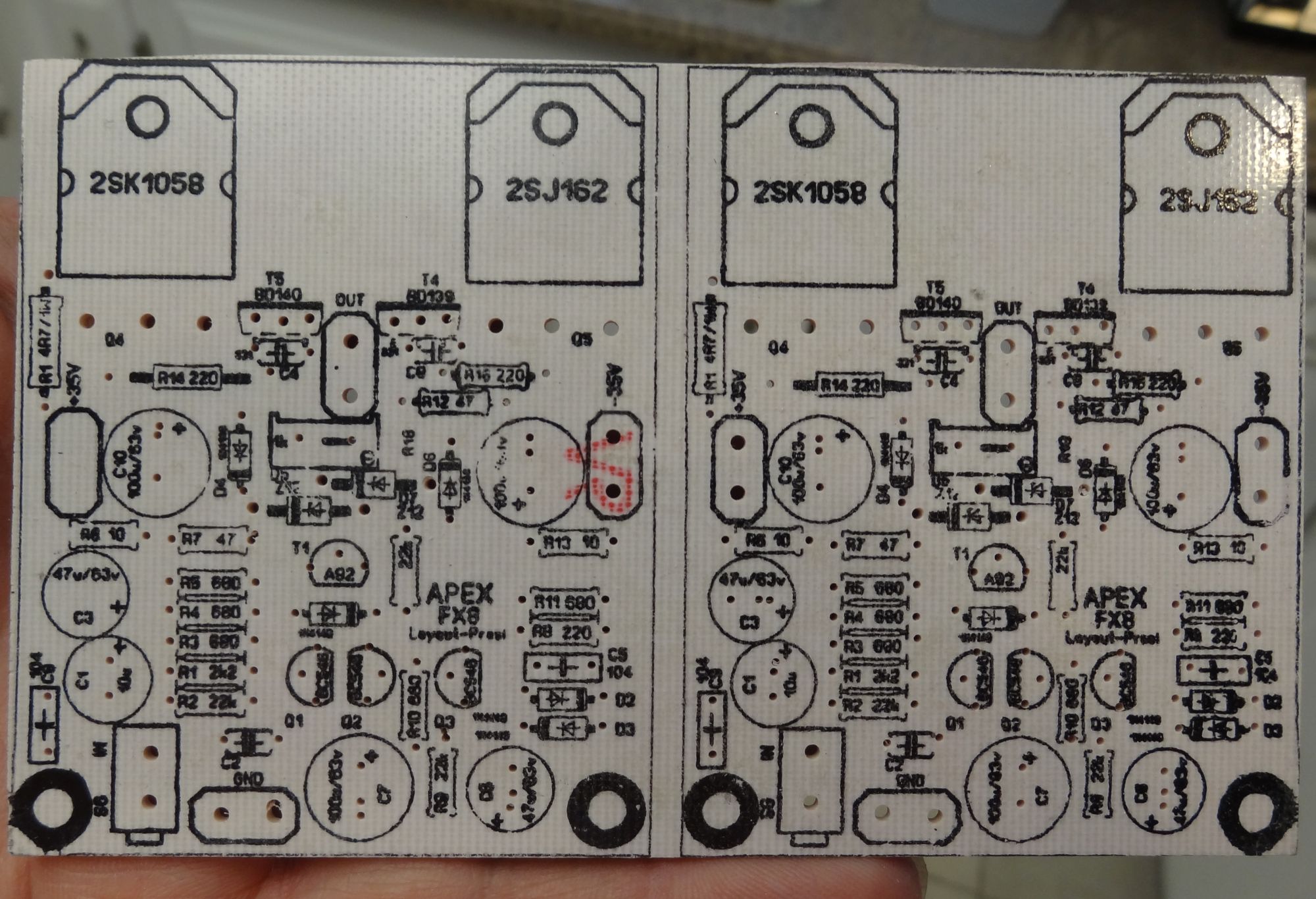

Very nice! Thank you for sharing your Sprint file.

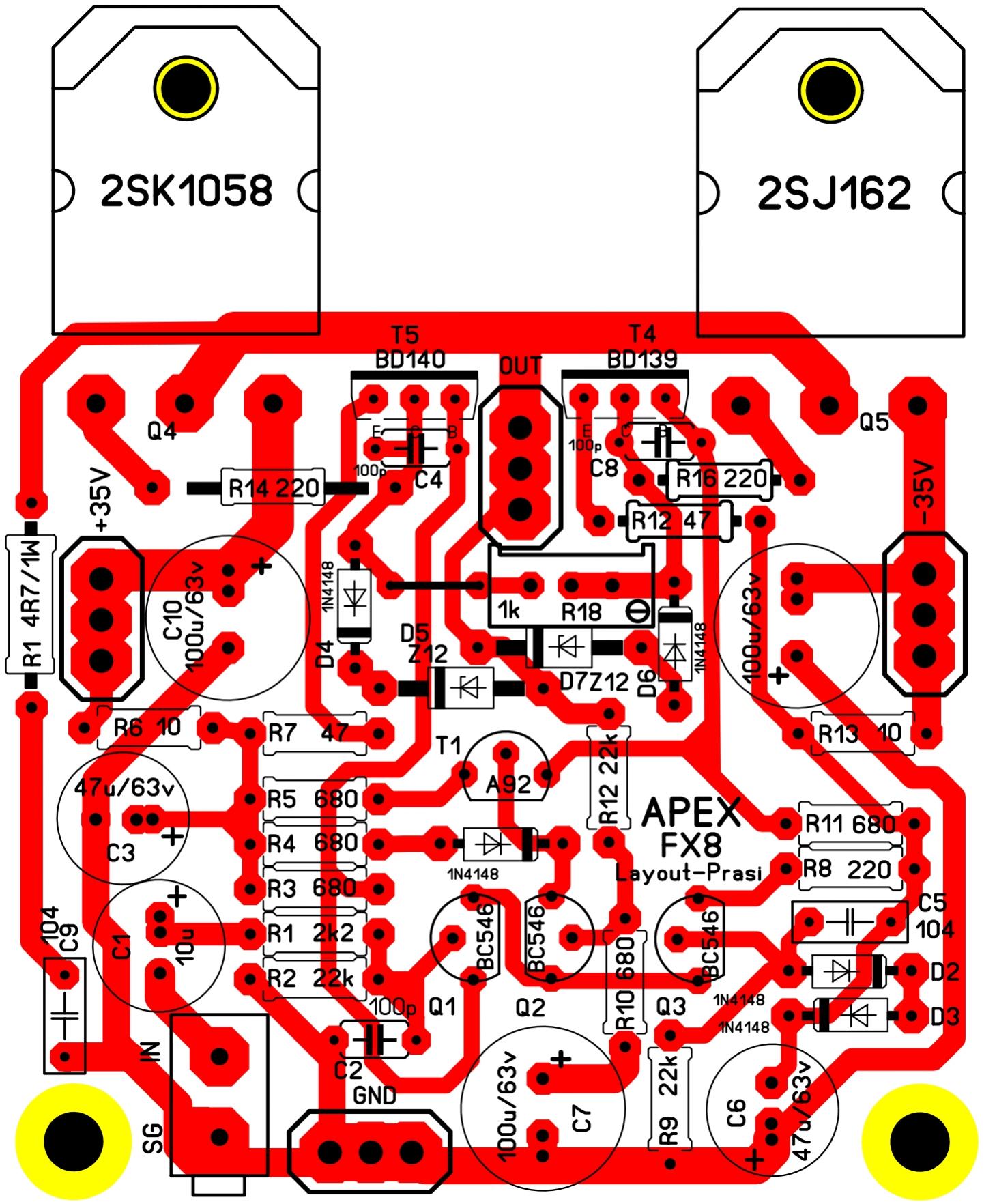

Do you plan on doing a Sprint PCB for the FX8 like Terry shows in post 6202?
Here is my Sprint file. It has slight changes to the one I posted. I just moved things a little to improve it.
EDIT; BTW the trimmer ends up about 200R so a 500R trimmer would probably be better.
  • Apex FX8 Prasi clone.zip
Thank you for the comparisons and scope shots.
What transformer and power supply are you using?
Do the Latfets need to be matched?
Right now I am just using a small test PSU. 160VA 30-0-30vac and using a variac to set the rails. They sag quite a bit when testing to clipping. I have the rails set to +-36V and as you can see it sags to almost +-32V at full clip. However, during even loud listening it barely drops at all. If I built this into a complete amp I would of course us a stiffer supply.
There is only one pair of Latfets so no matching is required. I did hFE match the input pair. I have <14mV offset on both channels.

Nice work... replace C7 with 1000uF/16V instead 100uF/63V to improve 50hz square.
Regards
