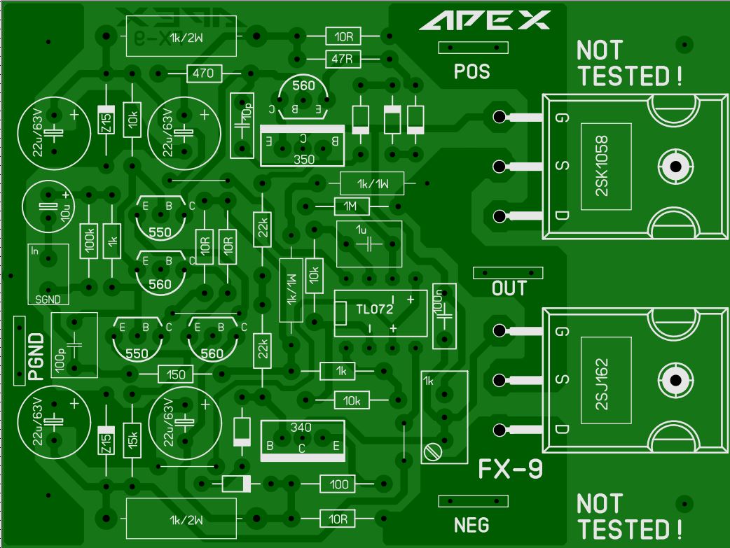

Hi, this is a first draft for the FX9. Some jumpers more than desired. The layout also still needs to be doublechecked. Unfortunately, I have not yet all components, so I have to order first and may test next week.
regards Olaf
Nice pcb... gate resistors must be add...

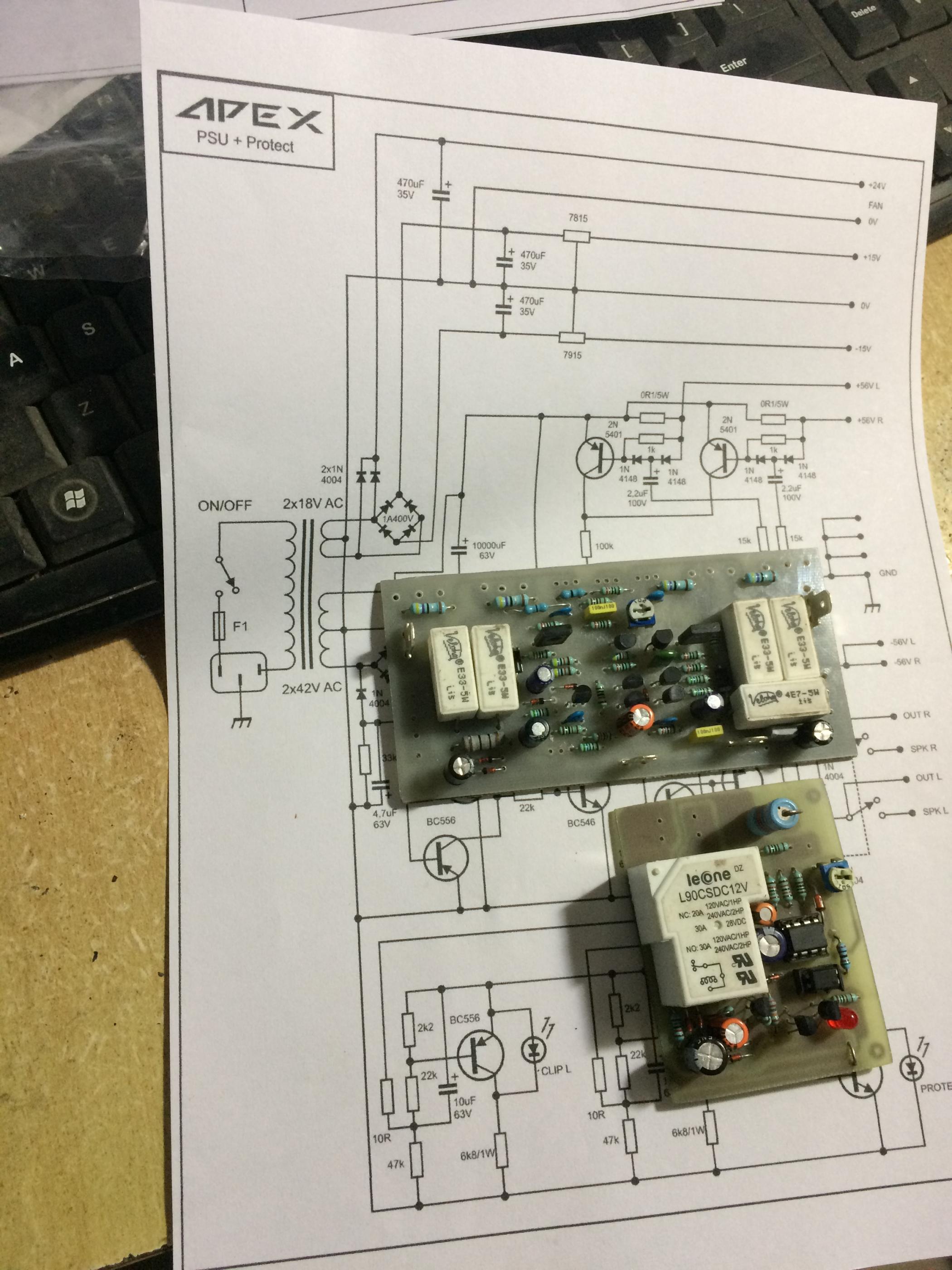

Hello apexaudio
greetings this is the second channel AX14 first one is working
this is the second channel still in progress my transformer is
40 0 40 AC can the FX 100 power supply be used with it mainly
i want to use the fx100 power supply for clip and overcurrent
protection

FX100 PSU can be use with any amp up to 200W.

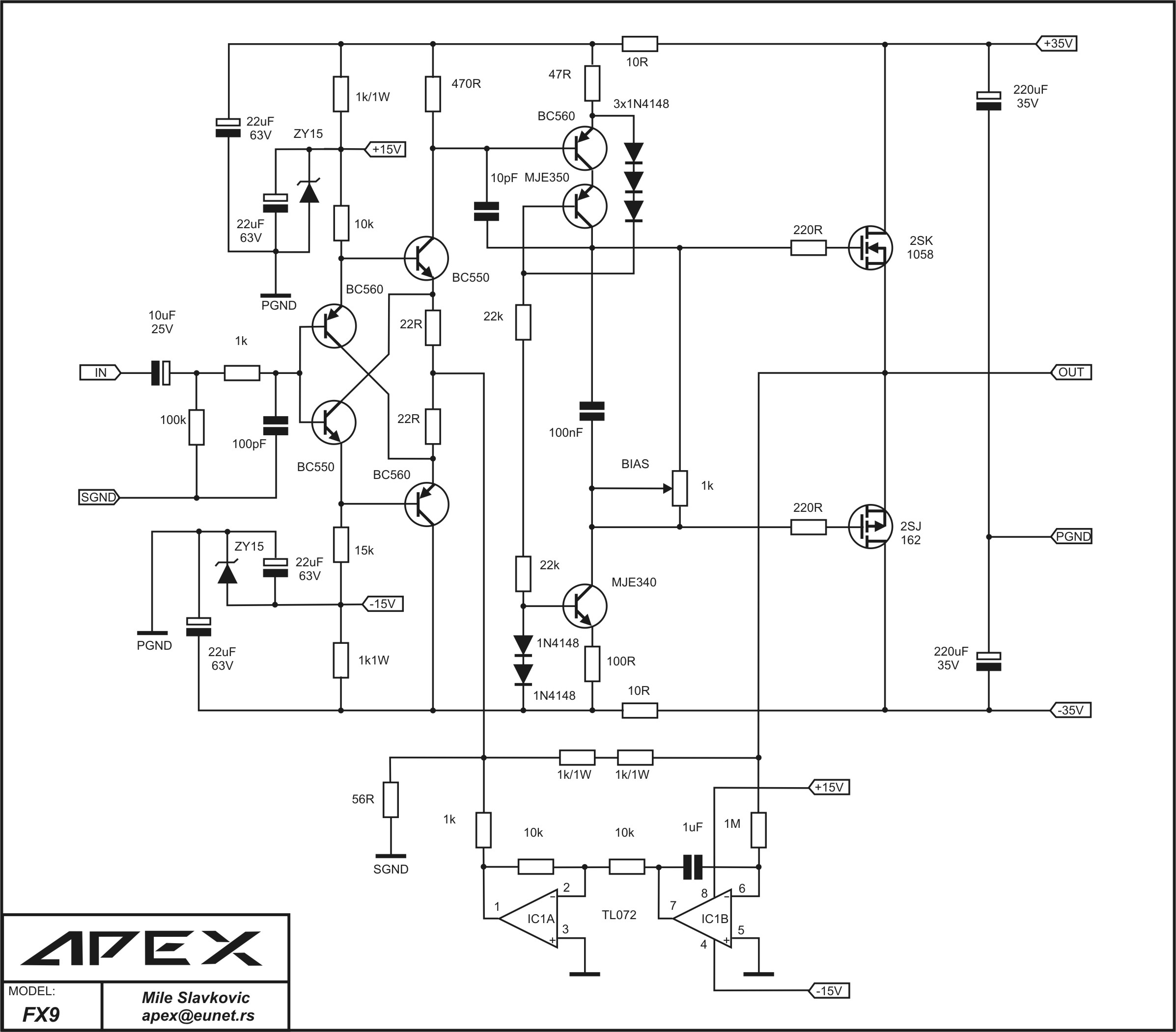

In the FX9 schematic the 10k resistor above the diamond should have 15k as the bottom one (IMHO). I used to putt a 4x diode clamp between the gates just in case the pot will fail.
The too big DC offset (if outside the DC servo range) can be compensated a bit with the 470r resistor just by the cascode (in my case 680r looks fine).

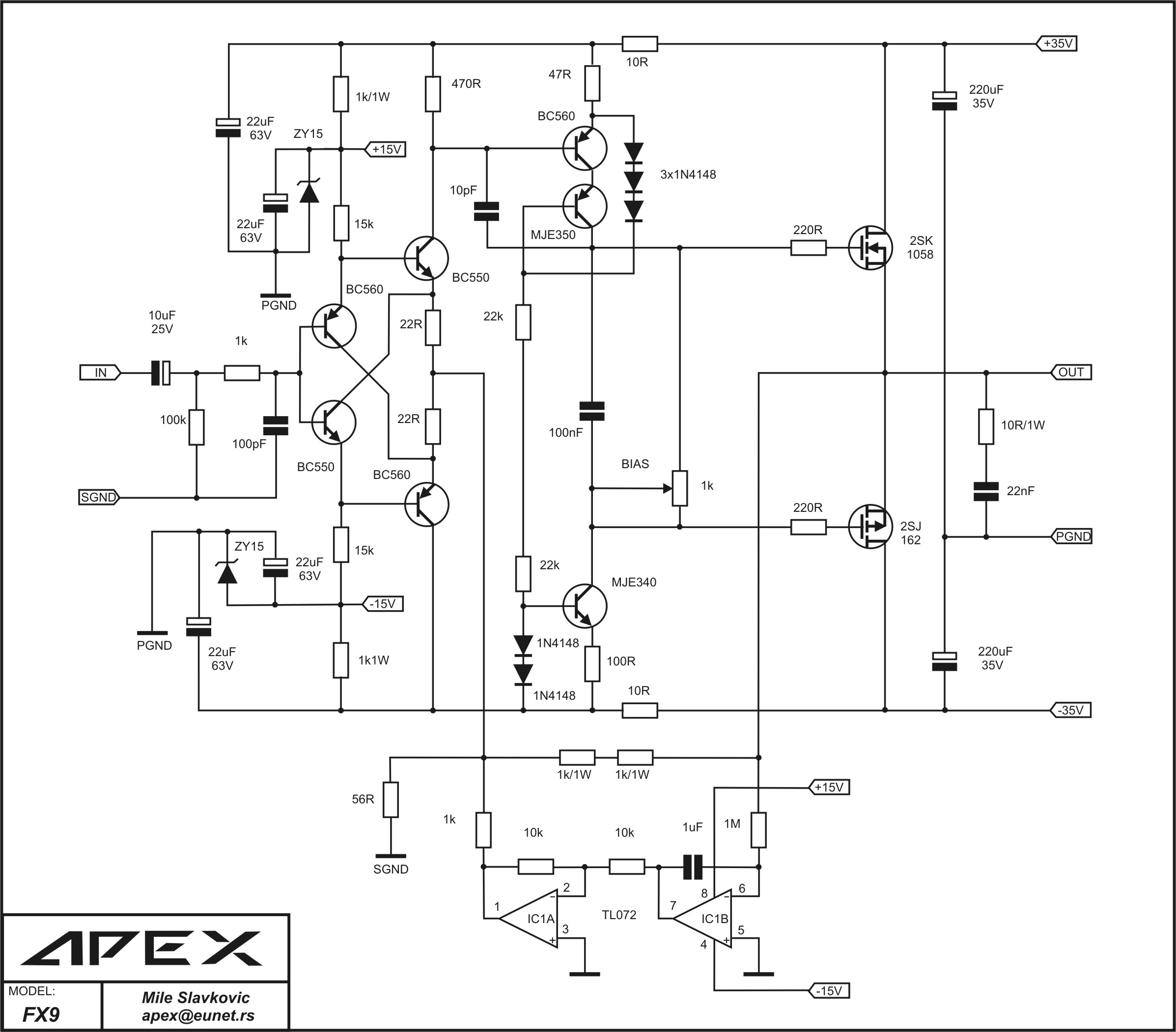

FX9 schematic for play and simulation with sony cfa topology.
I'm missing something?
What modification?
I tough I was modified AX16, but AX16 is AX14 with protection. It tested by Still4given.
I sim it, it have a dominant H2 distortion, because of using single ended VAS.
I think DC servo is much simple if the output connected to the amplifier's input.
Questions about this layout
This is my first post, so go easy on me.
Silkscreen issues:
1) There are two R1's - one should be R17.
2) D1 designation is missing
3) C11 designation is missing
4) There are two R12's. One should be R15.
That's all I found.
Thx,
BF
Here you go. BTW, I used Prasi's layout for my template. I want to give him the credit.
