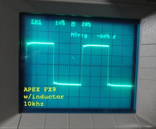

Very nice, you are too quick (I am still testing FX8). How does the sound compare to FX-8? If possible, Could you see if an o/p inductor will remove the overshoot as suggested by Mr. Mile .

It helps some but doesn't eliminate it. Here's a scope shot. Sound is great. Once I get both channels hooked up I will try to A/B it against the FX8. Likely they will be similar in sound. This one has really solid bass as well.

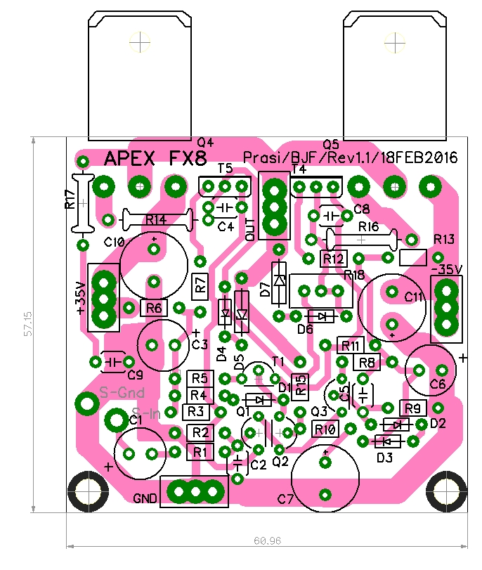

Nice layout, but would like to suggest a couple of things (which i learnt from members here).
1. c4 c8 should be as close to the B-C pins as possible.
2. a good practice is to keep the trace connecting r15, r10 and q2 as short as possible. it may still be ok with your layout , i really dont know what length a trace is ok.
3. if u are going to do iron transfer, keep sufficient clearance. i really dont know how much as it depends a lot on skill, paper used, printer, etc,etc. I used photoresist method and 20-24mils is plenty for that.
4.trace connecting G of LMOS neednt be that thick, but doesnt hurt, if there are no restrictions.
5. i didnt check actual connections as i hope u made sure that sch and layout are compatible.
6. ah, another, try to keep as much clearance as possible between rails and ground (specially for high voltage).
Thank you very much!
1. C4 and C8 closer.... I was wondering why R14 and R16 weren't the closest things from a layout perspective.
2. I may have painted myself in a corner with my "innovations" for the R15/R10/Q2 signal. I'll see if I can make it shorter, but it somehow has to reach "Out" on the far side of R15. My version looks like it's several times longer than your's.
3. Clearances - I wasn't sure. I've always used fab houses in the past, but want to try my hand at making PCBs, so I didn't know clearances of DIY. I had the DRC set to the defaults at first (6mil), but in the end reset them to 13mil. Just set to 20. Wow. A lot of adjustments to make.... I'm using 1mm track width. I thought that was what I measured on your's. Is that correct?
4. "G doesn't need to be wide" - I should have figured that out.
5. Thanks, but I didn't expect that - what I really wanted it EXACTLY what you gave me.
6. Do you have a number for Power rails and GND spacing? Some places they have to approach one another as in C11, so should those tracks be narrower?
In general, as you can see, I used a lot of real estate with the wider tracks, whose default routing width I set to 150mils. Does that help any?
You see that for the IN signal and the other side of C1, I surrounded them with GND, and kept them very short. Other side of R1, also short, but could be better, getting in to Q1.
I kept most of the lugs at the edge of the board. Am thinking I might want to use 90 degree for less stress on the pads.
Lastly, if I may ask, input signal connector do you use? You appear to be very deliberate about it because it certainly uses a bit of real estate.
Sorry about all the noob questions. VERY new hobby. Just bought an o-scope and DMM. Haven't even fired them up except to confirm that they work.
Thx,
BF

OK I had chance to do some more testing. A couple things of note. I used SMD caps for the 10p, 100p and 100n caps on the IC. They are not shown in the pic above. The scope shots were taken with an 8ohm resistive load and the output set to 15vac at 50hz. It clips a little funny

Pl find ans in red (quite a long list, on my "to-do-list" since morning.
1. C4 and C8 closer.... I was wondering why R14 and R16 weren't the closest things from a layout perspective. if you see my layout R14 and 16 are already close to G.
2. I may have painted myself in a corner with my "innovations" for the R15/R10/Q2 signal. I'll see if I can make it shorter, but it somehow has to reach "Out" on the far side of R15. My version looks like it's several times longer than your's.dont try too hard, they are already close due to small pcb size.
3. Clearances - I wasn't sure. I've always used fab houses in the past, but want to try my hand at making PCBs, so I didn't know clearances of DIY. I had the DRC set to the defaults at first (6mil), but in the end reset them to 13mil. Just set to 20. Wow. A lot of adjustments to make.... I'm using 1mm track width. I thought that was what I measured on your's. Is that correct?yes 1mm. if you use photoresist method, 20 mils is more than ample
4. "G doesn't need to be wide" - I should have figured that out.ok
5. Thanks, but I didn't expect that - what I really wanted it EXACTLY what you gave me.I meant, "make sure each trace leads to where it should as per the posted layout."
6. Do you have a number for Power rails and GND spacing? Some places they have to approach one another as in C11, so should those tracks be narrower?just pass thro the middle of R6, C3, for example, and you will have done fine. i had kept 1.5-1.6mm ,
In general, as you can see, I used a lot of real estate with the wider tracks, whose default routing width I set to 150mils. Does that help any?i dont think it does. since its a low power amp, 2.54mm is more than enough for rails and o/p.
You see that for the IN signal and the other side of C1, I surrounded them with GND, and kept them very short. Other side of R1, also short, but could be better, getting in to Q1. its fine, no issues. short trace=good, long trace=bad
I kept most of the lugs at the edge of the board. Am thinking I might want to use 90 degree for less stress on the pads.ok. its just fine as it is.
Lastly, if I may ask, input signal connector do you use? You appear to be very deliberate about it because it certainly uses a bit of real estate.its what i had, u can use whatever you have
Sorry about all the noob questions. VERY new hobby. Just bought an o-scope and DMM. Haven't even fired them up except to confirm that they work. if u are able to measure, do post your findings, will be interesting.
Thx,
BF
Oh I see you already posted. nicely done. You may move Q5 towards the edge a little, so that T4 and output connector have a little breathing space. what I found when doing DIY during actual building 0.5mm clearance that looked more than enough on the layout, doesnt amount to anything when trying mount transistors on heatsinks.BF Rev 1.1, per Mr. Prasi's suggestions, I hope.
R16 needn't be that big, its a 1/4th W resistor. Use 10-12mm lead spacing package, that will make the trace connecting G shorter.
