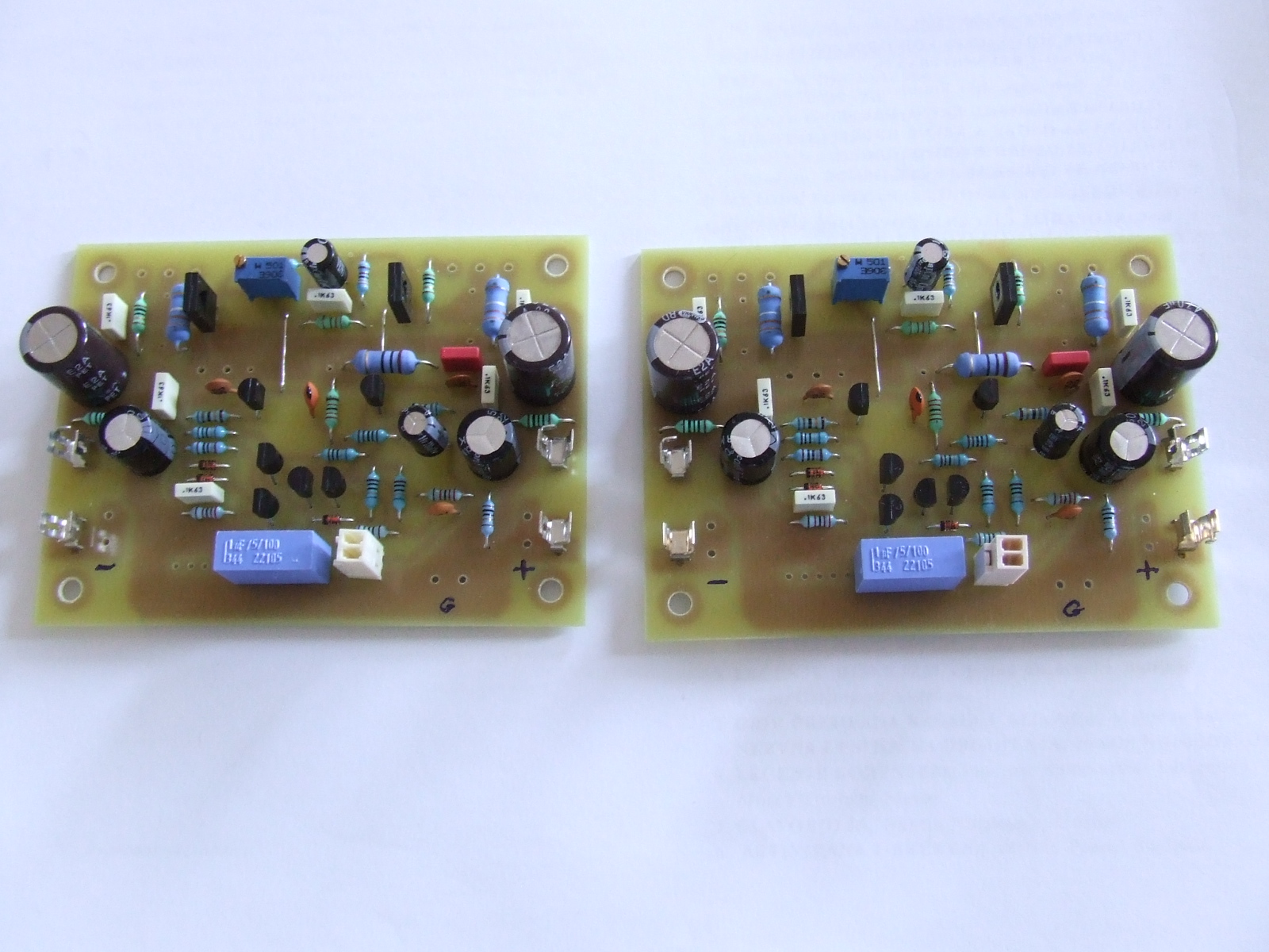

Bimo's De Luxe version of AX11
I changed the values of few components. PCB design is original Anistardi's. This is the best version of AX11. Highly recommended!

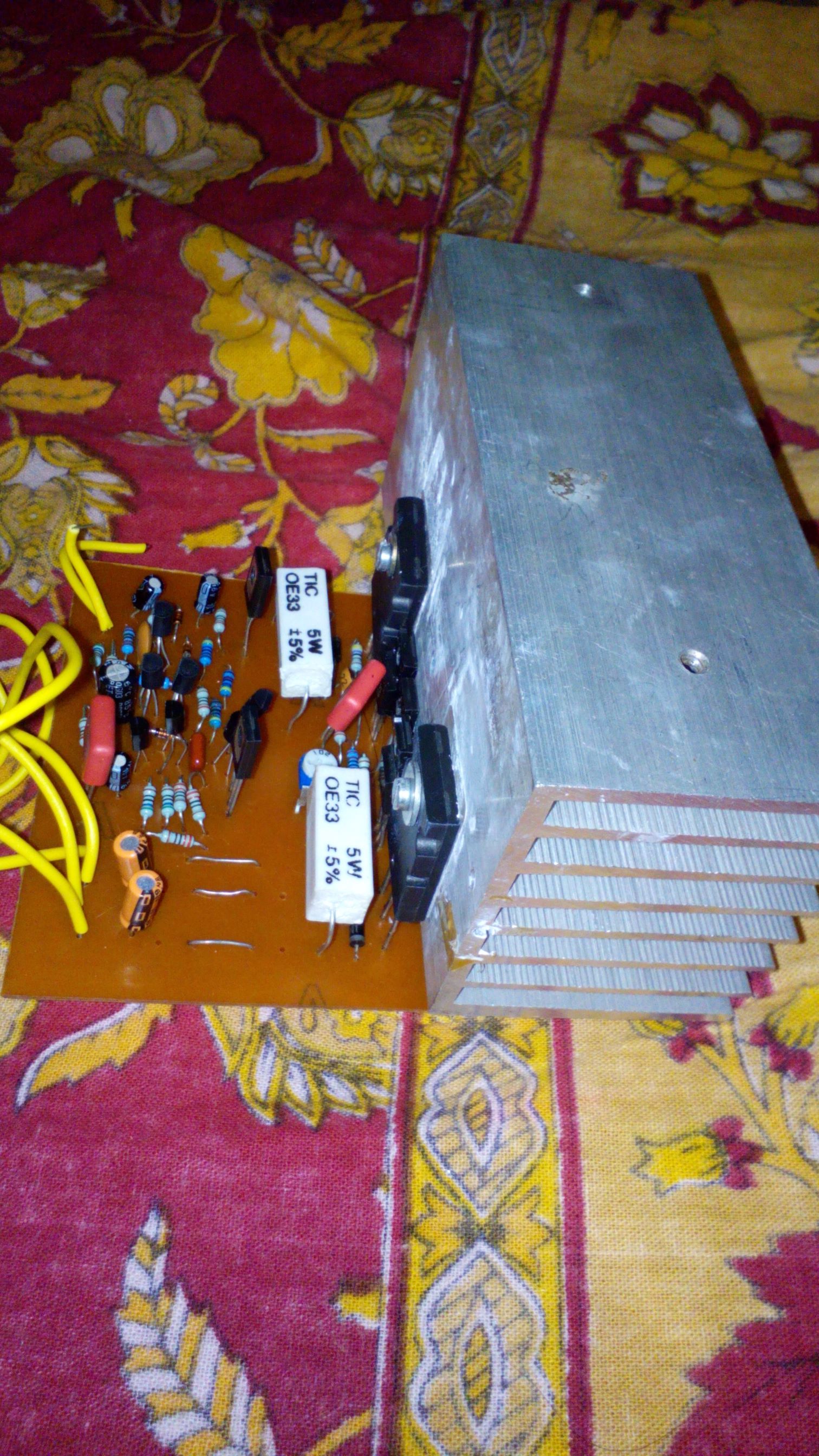

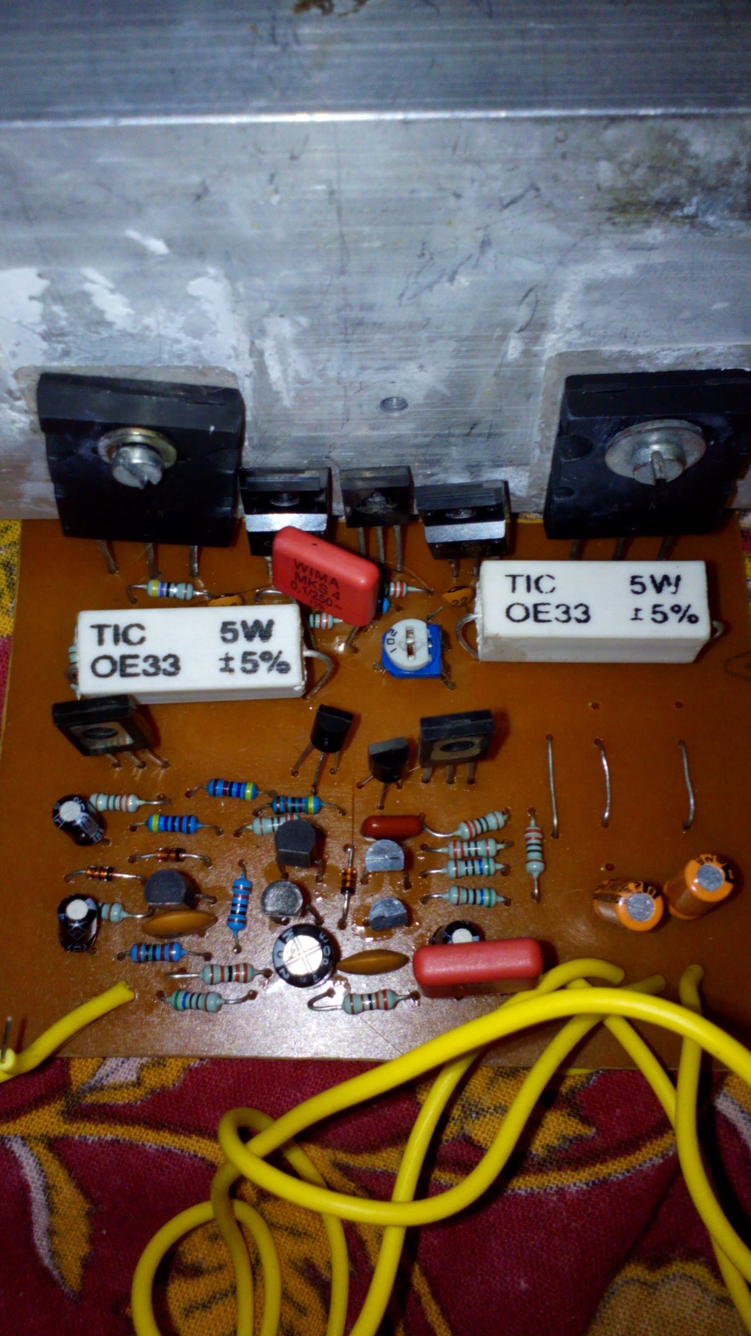

Thanks Sir for replying. Now it is give around 20mV
But there is a sound problem it cannot play anything clear i also tried adjusting the bias still the same
please what could be the problem please see image?

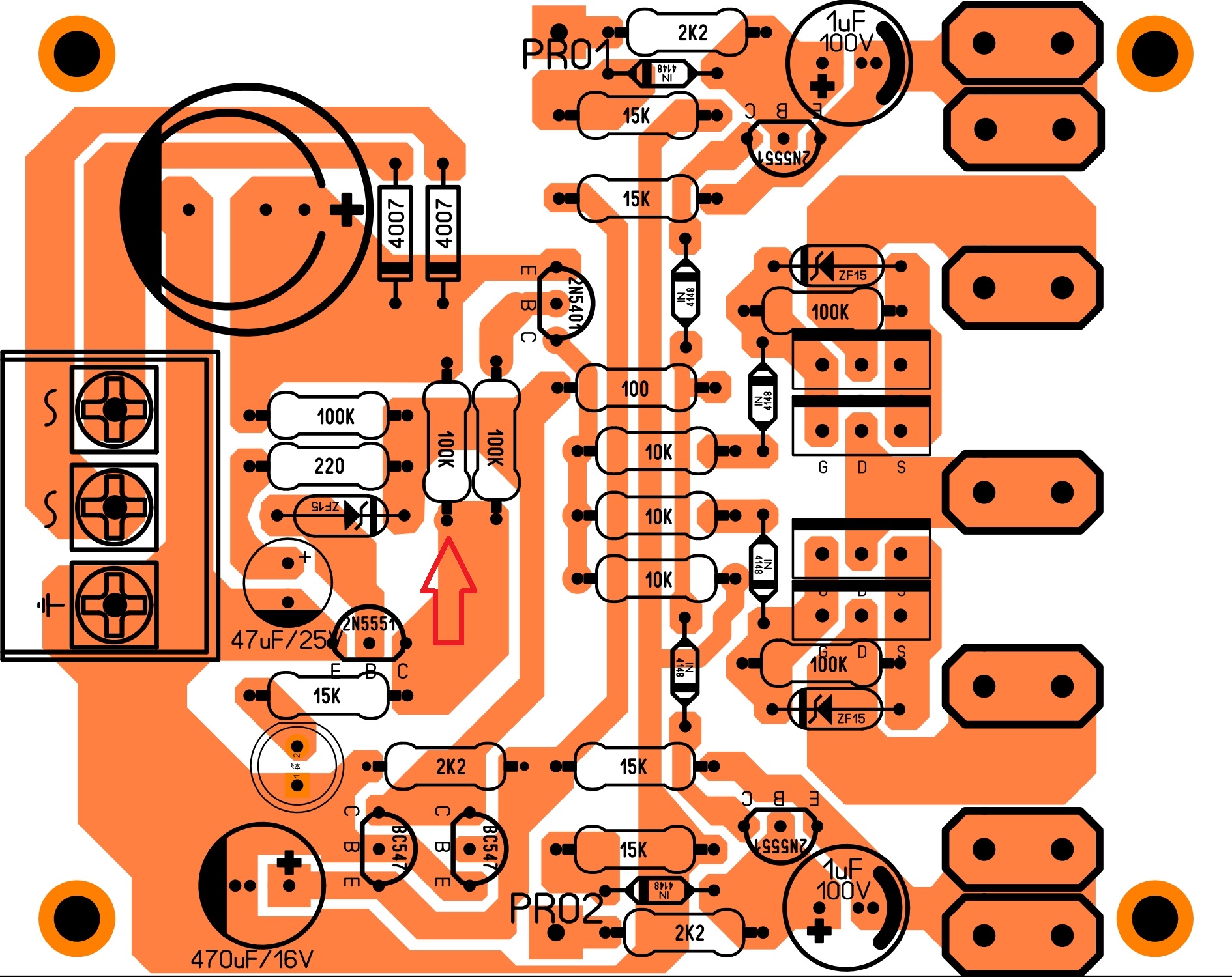

Oh, i see now i skipped 100K resistor from 5551 colector to +, sorry about that

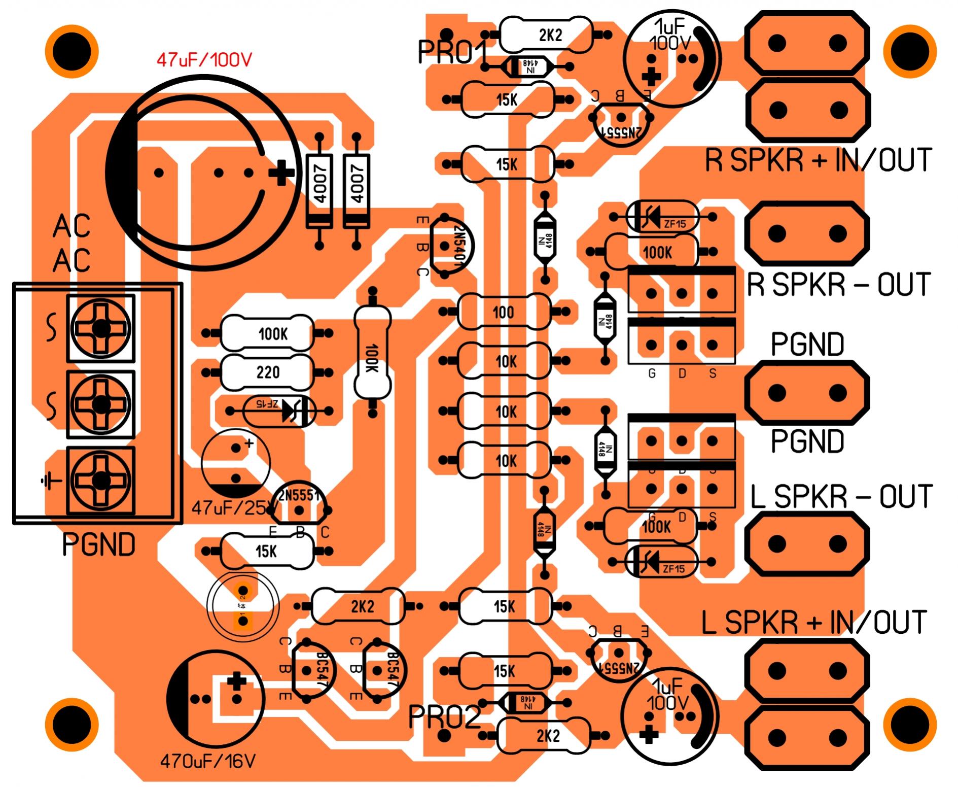

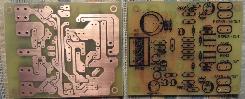

I etched a couple boards per your sprint file. After completing them I decided to add some text to note the use of the terminals for clarity later. Alignment is not perfect because I added it after the fact. I also added a little copper at the ground trace at the bottom. It was very thin where it passed the "Pro" connection. I will try to populate them today if I have time.
Blessings, Terry

After etching I noticed a missing resistor. I added it to the sprint file and will just fit it in on the pcb I already etched. Let me know if I am right about this.
Thanks, Terry
