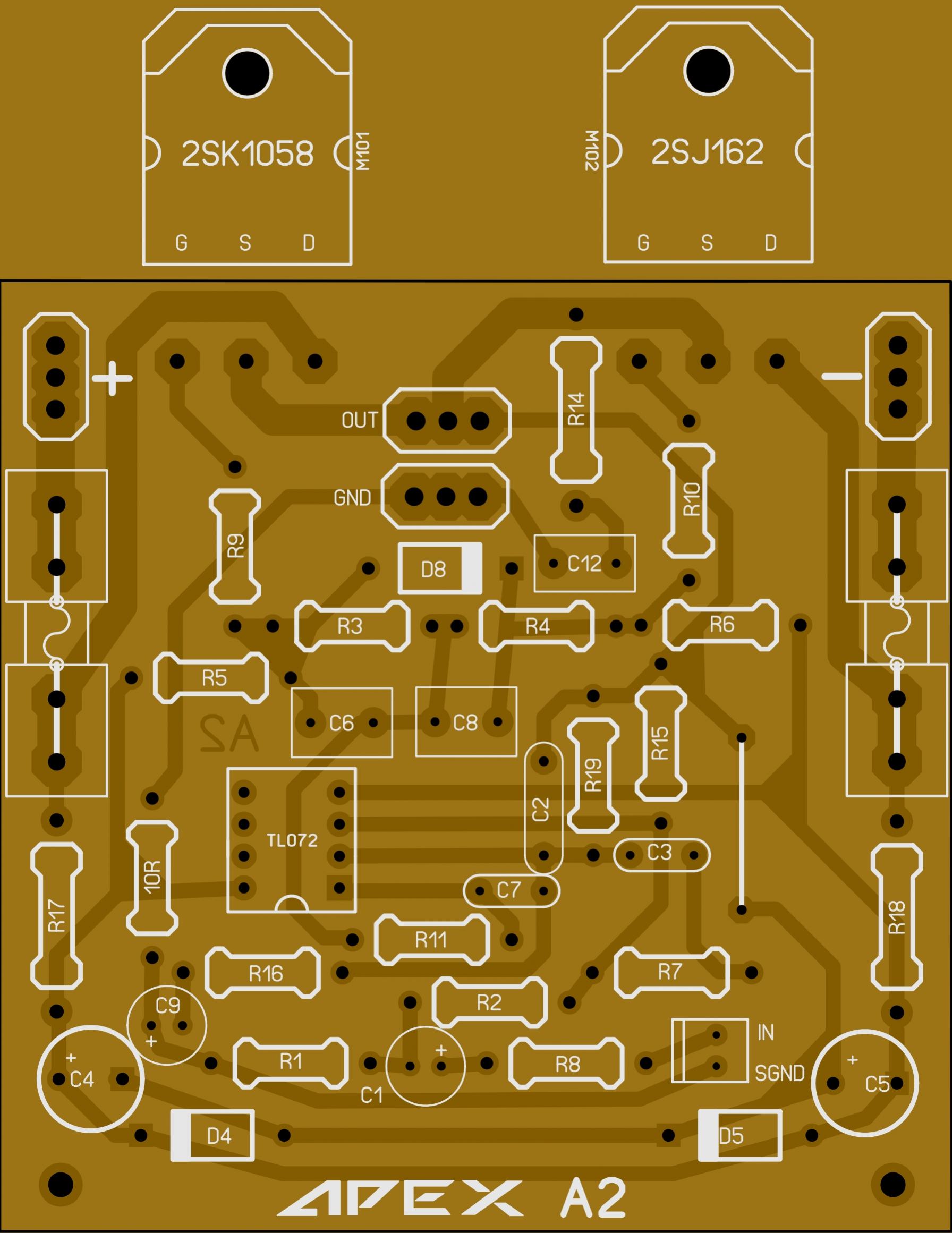

I have been playing around trying to learn how to do layouts. Please take a look and see if this will work for the A2. I designed it for the TL072.
Thanks, Terry

Terry that look good man only just make the annular ring outer diameter a bit larger if you can try 2.5 mm if possible, the hole inner diameter about 0.70 mm see image example

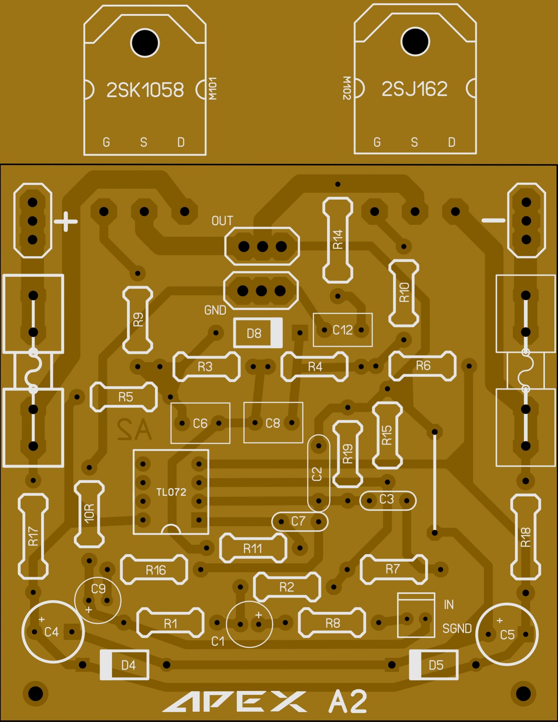

Done.

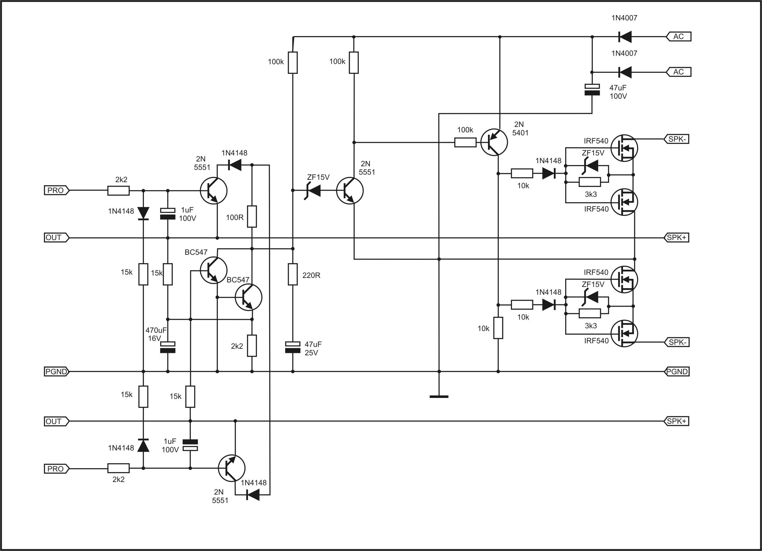

Stereo protect with solid state relays.

If it is so,make a pcb for this amplifier protection
Do any of the transistors need a heatsink? Also, what is the ac voltage?

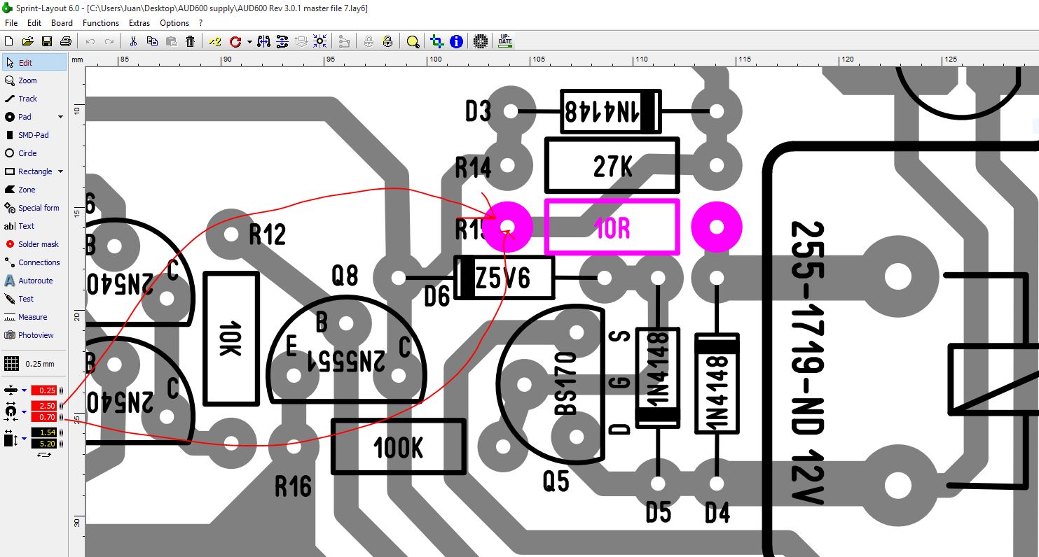

If you flip R11 by 90 degrees and shuffle the tracks a bit you'll be able to remove the wire link.

Terry, The layout has issues. Whilst I probably won't make one, what grabbed my attention are several long parallel tracks. I hate them for a number of reasons.
But you have the two zener diodes D4 & D5 shorting out each other.

Thanks for looking it over. I see the short and will fix it. I can probably slide the IC to the right some and shorten the parallel traces. I don't see how rotating R11 will remove the wire link.
Which resistor are you talking about? Part number please?The -IN is sensitive to pick up.
Keep it's resistor very close to the -IN pin.
Thanks, Terry
