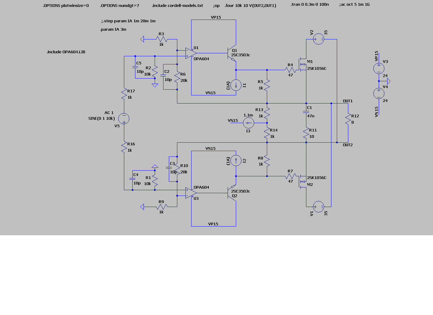

Why not a Circlotron ?
http://www.diyaudio.com/forums/atta...0949d1440743480-vssa-circlotron-opacirclo.asc

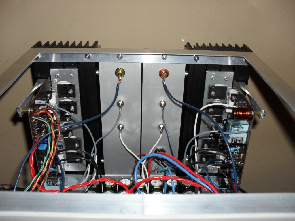

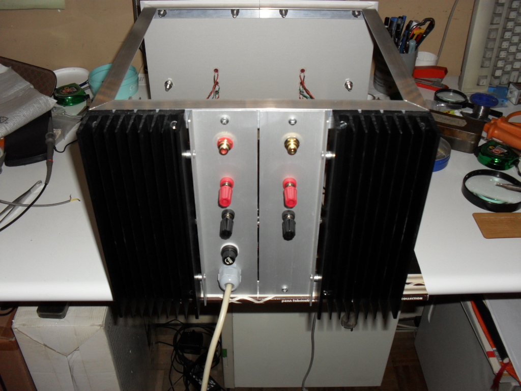

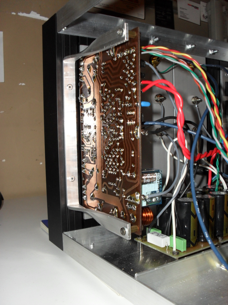

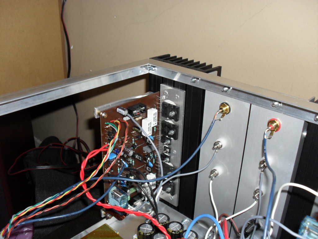

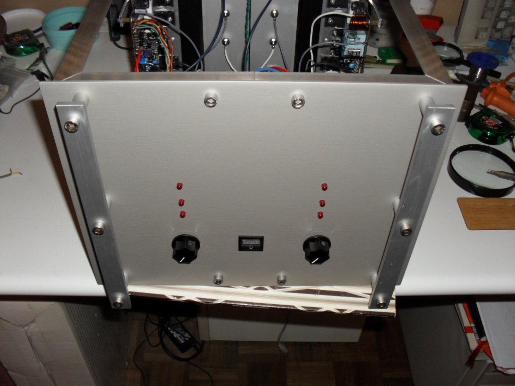

Hi Mister Mile! I finished your (mine) AX20 with 555 protect. I took a lot of time, but I did it finally... and sounds good, thanks for your support.

Nice work,

Just a short question: How do you open the .asc files. ????
Tried to save in pdf and could not open.
Thanks for the help,
Myles
It is much like a .TXT file.
If you rename it to .TXT, WordPad, for instance, will open it (see attachment).
And it will look like this (parts removed):
