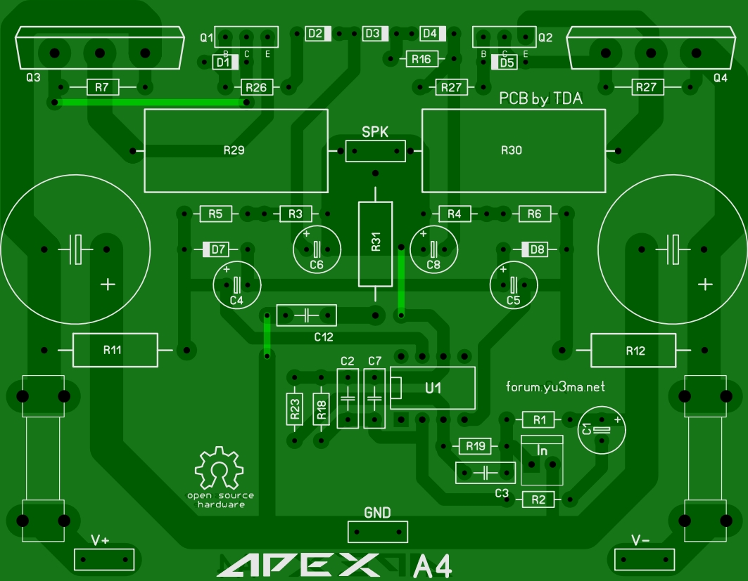

Terry,
Thank You. Problem was with the 330p cap. Reflowed & now is working. Still have -40mv on output. 35mV across the emitter resistors. Total input power is 174ma idle. How do i adj. the -40ma on output
Rick
Hi Rick,
Yes with what Ivan said. This amp doesn't have an adjustment for offset. You might get it close by a closer match of the BC546 transistors but 40mV will not hurt anything.

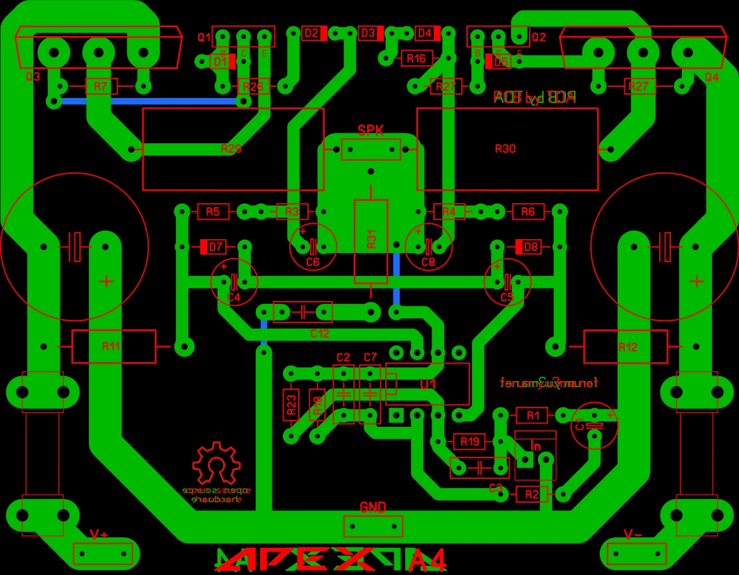

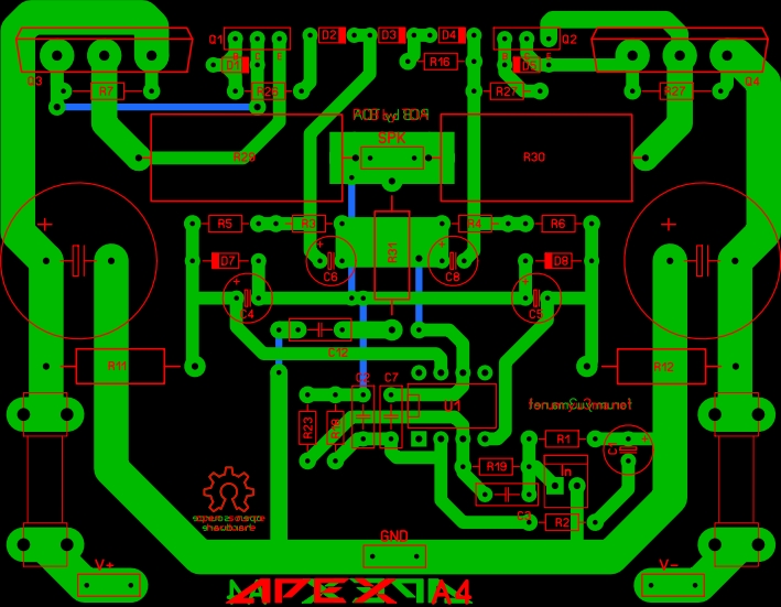

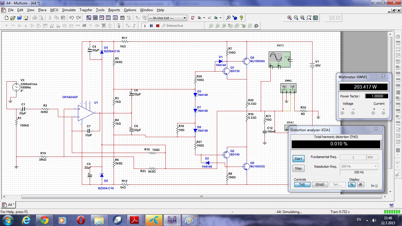

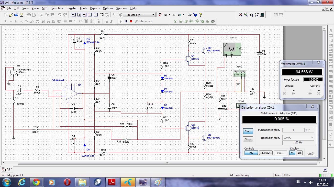

A4 idea...

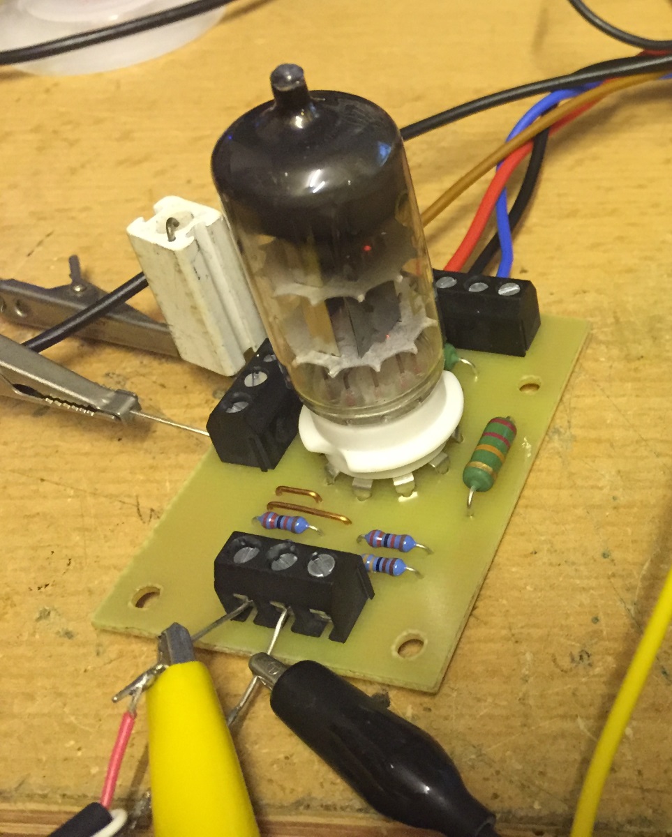

VX120 with tube
Hi, here is the next step with the VX120:
I have the tube module connected with a ECC82 to the amplifier. With shorted input I measure over the 22k resistor 53 volts, which means it flow 2.4mA. That's not much.

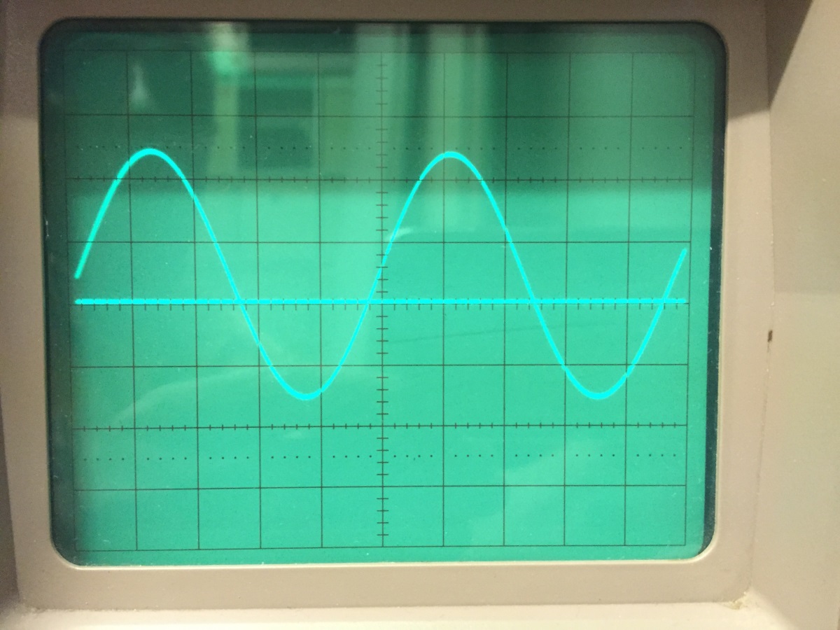

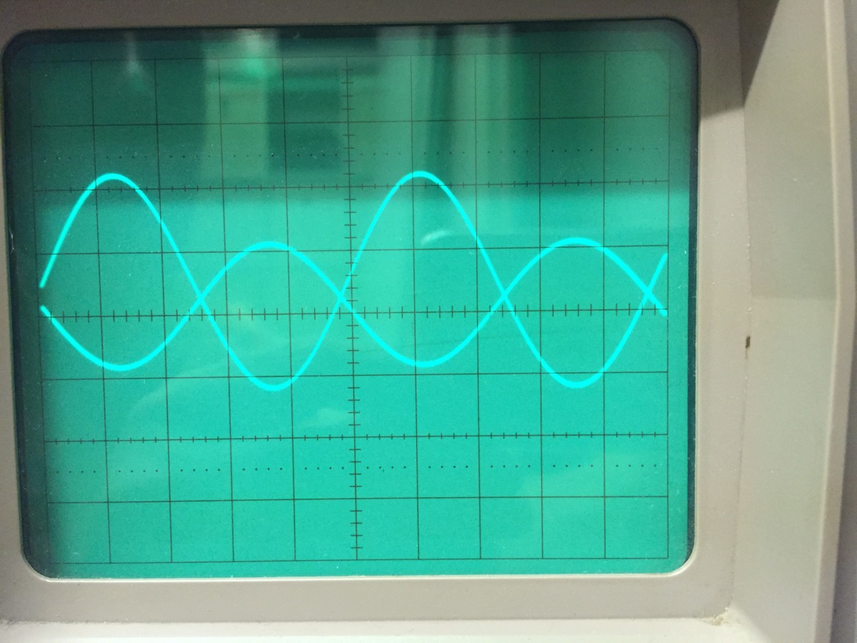

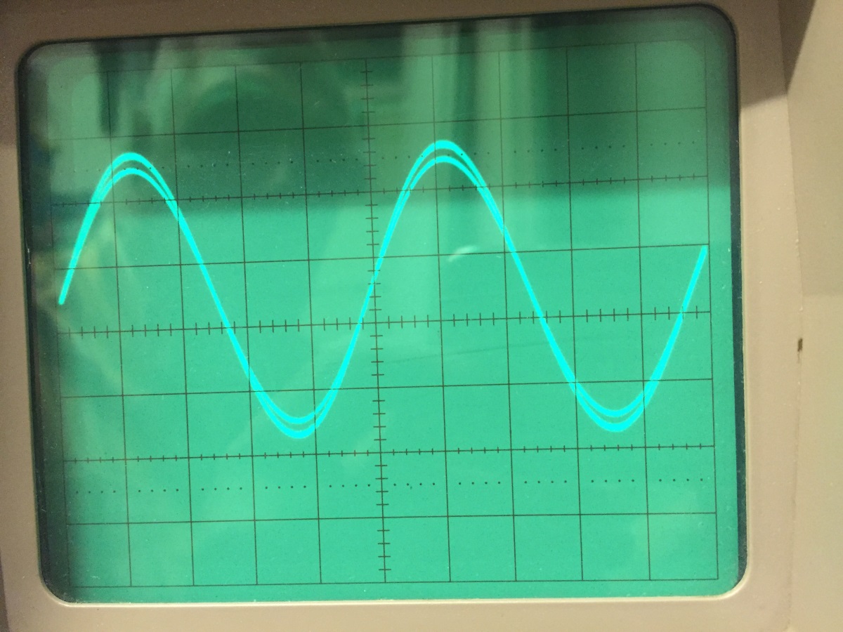

Then the Input 0.4Vpp / 1kHz sine. The pictures show all things without changing the input from function generator:
1 No heating, no anode current, input 0.4Vpp, output is zero.
2 heating on, no anode current input is 0.35Vpp, output is inverted 0.2Vpp
3 Heating on, anode current flows, input is 0.4Vpp, output is inverted 0.25Vpp
4 amplifier input is 0.4Vpp, output is 8Vpp and looks good
But, when I connect a speaker or have a look at the scope at very low frequencies, the sound is like a machine gun. A "Blob" come with 5 to 10Hz and the resistors in the rails become very hot.
What is wrong? Sorry, I have absolutely no experience with tubes ...
regards Olaf
