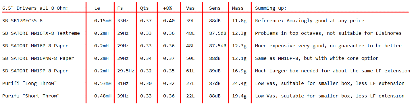

Re comparing different drivers:
In looking around, and I have been looking around and the above is just a few samples, there are not many drivers suitable for the Elsinores. The best alternative is the SB MW16P-8 Sartori, but... it does not mean you can simply swap out and hope it will work. The front panel needs to be different, it needs to be fully computer modeled and adjustments made to the crossover. I am confident that it will work, but not sure if there will be a great improvement. The sound will be very much in the same vein.
As for the tweeter, I have found no alternative that will work in the Elsinores the way the SS D2608/913000 (also know as the Peerless HDS) at any price.
I am not sure if the waveguide can even be used, are they physically compatible? That phase plate looks problematic. But it is 4 Ohm and its output is low when it should be much higher. There are times when a 4 Ohm tweeter can be used as 8 Ohm, but only when it has high sensitivity. This tweeter does not.
I am definitely going to design a 2-Way in the future. I will be using the current tweeter and waveguide combination. The SB MW19P-8 looks to be an awesome partner. When it came out I visited SB in Herning, Denmark, and I spoke to designer Ulrik Schmidt and showed me one of the first samples. This was October or November 2017. I got the impression from him that he considered this as maybe his masterpiece. Looking at the bass tuning, it also looks to be capable of serious low-frequency extension.
To sum up, this is what I would do, use the current tweeter and waveguide combo and either MW19P-8 or the white version MW19PNW-8.
I highly recommend you do that combination.

As this 2-way will be a 2 driver setup in a MLTL maybe the 4 ohm and lower sensity isn´t a problem. But as I really like the D2608+WG the only reason to switch was to get a pure SB speaker. In a 2-way the tweeter need to be xo:d lower than in a 2,5/3 way. Will be intersting to se how low the D2608+WG will work.
For the midbass I have experiemented with a lot of drivers, including this MWP19. Very few does work well in a MLTL (or TL, or TTL) and the MWP 19 is not one of them. The SB17MFC35 works extremely well. The only really option to it is, and even a better option, is SS D8531G00. So maybe the first practical try will be D2608+WG and SB17MFC. A minimum driver number version of what is used in both the Elsinore and the Hamlet. Inetersting.
