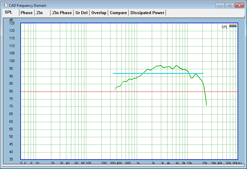

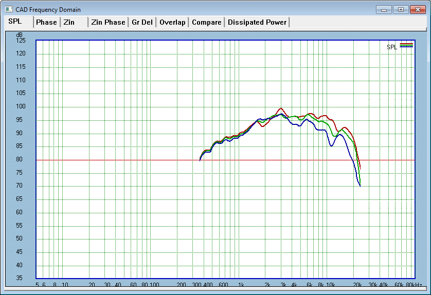

(B.T.W. all: still looking for the spl and imp graphs for the 2608 with WGs)
Found it!
A couple of things to note:
1. The rising response below 10KHz is the Waveguide "gain" and that it flattened out with the use of a much smaller 1st order series capacitor in the crossover.
2. The main one in the graph is the GREEN trace, this is slightly (15 degrees) off-axis and about the angle the Elsinores are designed to be listened to.
3. The impedance is not really changed from normal.
Took me a while to find it.
Cheers, Joe
Thanks a lot Joe,
And for the explanation.
