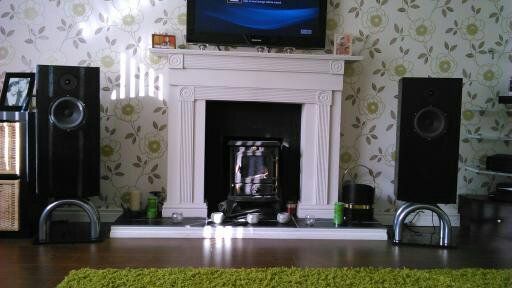

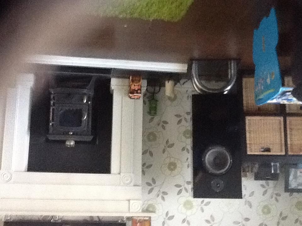

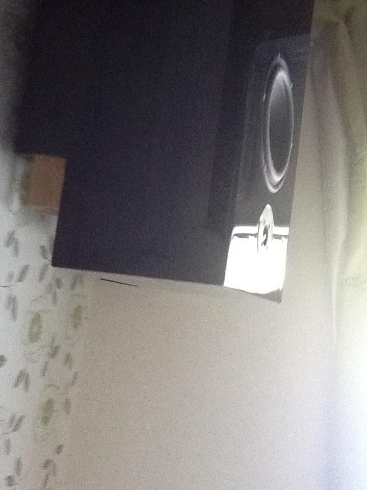

I have my pair working and finished, they have around 20-30 hours on them and are running in nicely.
https://drive.google.com/file/d/0B5m...ew?usp=sharing
I have gone for a gloss finish on this pair. My previous speakers in this system were KEF Reference 103/4 and TDL studio 1 (which are transmission lines).
They seem to do everything well, separation, detail, dynamics are amazing and better than my previous speakers. They do go deeper than my TDL Studio speakers did. Placement of instruments and performers is very precise.
Thanks to Dave and Scott for an excellent design

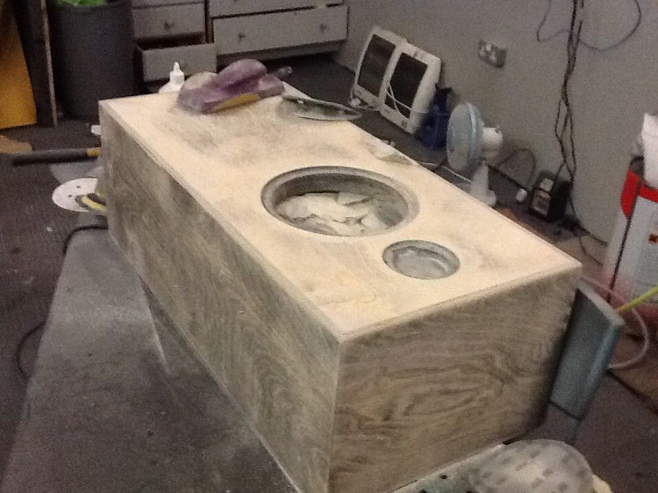

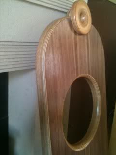

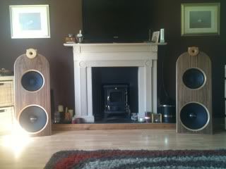

no pictures of the XL/s tey as i need a new usb lead for my camera but as a taster this was my last 2 DIY builds.
audionote kit 1 finished in piano black ( spray painted and polished by me) home made stands made with 2" heavy wall pipe bent and powder painted in dark chrome and filled with silicone sealer to stop any ringing, then bolted to granite chopping boards.
these bastanis based open baffles with a 36mm baltic bitch ply baffle faced with real walnut veneer then machined around the edges and driver with a big champher to show the ply grain.
I loved these speakers but the AN-e's i found way to warm and deep for me and the room buzzed along with them, the open baffles were the very best mids i have ever heard i used a beringer inuke 200w amp with DSP for the bass duties and crossed over at 200hz then the widebands did the rest driven with SE tube amps. A bit shouty when pushed loud but wonderful all the same.
