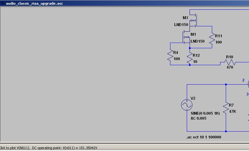

Do you know if there is a working ltspice version of LND150 ???
I was using the LND150 from supertex.lib , where I also are using the DN2540.
The DN2540 is working from this library, but it's another story.

Good find! Yes, the Supertex model is crap. Did you try the suggested model yet?
Haven't tried it yet, will try it tomorrow..
I'll add the new one to my schematic and post results...
Why wait to tomorrow.. Can see that this new one with these data.
.MODEL LND150 VDMOS (Rd=450 VTO=-1.35 Kp=2m Cgdmax=1p Cgdmin=0.25p Cgs=7.5p)
Does not work as intended anymore 🙂
Now I can not go over 151 volt.
