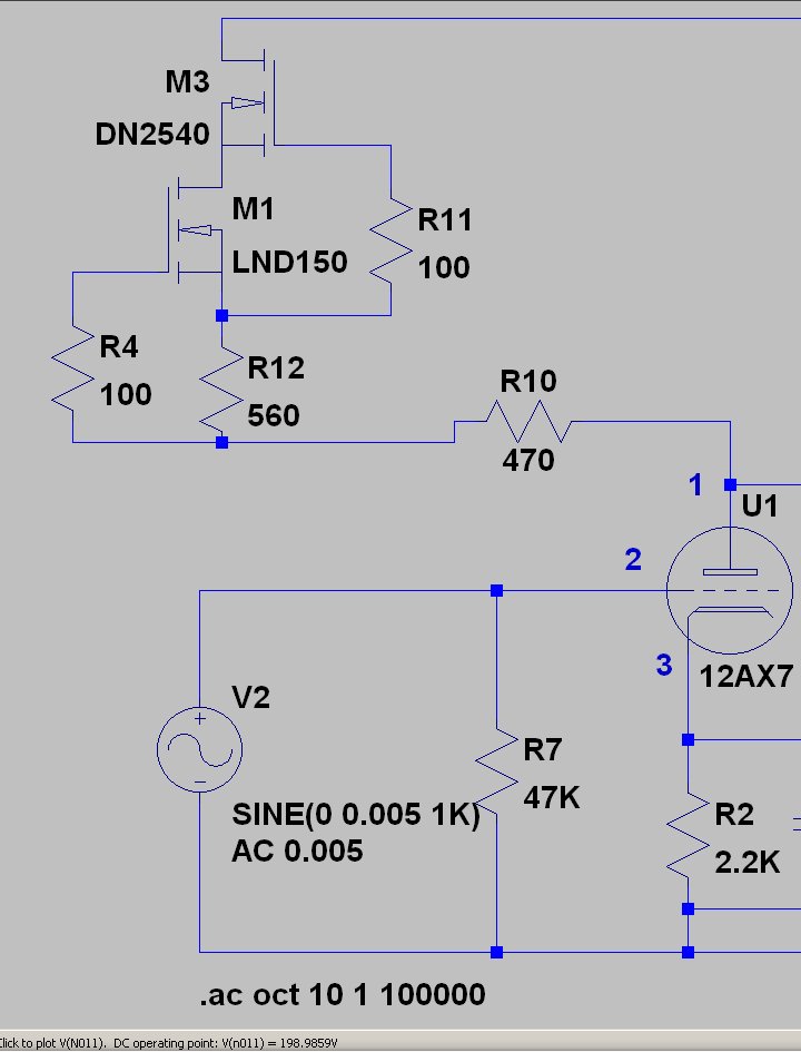

At this mommnt my 2nd phono stage works with only 0.49 mA (Rset 820 ohm and VRset 0.4Volts). I used the "mu" output for lower out impedance.
The first stage is yet a resistor load.For mod.6n2p-ev tube.
It sounds fine.
The cascode is composed by LND150.
