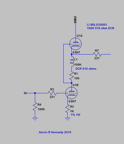

I used a 6SL7 based SRPP in my earliest SE 45 design at about 2mA of plate current, Vs to the SRPP was 320V, and it worked quite well actually.
Another variant that I like subs a 6SN7 with a choke and series resistor in place of the cathode resistor in the upper tube of the SRPP. I dubbed this a choke augmented mu follower when I first thought of it 20yrs ago. (I suspect lots of others came up with this as well.) Direct coupling to the grid of the 2A3 in this case. See attachment for what I am talking about. Gain is mu, and the Vs can range from 300 - 400V as suits the output stage. DC on the output cathode is very close to 1/2Vs. I run this at 8 - 10mA, it can comfortably swing > 100Vpp. (At 400V it will drive a 300B to 180Vpp) There may be benefit to bypassing R2 with a good quality electrolytic if you need a lot of swing. (I usually don't)
Note the loktal equivalent of the 6SN7 is the 7N7, which is generally a great choice unless you need to run it at much over 300V on the upper plate in which case it is a very questionable choice IMLE.
I have no idea what RL experience means, but I have designed dozens of tube amplifiers over the past few decades if that helps.

The choke augmented srpp looks nice so I went ahead and made some spice simulations. Besides the advantages you mentioned, unfortunately I also found some drawbacks (if spice is correct).. the choke introduces higher order harmonics and rolls of the bass response..
This is with a 6SL7. With a 6SN7, the effects are less noticeable, but the gain is too little to direct couple the 2A3. Unless you go for higher Vs, but then you need to raise all voltages on the 2A3 to insane levels..
The choke augmented setup seems nice overall, but it doesn't seem to fit for my application.

Yes, the circuit is intended for use with the 6SN7 and is not very practical with the 6SL7 which has about 10X higher RP.
I actually have built a number of 2A3 based amplifiers using this circuit direct coupled to 2A3, and 1.5Vrms is sufficient to drive it to full output so I am assuming you need much higher sensitivity than this?
Lundahl makes a 270H henry choke that I suspect would provide better results than the 100H chokes I used.
It's just one of a number of options to experiment with which is why I posted it.
@ Disco: The circuit I posted actually is not pushpull and not an SRPP at all, but a variant on the mu-follower and performs similarly within the limits of the choke's inductance and inter-winding and capacitance to core. It has a small advantage over the standard mu-follower wrt supply voltage requirements as the voltage drop across the choke is generally much smaller than that of the bias and load resistor in the conventional mu-follower.

Australian DIYers have done considerable work on choke loaded SRPP. Inductive reactance at 20 Hz. should be 3X RP, which is problematic for types like the 6SL7.
Morgan Jones' beta follower, which employs a BJT as the load, is another setup worth investigating. Perhaps careful selection of the BJT would make this variant a good choice in combination with the 6SL7.

Thru the bootstrap cap, the cathode follower acts as a quasi ccs for the initial input stage, boosting its gain to almost µ. The cathode resistor bypass cap of the input stage can be dropped. Also, the input stage work in a more more linear regime.why is the "cap bootstrap" required for the cathode follower version?
The choke does not have to be particularly large at all.
Imo, it doesn't need to be anything special, it just has to be an inductor of sufficient inductance and power handling. The power handling is on the order of a watt or two... afaik it could be the primary or secondary of a suitable power xfmr. Ought to be very low cost.
Goldenbeer, it acts as a quasi CCS for the input stage?
Don't exactly see that.
But it is a cap - and couples more at HF than low...
...I'll have to take ur word for it, lacking the time or fortitude to do a simulation myself.
Non-resistively loaded "totem pole" setups are interesting. Australian DIYers have done considerable work on choke loaded SRPP. Inductive reactance at 20 Hz. should be 3X RP, which is problematic for types like the 6SL7.
So, the circuit is in single ended operation with the upper valve acting as a constant-current source? That would make a voltage amplifier with maximum peak current flow equal to the quiescent current. However, there's the choke with its energy stored in the magnetic field. Can it deliver the juice a DHT asks for driving Miller capacitance? How's linearity at that point? DC resistance should be low in that case...

Operation is very analogous in most ways to a standard mu follower, however fairly high current operation is possible - I run these at around 10mA with a 6SN7 and output z should be < 500 ohms. The upper tube acts as both a cathode follower and current source, appropriately chosen the choke provides a large reactance that loads the lower tube and is bootstrapped by the follower on top. The quality and value of the inductor does matter as large amounts of capacitance to core or adjoining windings will result in HF roll off. Using a good choke - 3dB points of <20Hz and > 60kHz can be achieved.
It is quite practical to use similar tubes in this circuit with a higher transconductance triode running at higher current on the top - to do this all that is required is to add an appropriately sized resistor (or current source) between the cathode of the upper tube and ground.
