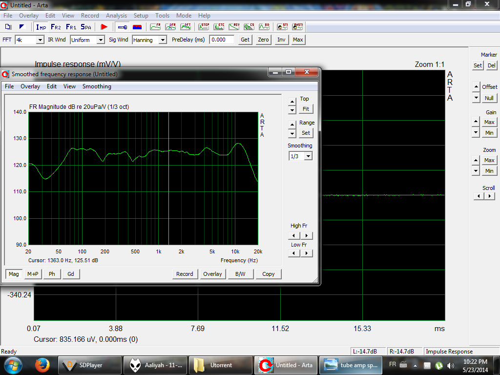

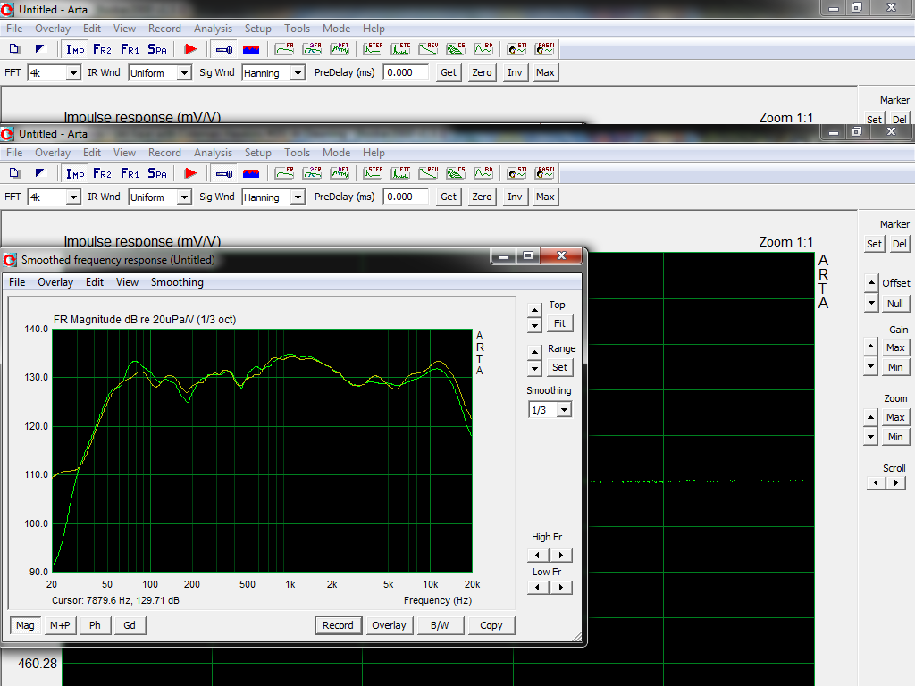

I did some measurments with the same speaker in the same room with the class d and the tube amp.
here's the measurments results.
Yes, a sinewave look proper too.
tube amp is the left one and class d right oneAfter 99 replies, seems nobody has bothered to ask the most basic of questions. The OP noted that he made some measurements and that nothing is really wrong, sans the poor perceived performance when compared to some class D amps. So I guess I'll ask.

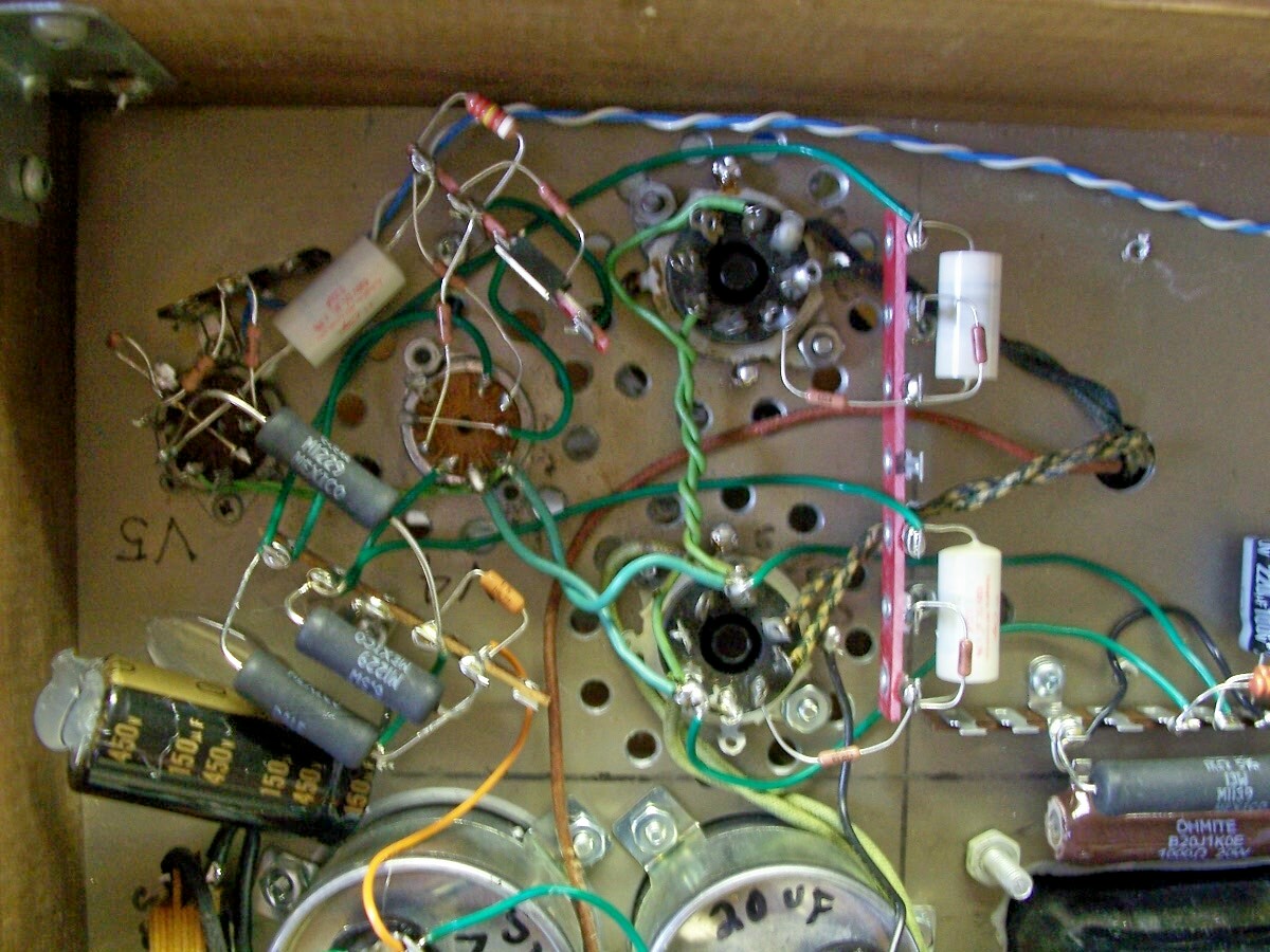

Layout issues?
This from costis_n got me to go back and look at your layout.
After looking at this picture --
-- I think your heater wiring is likely to be injecting hum into the audio circuitry.
The heater wires should be tightly twisted together, into 'twisted pair.' It's easier to do this with solid core wire, as opposed to stranded wire.
The (tightly) twisted pair heater wires should be routed away from the audio signal circuitry. It's common practice to tuck the heater wiring into the corners and edges of the chassis, only coming into the center of the layout to get to the tube sockets. Then the heater wiring doubles back to the edge of the chassis, and travels along the edge until it comes to the next tube socket. Something like this --
Please take a look at this thread (it's a sticky in this forum):
heater wiring - the Good the Bad and the Ugly
There are pictures of 'good, better, best' heater wiring practice in post #2 and post #3.
Note that in post #20, kevinkr mentions that DHT tubes with filament voltages over 2.5V should be DC rectified. The 6.3V filament of the 6B4G DHT tubes makes them a bit of a challenge. Note that EL34 tubes are indirectly heated, so are easier to work with in this regard.

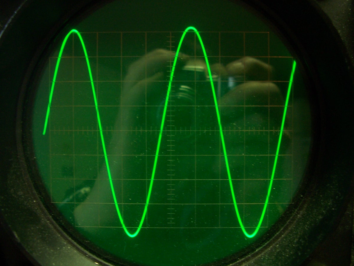

If you can measure frequency response at 1W output (4V *peak* across the 8 ohm load resistor), and then measure frequency response at 5W output (9V peak across the 8 ohm load), that will be a useful comparison.
Please also take a picture of a 1kHz sine wave at 1W output and attach that to your next post.
Finally, please take a picture of a 10kHz square wave at 1.4V peak output (1V rms) and attach that as well.
You might want to read this article, as it outlines exactly what's up. Atma-Sphere music systems, inc.
Essentially, the speaker is a Voltage Paradigm device, and the tube amp in this case is a Power Paradigm device.
The result is a frequency response artifact. This is why voltage feedback has been recommended, to try to create the correct voltage response in the tube amp.
The problem is that you may find that adding negative feedback has other deleterious effects on the resulting sound. In a word, it will get brighter even though the actual frequency response is unaffected. This is because the feedback will add some odd ordered harmonics, to which the ear is very sensitive.
To get around this you might consider a Zobel network to equalize the voltage/power issues in the problem area of the frequency response. Then you won't need the feedback with its attendant problems.

1-Sine wave 1Khz - 1W (2.8vrms).
2-Square wave 10Khz - 1 Vrms.
Output flat 20hz - 20Khz at 5Wrms (6.4vrms) @ 8 ohms.
Output clipping distortion appears at 10Wrms (9 vrms) @ 1Khz - 8 ohms.
we realized that the V1 in the amp 2 introduce distortion at 5W. so I will have to change the problematic tube.

I will try to ameliorate the wiring and see how the hum reacts. But the hum sound really low. I cannot hear it at all from the listening position.

Seriously, what you measured so far doesn't tell much. The main reason I continue to ask for actual measurements around output noise is based on three things:
1- your initial post stating problems with low level detail
2- the fact you are using 6B4G triodes with AC filaments
3- your schematic shows output noise as less than 100mv
So, exactly what is the output noise and what does it look like on the scope?? Your signal to noise ratio pretty much defines the dynamic resolution of the amplifier. If I were to take your worst case value from your schematic, say 99mv, the amp would have a S/N ratio of ~29dB (ref 1-watt), which renders it useless. Even 1 mv output noise is high, and your S/N is only 69dB. My personal reference for anything 10-watts and under is 80dB S/N referenced to 1-watt. That means an output noise less than 283uv (yes, microvolts... or 0.000283 VRMS). To put it simply, you're not going to get anywhere close to that with AC filaments on the 6B4G tubes.
So until the actual S/N is known, making circuitry changes is a moot point, as you still haven't isolated the cause of poor low level detail (which is likely to be a S/N limitation). This is why I've asked twice for this measurement. I guess it's out of the question to know what the design parameters where for the initial design.
