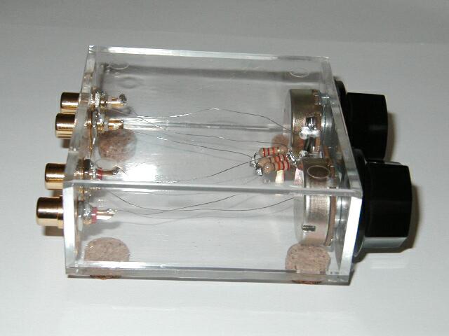

To dispell the rumor that I am an over priced parts snob, I offer the following project. A passive preamp for under 20 dollars worth of parts from Radio Shack and your local arts and crafts or Container Store. Construction time is a couple of hours. Astonish your friends! Confound your enemies. Give one away at your next audio club meeting. Send it to school with your kid for show and tell. Spend the money you save on your wife for a change. This is a great sounding little project.
2.5 inch signal path with air dielectric
Dual mono
Silver solder and silver plated wire.
Series shunt design that sounds better than pot alone
Neutral tonal balance and transparent imaging
This is not a joke. April Fools day is weeks away. Any interest in construction details?
H.H.
Passive

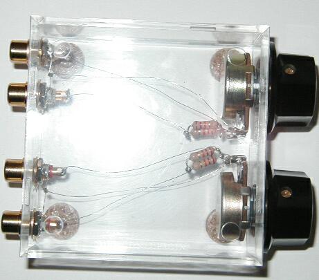

No, the one I built has a series resistor (two 22Ks in parallel) connected between the signal pin of the input RCA jack and the wiper (center) leg of the pot. The output RCA jacks center pin is connected to the wiper leg of the pot. Only one of the other legs of the pot is connected to ground. The correct leg is the one that gives a very low resistance between the center leg and it when the pot is rotated fully counter-clockwise. The third leg of the pot is unconnected. So we have an 11K resistor between the signal pins of the input and output RCA jacks and the pot across the
signal to ground of the output RCA jack. The input and output jack are mounted next to each other for each channel. I left split washers out and soldered the ground wires directly to the threaded part of the RCA jacks. You could use the 2% silver solder if you are worried about melting the insulation on the jacks or plastic case. Sounds good, but not not as good as 4% silver solder but is much easier and lower melting point. I often tin the part with the 2% and finish with the 4%with very good results.
The pots are 100K audio taper Alphas from Radio Shack. The wire is 30 guage wire wrap wire with the insulation removed and the solder is 4% silver lead free, both also from R.S. I used box for displaying hockey pucks and cork feet from the Container Store.
I think the clear case adds to the transparency of the design. Okay that part was a joke but the innards are much cooler to look at than a hockey puck! I guess I am an audio voyeur. My audio designer friend and I send each other "Naked Amplifier Pics" from time to time. This is the most audio bang you can get for 20 bucks and is easy to build and find parts for. Sort of like Fast Food for gormet taste. I will be very dissapointed if this doesn't become an audio cult classic. Plug in those soldering irons, head to the Shack,and lets get some feedback on your results. I will try the Rod Elliot Passive for my next project and report on the results.

You could still improve on that design by soldering resistors directly between input and output pins of RCA jacks. The length of signal path is the length of a resistor. Then run a wire from output pin to the wiper of the pot and connect the other pin of the pot to the ground. Since now you are using only 2 wires to the pots you might be tempted to use silver wire.
Passive revision
Blast! Out foxed by a brat from that damned Hogwart's school for troublemakers.... Actually its not a bad idea. You are eliminating 4 or five inches of wire. The signal path is still the same length since the pots are in the circuit in both cases. I could use silver wire, expensive pots, expensive RCA jacks.... you would have to order the parts after you deliberated on which parts, where to order them, maybe you should use a stepped attenuator? You think to yourself..... to much trouble, too much money, forget it for now, I'll do it some other time or maybe I'll post of few dozen post on audio forums and discuss it forever. Or you could go build it and find out how good it sounds. I have built the good stuff but that is not the audience this project is intendend for. I want people to think, 20 bucks, two hours, why not? I will post some more tweaked versions afer some actually builds this one. Robert
