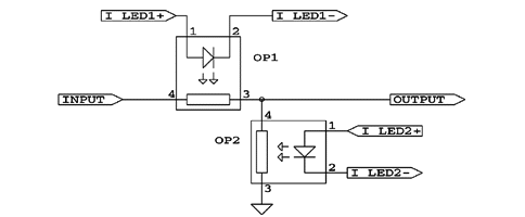

I've tested and listen to just about every concievable passive potentiometer (volume control), Bournes, Alps Blue Velvet, Alps Black Beauty, Penny&Giles, Dact Switched resistors, and transformer (TVC) based volume controls.
Nothing has equaled the transparency and dynamics of sound than that of a series/ shunt LDR arrangment in the attachement, it has no contacts in the signal path, I believe that is the secret.
The only stipulation that all these passive controls including the series/shunt LDR need I believe is,
1: Low source impedence (cd player) <1kohm
2: High input impedence (amplifier) > 33kohm.
Cheers George
8-3-2015
To explain a little the 5 photo attachments.

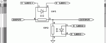

1st: Is the basic led/ldr and how it works in the Lightspeed Attenuator, it mimics a 10kohm series shunt logarithmic potentiometer.

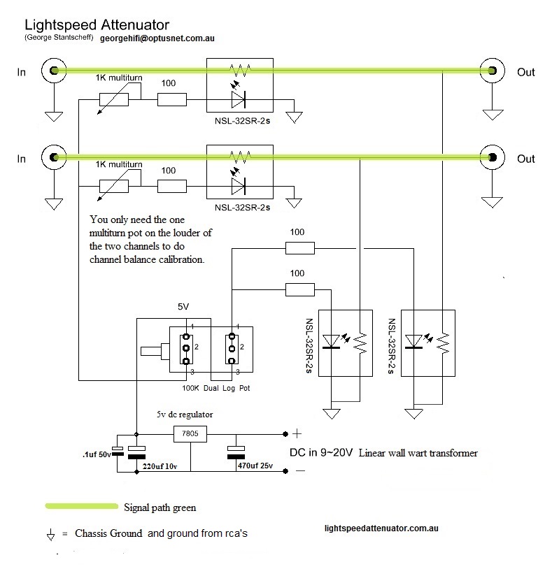

2nd: Is the Lightspeed Attenuator stereo version, complete circuit diagram, note how the signal goes through nothing but one soldered resistor, no sound robbing light contact of a metal wiper on a resistive track in a volume control (potentiometers) in the signal path.

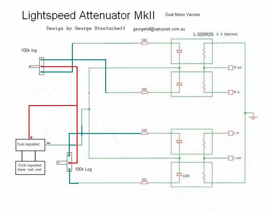

3rd: Is the same but a dual mono, good for room or system imbalances, (for some reason owners of both say the dual mono has the edge sound wise) I believe it's the fact you can precisely centre the image regardless of recording or environment influences.

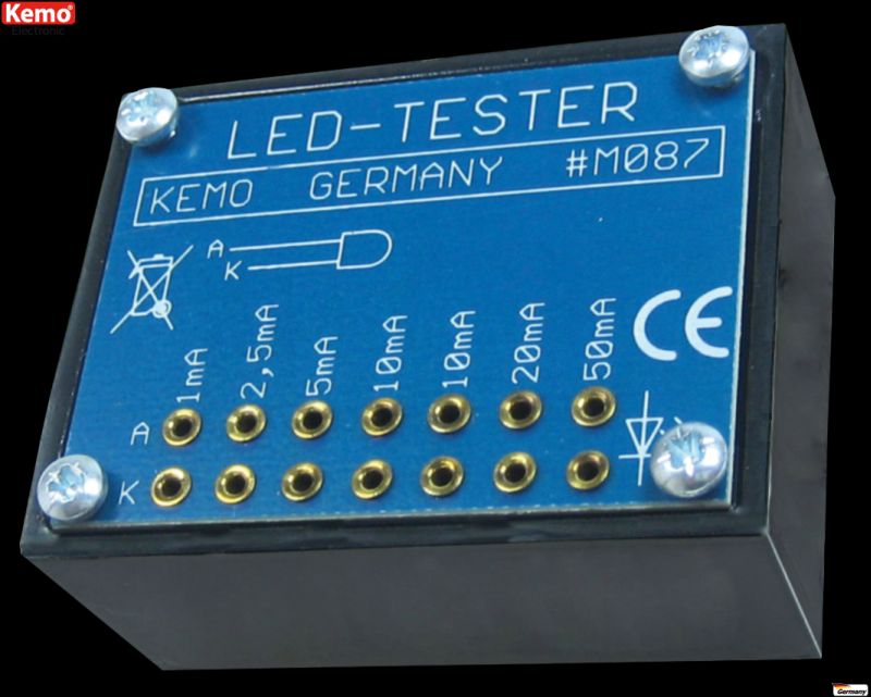

5th: Is the $30 Kemo M087N led tester you can get on Ebay. With this you can quad match your own set of NSL32SR2S(sorted) Silonex led/ldr's you'll need get about 15 pieces to get 2 sets of quad matched led/ldr's for two x stereo Lightspeed Attenuators. So go halves with a buddy and you can have one each.
Match the LDR resistances using a DMM, powering the LED from 1mA to 20mA, give them time as they need a few minutes to warm up.
PS: You can skimp on the cheaper NSL32SR2 but you have to buy almost twice the amount, as their low resistance is not as low and constant, they cannot get to quietest minimum volume level as the NSL32SR2S (sorted) can.
Cheers George
8-3-2015

Use a dual 100k log or linear pot to supply the voltage to the leds, one gang of the pot increases the series ldr's led voltage while the other gang in reverse lowers the voltage on the shunt ldr's led, this way you have a constant input and output impedence of the passive, regardless of where the voltage control setting is. I believe it's the perfect passive volume control.
You can put an LRD in one end of a tube and a Led in the other end x 4, you have to sort through a few ldr's to get 4 that track together for good channel balance, the last thing you want is to have a balance control, but even that's possible if you use two single 100k led voltage pots instead of a dual.
Cheers George

You should look for a LDR who's led on resistance is around 50ohm and dark resistance around 1megohm.
Also the balance control that I said would be 2 x 100k single pots for the leds is wrong, it would have to be 2 x 100k dual pots.
Also you could have a LDR in each end of a 1inch tube and the LED through a drilled hole in the middle, that way you'll only need 2x tubes for a stereo control.
There are combined Led/Ldr packages out there, but they are very expensive and you still need to match them.
And forget about using buffers before and after the LDR control, been there done that they only add their own colouration to the sound. A CD players output drive is plenty capable of driving a amp to clip, all you need with the LDR Control is to keep the interconects to the amp as short as possible, <2mts and to use ones that are <100pf per foot.

On all the best pots mentioned in my first post, what we found was that during fast pulsed millisecond transisents at cd levels, audio band squarewaves, then stored and reviewed frozen on the scope, the leading edge was getting corrupted sometimes ringing, this leading edge has a very fast rise time > 100's volts per microsecond
How this??...after a 20kHz filter! Possible done through a internal
overload?
snip
This also happened to switched resistor pots and also input switches, though to a lesser degree.
I have never notice this effect, though I built (non audio) amps to 10MHz.
What about the contacts in the scope attenuator?
snip
if we pushed on the wiper to give it harder contact to the resistive track the corruption stopped
In this case one need stronger/cleaner contacts!
snip
Hence the use for us to the led/ldr arrangment(zero contact area)
Why not, but at the expense of less stability and more non linearity (especially with high input voltages!)
For a "hifi" attenuator I`ll prefer therefore precision resistors connected with hermetically closed relays.
Regards
Heinz
overload?
snip
snip
snip
Regards
Heinz
