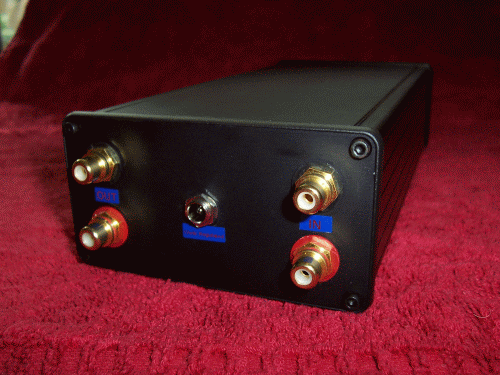

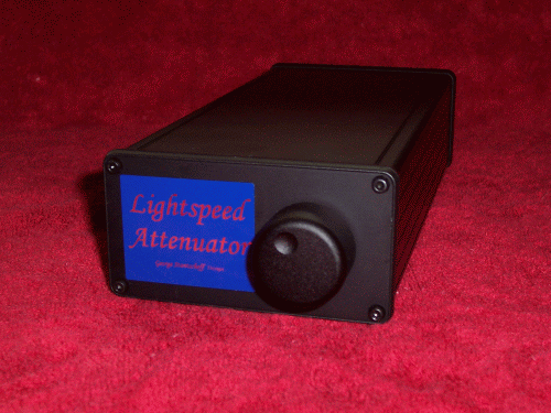

For those of you who are interested a couple of photos.
Front

Thank you so much for the information you have shared here. I have a question. The photo of your commercial offering only has one volume control. I thought the design required two, two gang pots? Are you using a single four channel potentiometer?
Badge said:
George,
Badge, if you look at the ruff circuit that I posted, it has one dual that can be 100k log or linear. You can use two duals one for each channel that would give you balance between channels, you could also de-adjust the 1k 25 turn trimpot to give you small range balance control, which is what I do, but it's only a couple of db each way.
Cheers George
