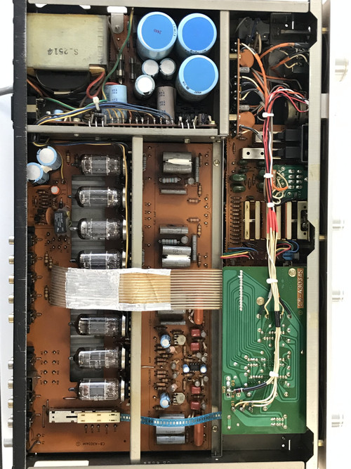

any phono preamp that's not using an op-amp forfirst stage gain makes better use of a regulated supply, but there are cases where rcrc filters are used although CLC filters are usually more efficient while with phono preamp, as @MarcelvdG already said the transformer stray field is one of the main peace killer and first tube fillament needs almost always a lift, but i found also a working alternative : Luxman CL-34...which i cloned a while ago , but i only received the iron case for it two weeks ago and complete shielding is a must with this circuit.
  • luxman_cl34_sch.pdf
