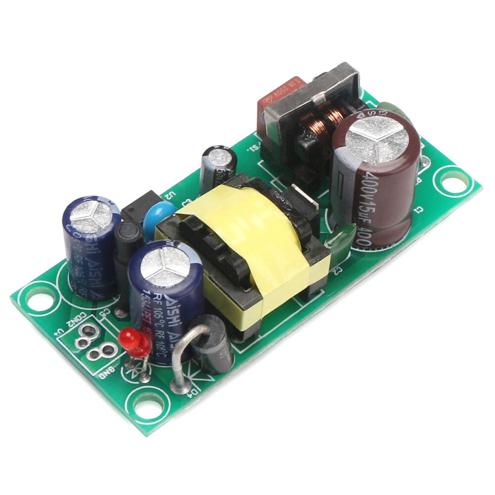

This is easy, cost effective, and works for two 300B tubes: RS-15-5 MEAN WELL | Mouser Schweiz

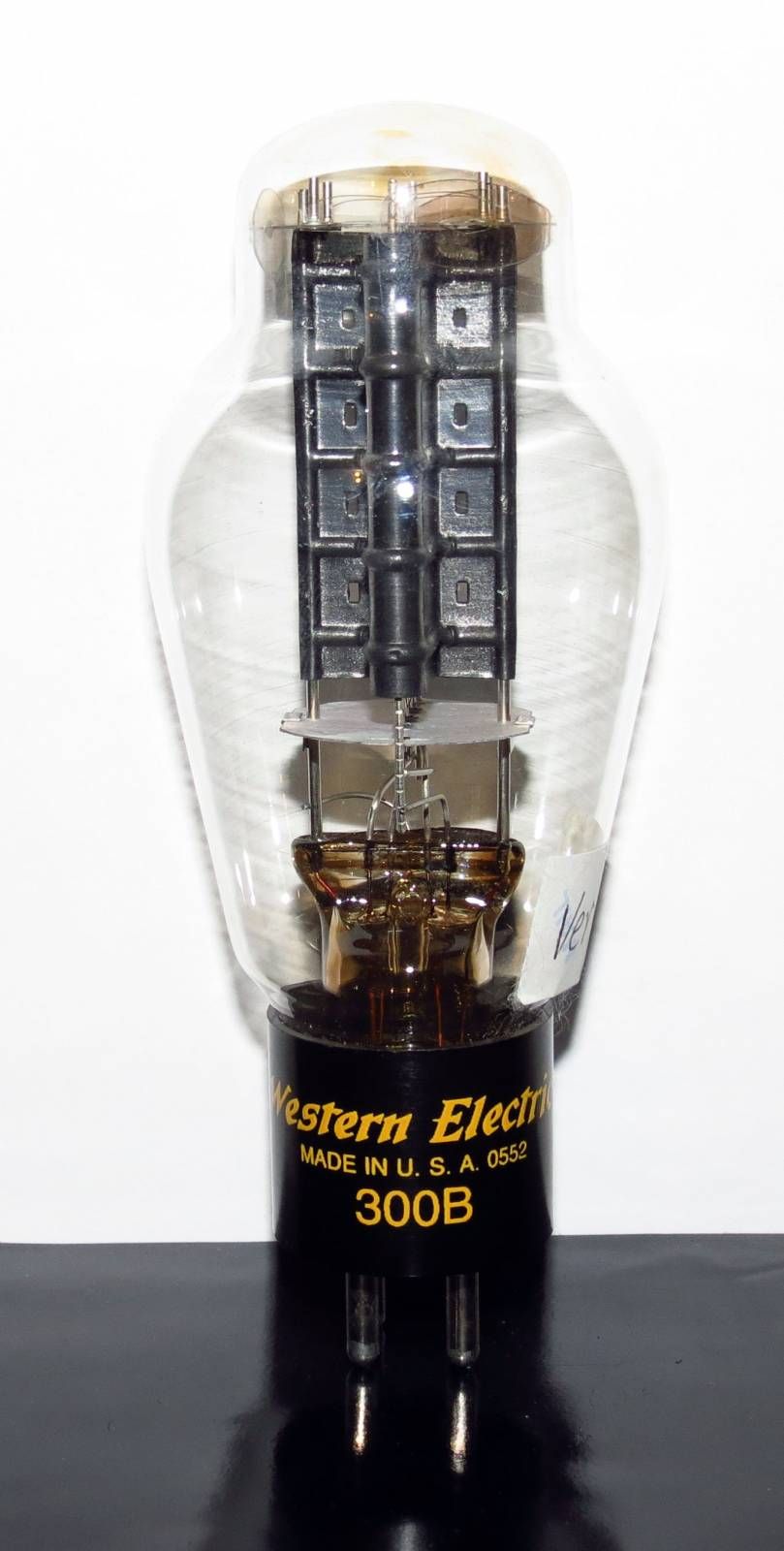

DHT filaments are a special use case and require more attention than just adding a DC supply - remember that the filaments are actually connected to the the cathode in the 300B so the power supplies directly affect the sound.
If you want to do it right, the simplest way would be to use these modules (one per 300B of course);

I have first hand experience - I run a derivative of the Transcendent 300B SE-OTL amps - thats four 300Bs per channel, single-ended with no output transformer that uses eight of this type of filament supply - ridiulously inefficient but so, so special.

Sorry, but how does simple and easy imply a cost? What could be simpler than hooking up an assemble PCB module.

Either one will have to sit down and determine the values to make said module work with a 300B, or the modules will have to be custom ordered.

Both of the suppliers I linked to would take care of configuring the modules to suit the specific requirement.
