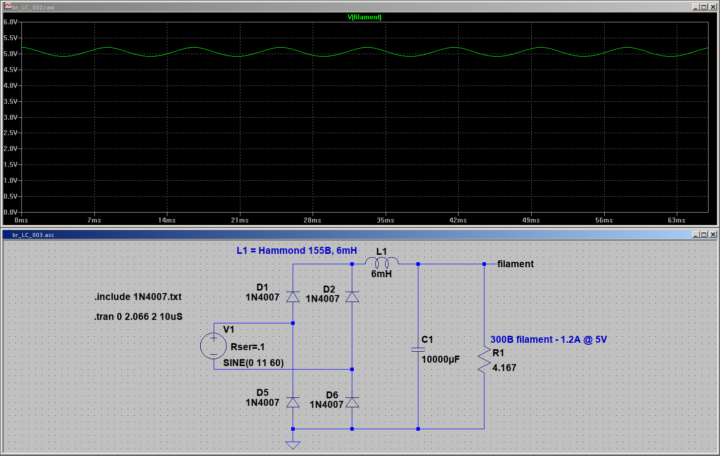

A simulation with a 1-henry choke and 2200uF filter cap suggests you need 11 volt peaks from the transformer (nearly 8 volts RMS) to get 5 volts out of the LC filter. It's a very nicely filtered 5 volts DC, though. :)
I use the Hammond 155B and a pretty hefty amount of capacitance (10,000uF). Perfect ripple free DC isn't necessary for this application. It's more of a balance between not torturing your power transformer and getting sufficiently low ripple.
A 1H choke with sufficiently low DCR would be a rather large and strange creation.
No doubt. Due to exactly the ridiculousness that goes with audio frequency chokes, I have managed to avoid using them - except in radio-frequency applications or loudspeaker crossover networks - for the nearly half-century during which I've been tinkering with electronics. :)
So, Hammond 155B, and only 6 mH? LTSpice sim attached, with 10,000 uF filter cap. About half a volt of ripple. And the choke costs about $23 CAD at Digikey, enough to buy a couple of 5 V or 6 V SMPS at the local thrift store, if you don't already have a couple cluttering up the junk-box. :)
-Gnobuddy
Generally, in my experience, yes. Certainly much better than the four diodes + 2200 uF circuit, which is quite useless for this particular application.
You can also use a 6V DC SMPS, add a 0.82 ohms series resistor (rated 3 watts or more), and use something like a 1000 uF electrolytic cap in parallel with something like a 1 uF film or ceramic cap to remove any remaining ripple. The resistor will drop the extra volt, so the filament gets 5 volts (assuming it draws 1.2 amps as the datasheet specifies.)

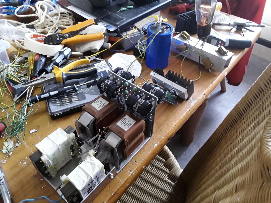

I use filament supplies that work with a similar aproach for my 300Bs - these were developed by a member of a UK Audio forum and made available to the group (they still are). Unlike the Coleman regs, these have everything on the PCB, other than the transformer. Very positive outcome when I switched to them.
