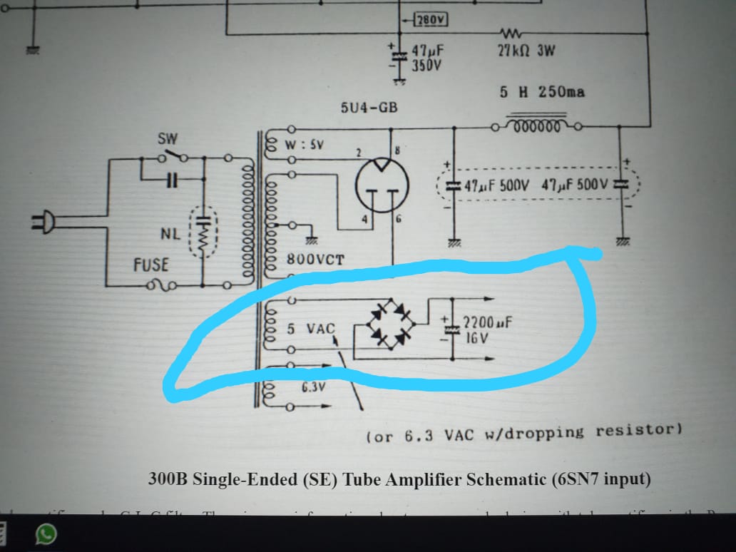

Could this help to flatten the ripple for the 5v filament supply ?
Yes, with a 5V winding you can use a chassis mount 25A bridge rectifier and a cap as a cheap DC supply. The chassis mount rectifiers tend to be kind of lossy, which helps bring the output voltage back down towards 5V after rectification. The capacitor there takes an absolute beating, so at minimum use PSUD to determine how much ripple current that cap has to deal with, then purchase parts accordingly.

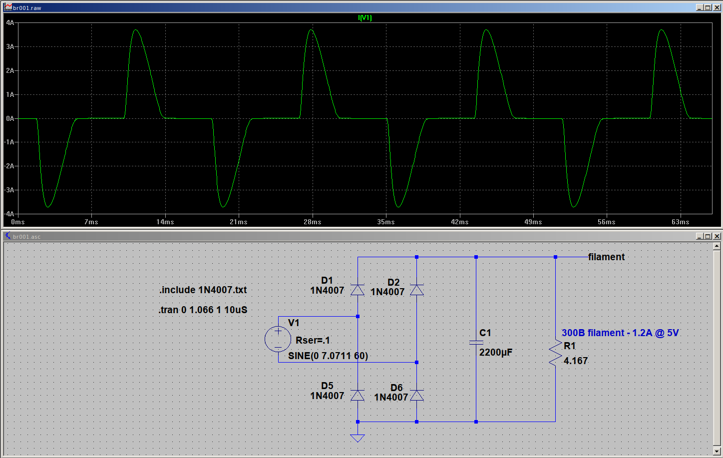

The first attached image shows the suggested circuit; a 5V RMS transformer winding feeding a diode bridge, with a 2200 uF filter cap to smooth the resulting "dirty DC".
The second attached image shows an LTSpice simulation of the circuit. LTSpice is a circuit simulation program with a long history going back decades. It originated as a research project created by a genius at Berkeley university, and has been steadily refined and updated since then. For simple circuits like this one, LTSpice simulations are quite accurate.
Note that 5V RMS is 7.0711 volts peak; LTSpice uses peak voltage, not RMS, so you'll see that I've set up a 60 Hz voltage generator with a peak voltage of 7.0711 volts in the simulation. This represents the 5V RMS transformer winding.
As you can see from the simulation, a diode bridge and 2200uF filter cap produces absolutely horrible "DC". There is an enormous amount of ripple - more than 2 volts peak to peak - which is more than 40% of the nominal 5V DC!
40% ripple voltage is atrocious - so bad that it shouldn't be considered acceptable for an instant. It isn't even reasonable to call this DC; it's halfway between being DC and AC. It's garbage.
You can't just solve the ripple problem by stuffing ridiculous amounts of capacitance into the circuit, either. The bigger the filter capacitor, the bigger the peak currents flowing through the diodes and the transformer. These huge current peaks radiate electrical noise, and even corrupt the waveforms on all the other transformer windings, because of their effect on the shared transformer core.
The third attached image shows the current flowing out of the 5V transformer winding, going into the diodes. Note the current peaks of nearly +/- 4 amps, and the sharp, spiky waveform. This sort of waveform has a lot of harmonics, and as a result, radiates noise not only all the way through the audio band, but even into the radio frequency bands.
In a nutshell, the 1970s solution to feeding DC to a 300B filament (i.e. a 5V transformer winding at 60 or 50 Hz, diode bridge, big filter cap) is terrible. It's awful. Anyone who uses it should be embarrassed!

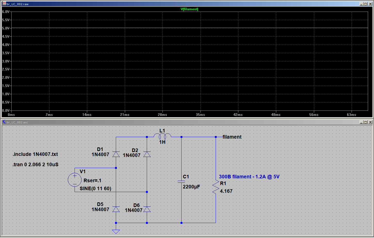

Agreed, vastly better than only a filter cap....choke input filter...
But of course you need a huge, heavy, expensive choke that can handle 1.2 amps continuous current, has low DC resistance, and has tons of inductance.
A simulation with a 1-henry choke and 2200uF filter cap suggests you need 11 volt peaks from the transformer (nearly 8 volts RMS) to get 5 volts out of the LC filter. It's a very nicely filtered 5 volts DC, though.
