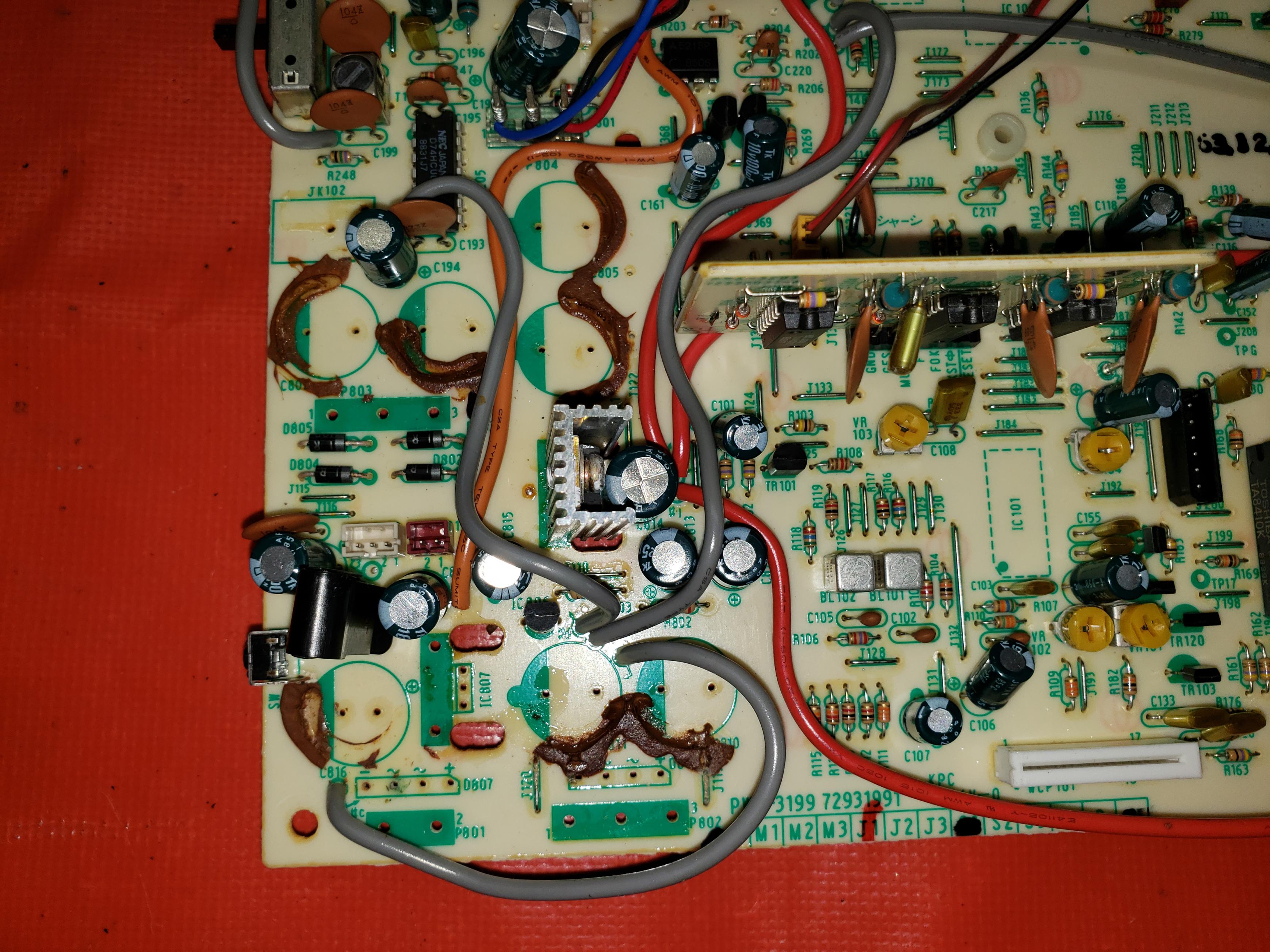

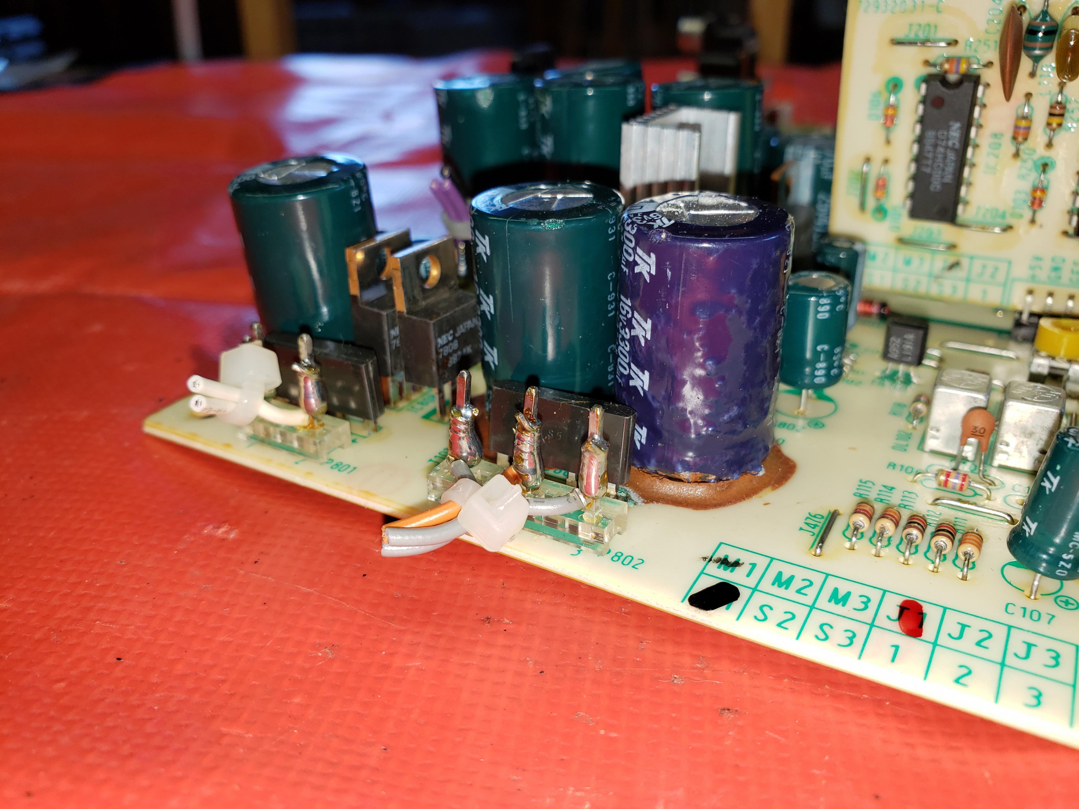

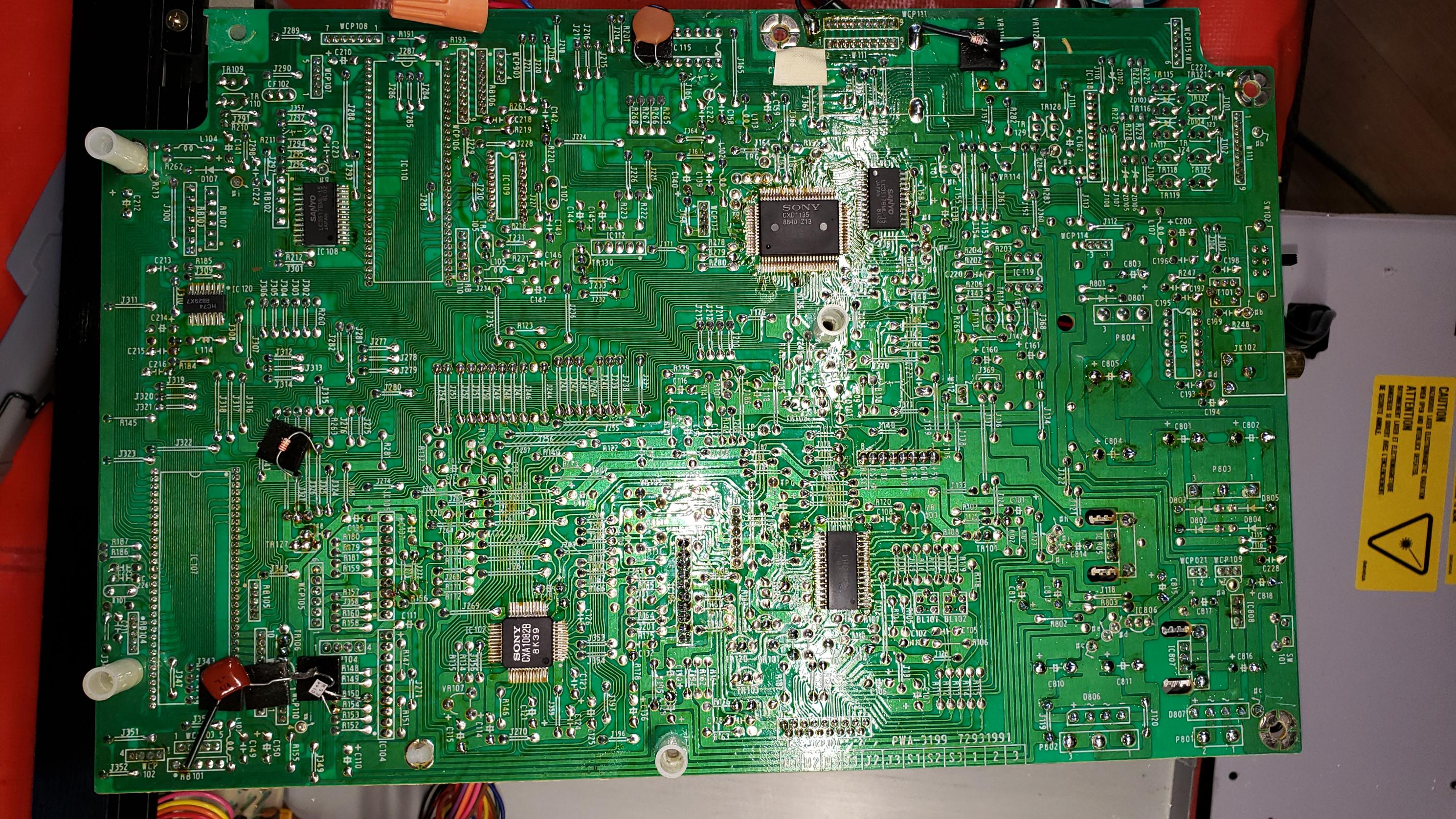

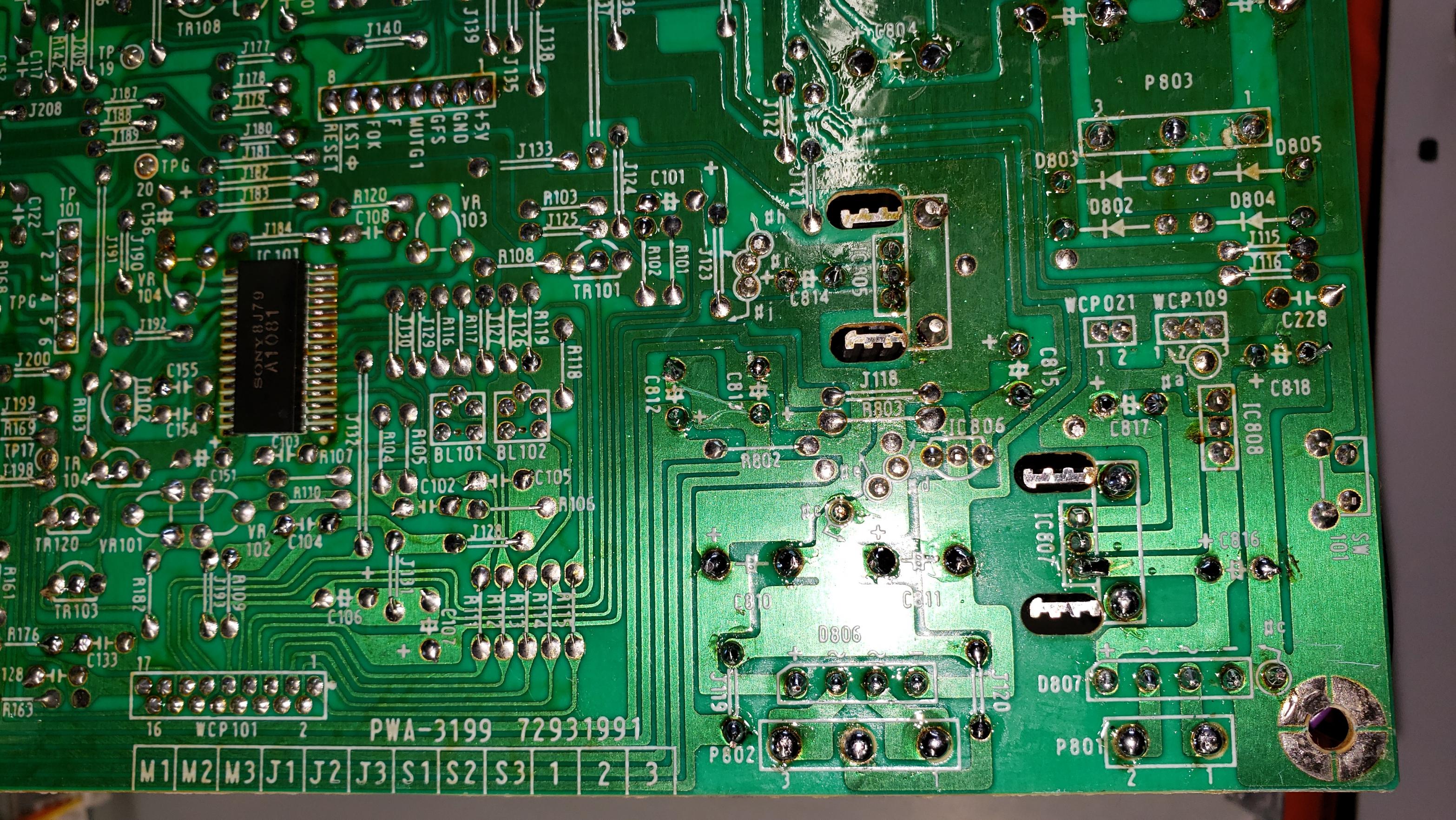

About 2 months ago I removed this working unit from my main system. A couple weeks ago I was scavenging a transformer from a CDC-3A and noticed bad glue corrosion on the power supply caps. So I decided to open the CDC-4A and sure enough the glue corrosion was starting. I decided to be proactive and remove the glue and replace any caps affected. I replaced the main power supply caps on the the main board with HW series Nichicon and all the caps on the separated analog process board with OEM capacitance. I have a fair amount of experience soldering and desoldering and have Hakko tools for both and haven't had this happen before.
After the recap at first power on I noticed a click sound from the laser assembly and it turned out to be the lens retracting and staying there. I powered off the unit removed the ribbon cable from the connector, anti stat solder in place, and measured voltages. Pin 17 focus coil on the connector is measuring -10.78V and 0 on 16 should be 0 on both I believe. I traced this to pin 1 and 2 of U106 (TA8410K). At this point I'm not sure and need some help tracking down the problem. I did try a different 8410 and no difference. I have a donor 4A if other parts are needed.
Power supplies and voltage regs seem to check out.

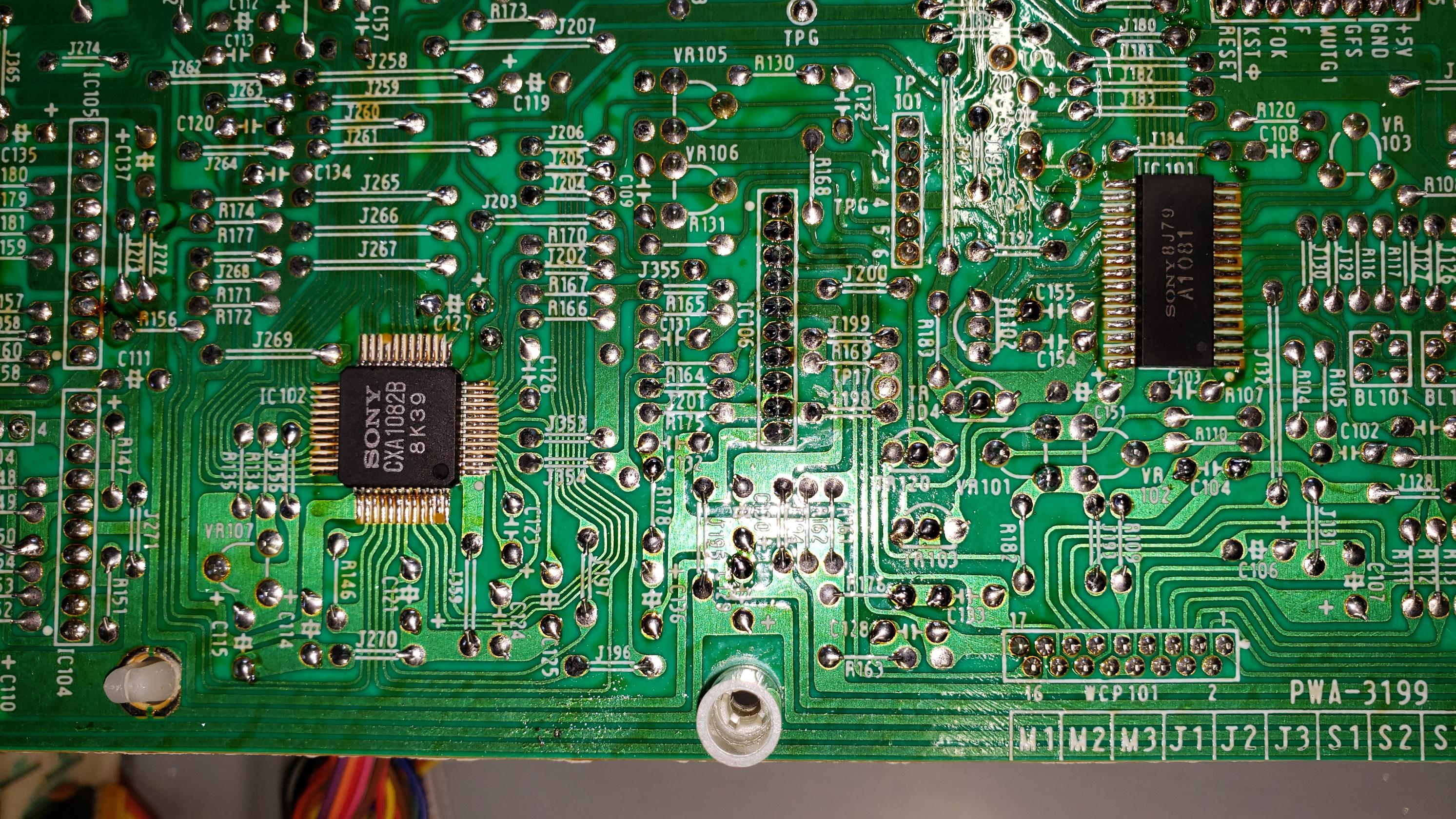

I have triple checked for cap polarity and shorts and cannot find anything and have even removed the analog process board.

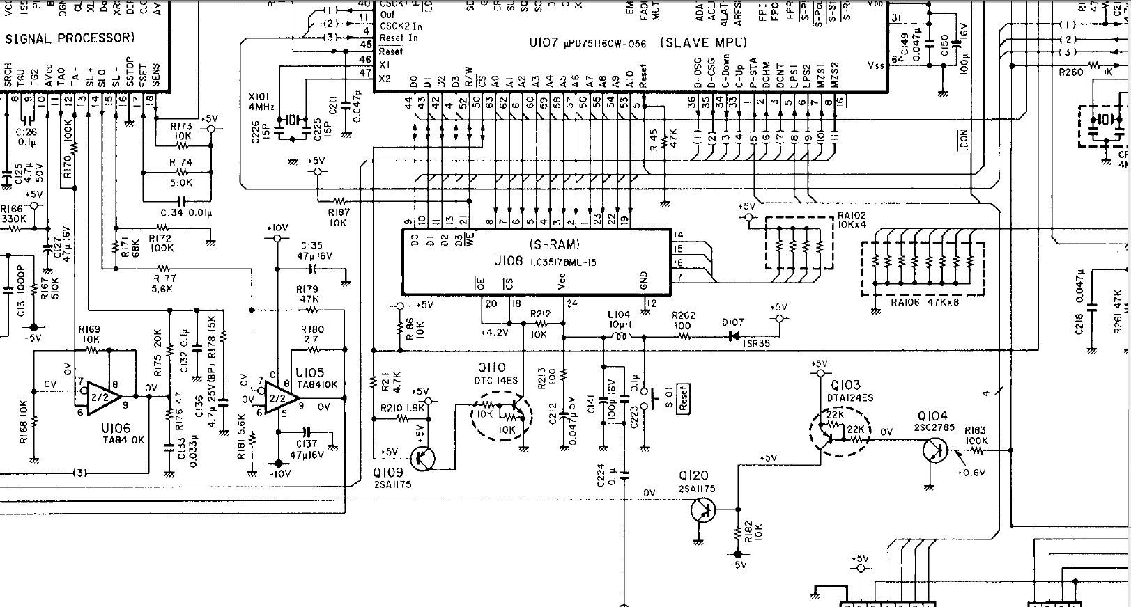

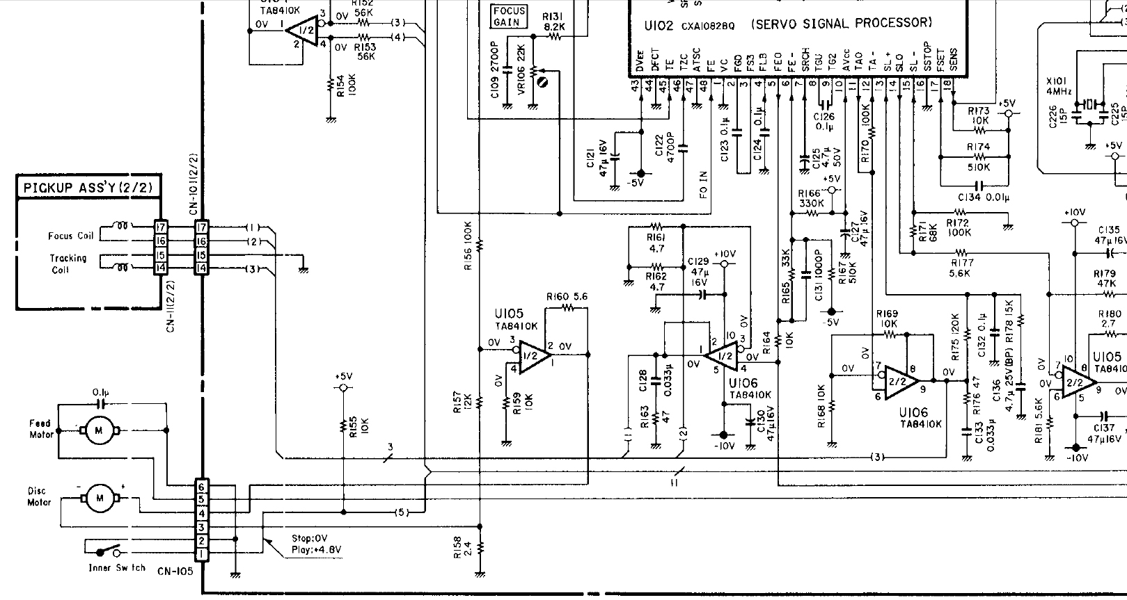

I have a schematic of the unit and have included the circuits.
I didn't replace the multitude of 47uf caps but did measure some and according to my cheap checker they have around 2% V loss but normal capacitance.

Hi Chris,
Thank you for the reply! The first thing I did upon lens retraction discovery was power off the unit, apply the solder blob, and remove cable from connection header.
Powering back on I measured pin 16 and 17 on the cable connection header, which control the focus coil. Pin 17 measured -10V coming from Pin 1 and 2 of U106. I then replaced U106 since that seemed easy and no difference.
I would rather not plug any laser assemblies back into a header outputting -10V where it shouldn't.
Not sure what to check next and I didn't and still don't, with a jewelers loop, see any shorts. Analog process board which I worked on a lot more is out the unit for testing purposes and no difference in operation fault.

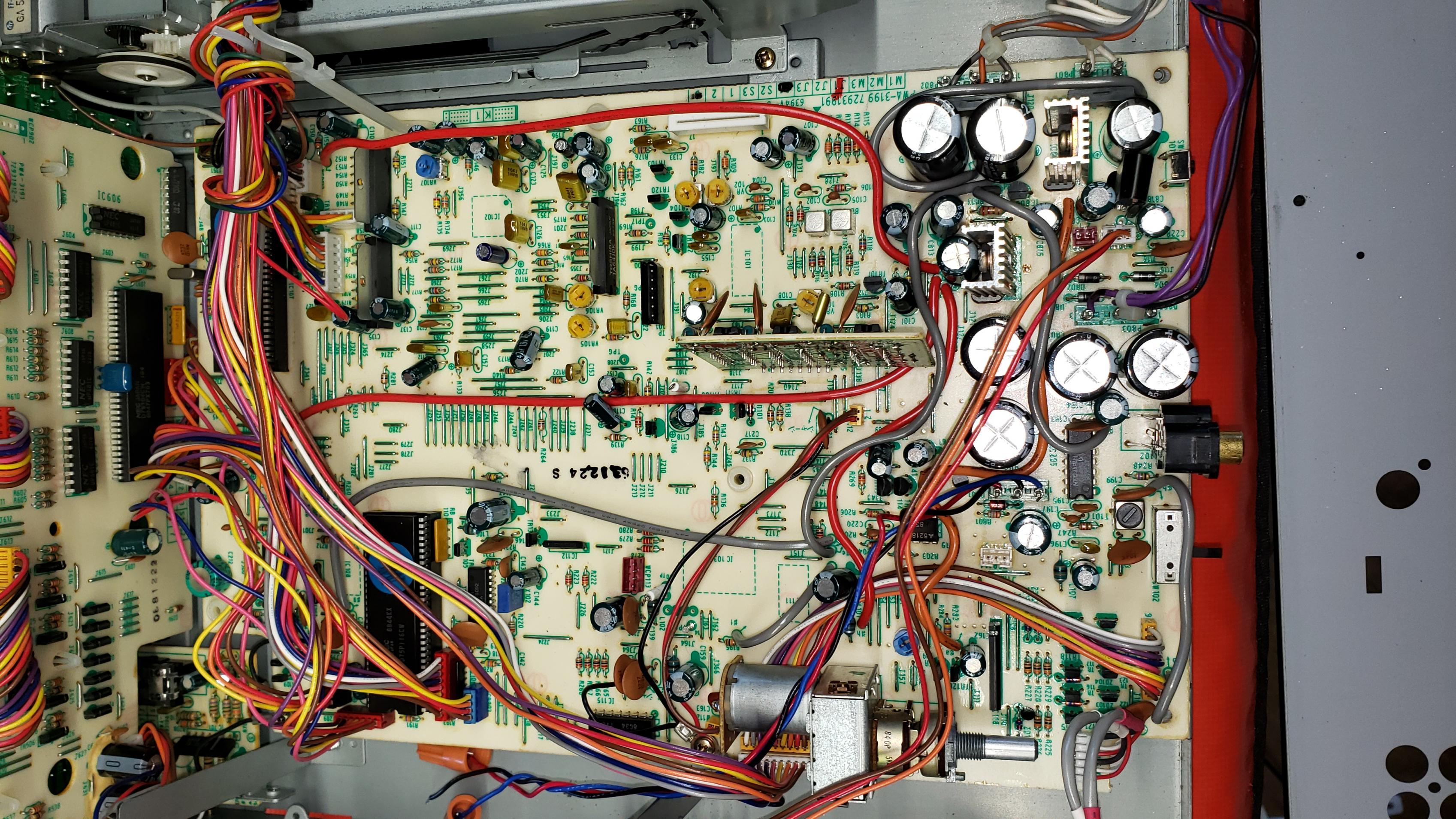

The second picture posted above shows what all was removed initially from the CDC-4A. I was no where else on that board. It is a relatively small area to look and nothing out of the ordinary. Everything went back in according to before pictures.
I have since expanded my search and found what looked like cold solder joints in a couple places which I touched up; all this after initial fault and no change.
Mark K.

The photo diode amplifiers will generate an huge offset if they lose connection with the diode(s) in the pickup. That will generate your DC offset. You won't hurt the head unless you leave it on with the big offset. The only other things it could be is death by static, or you have a solder bridge you haven't found yet. I am including the flexible PCB in as you had to move it, and it may have been damaged because of you moving it.
So, just for chuckles and grins, stick the other head into that circuit. It doesn't need to be installed, you only need to plug the flexible PC board in. If it goes "click" to one side, the fault is somewhere else and you should turn the power off to avoid cooking those coils.

I figured since there was Voltage at pins 1 and 2 of U106 and according to the Schema there should be 0V that would have been the clue to point us in the right direction but I am not very experienced here. I assumed maybe it was a transistor or capacitor but that doesn't seem to be the case if you are only concerned with the Laser Diodes which definitely points to scrap heap destiny. I am quite careful but am also quite capable of mistakes! I do observe antistatic precautions and work on an antistatic mat; also I am not a technician but a struggling diy'er.

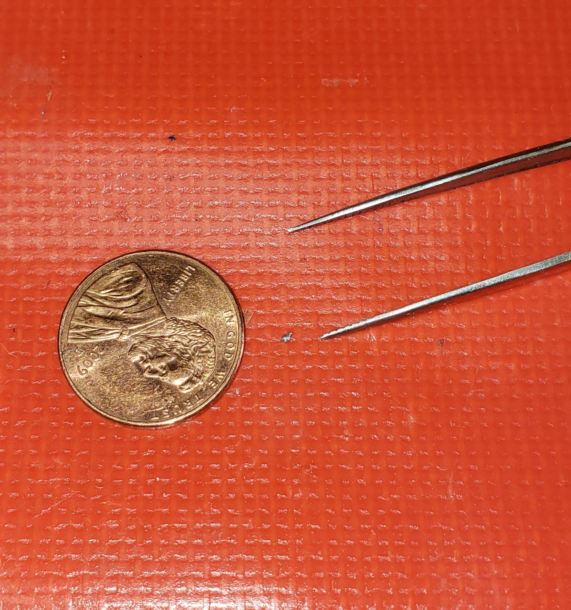

Maybe partial mystery solved! I found a small solder speck under the main board in the chassis. I'm guessing this is the culprit of what ever has happened. I am sorry I didn't catch this earlier and hope I haven't wasted too much of anybodies time. Picture below. Maybe spatter from my desoldering gun. Had to have been stuck somewhere bad and fell off with board manipulation after damage. I don't really know, I'm sort of grasping at straws here, and I've let a couple curse words fly since.

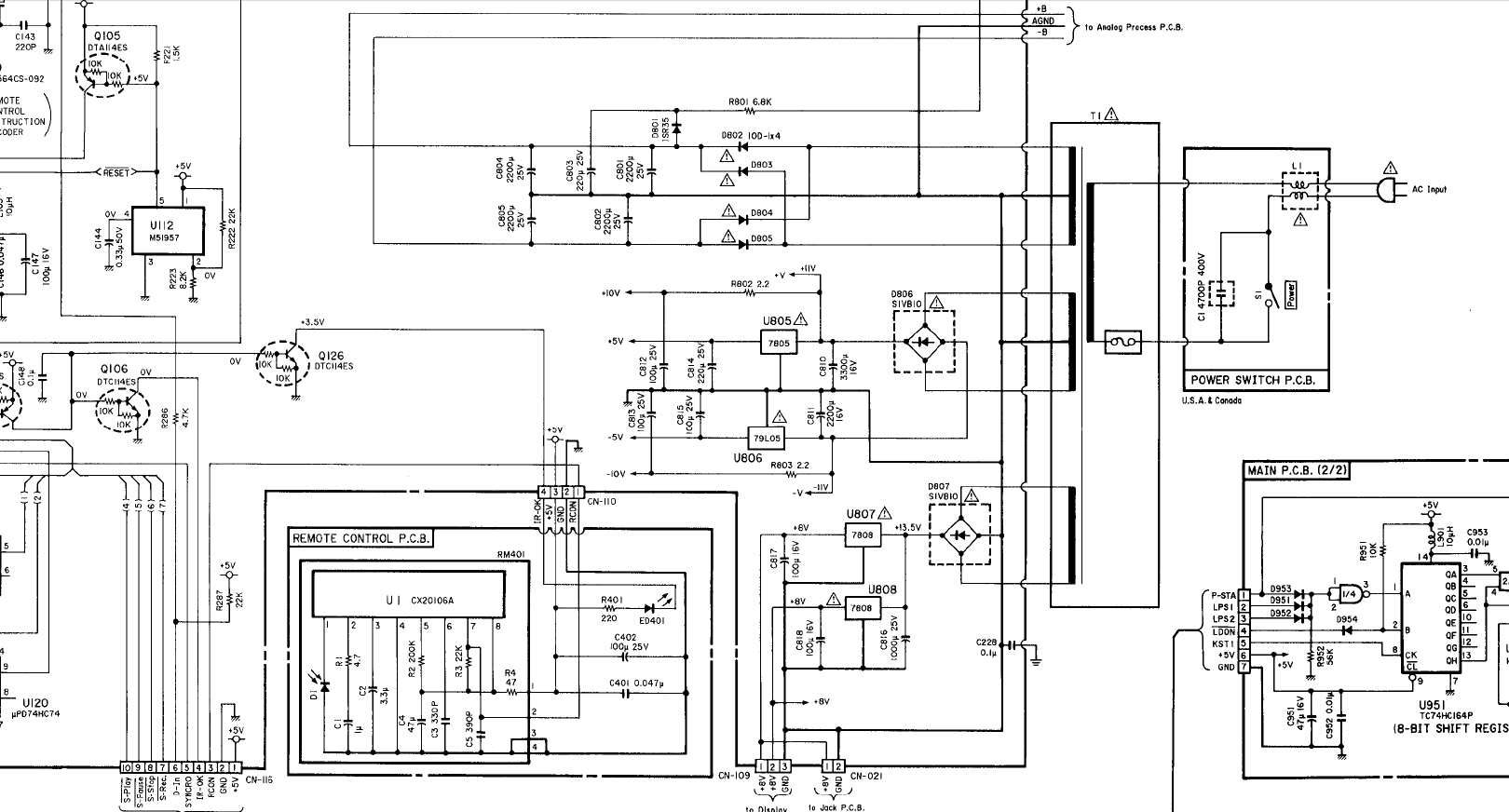

Power Supplies:
U805 output pin = 5V
U806 output pin = -4.94V
U807 output pin = 8.02V
U808 output pin = 7.9V
R802 = one leg 11.85V to 11.80V other leg
R803 = one leg -12.2V to -12.15 other leg

That speck is a little small to be problematic unless it was between the pins of a surface mount IC. What is the actual current status of the CD player?

If you look at the laser head part of the schematic in the box labeled "PICKUP AS S'Y (1/2)"? The diodes that matter to the focus servo are the squares marked A through D. The E and F diodes are for tracking (E-F balance) and tracking offset adjustments. The E-F balance is a critical adjustment, so do not touch that one. VR1 on the pickup is marked "LASER POWER". Never, ever touch this on any CD Player! You can very easily burn out the laser diode, really easy in fact. "LD" is the laser diode and "PD" is the monitor diode used to control the laser power through adjusting the laser current. If that becomes disconnected, bye, bye laser diode. Instantly.
So now you can understand the laser head a little better. The short on the flexible PCB that you solder and desolder goes across the laser diode. The head is well protected when this is shorted.
Fuses. If you put up a section of the power supply regulators, you can see symbols indicating fuses. In many products of this era, these fuses are called semiconductor fuses by some. They look exactly like a TO-92 transistor, but with two legs. There is another case for these as well. Again, they look identical to a type of transistor, and again they only have two legs. This type is a small black rectangle with a small curved section near one end (to mark the emitter end in the transistor that uses this case style. The first ones I encountered took me a little bit to find them. After that I ordered a ton of them just to have the little stinkers. The case style doesn't matter, they are interchangeable. The other type of current interruption device is a special resistor. They open when they reach a certain temperature, but they do not burn. So what that means is you may be looking at one and never know it is open. The most common resistances are 2R2, 3R3, 4R7, 5R6, 6R8, 7R5, 8R2, 9R1 and 10R0. These you have to measure with your meter as well. Remember, visually they most often look just fine.
Hopefully this helps you troubleshoot more easily. If you can, scan the section where the pickup diodes go into the chip and the focus servo and output. I'll help you through how it works.
