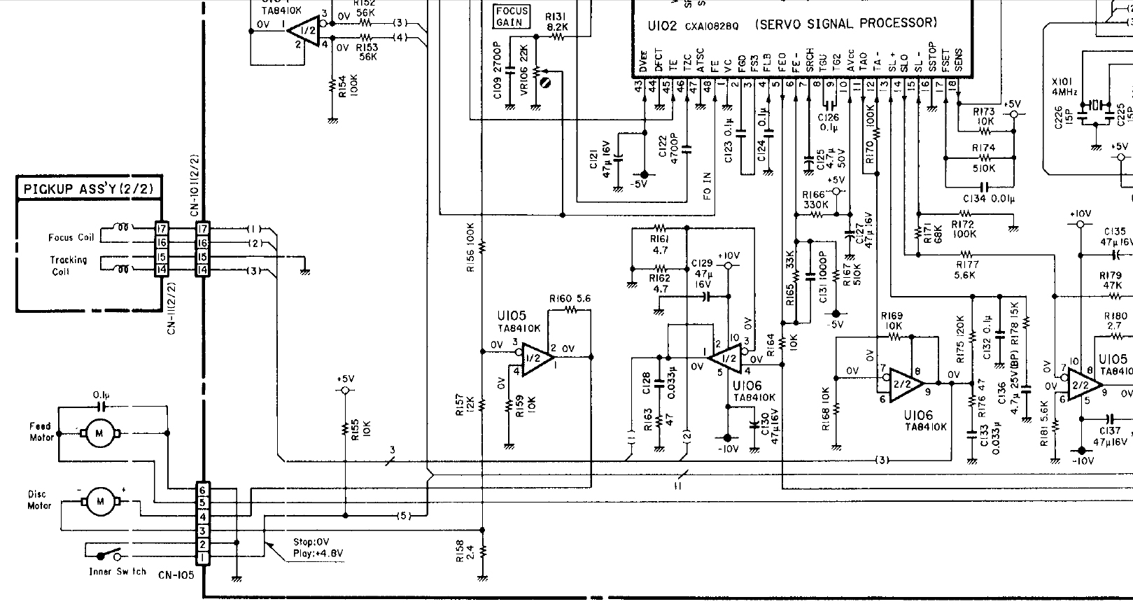

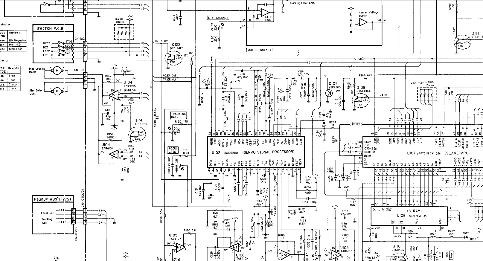

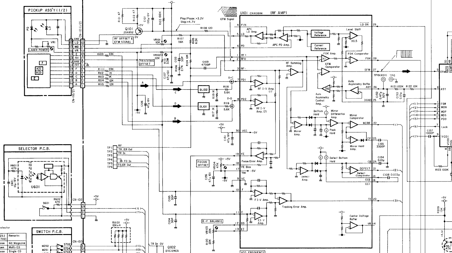

The current status of the player: Laser assembly disconnected at Header CN101. Analog process board removed. Remote control board removed. Everything else is connected.
I honestly thought I was posting info on those circuits that might be related and useful. Clearly I'm not posting useful information which I am sorry for.
I thought the Voltages I was seeing weren't supposed to be there since the Schematic seemed to indicate they shouldn't be and so I posted this info thinking it would be diagnostic.
I know better than to turn any VR and have not.
I cannot find anything wrong with the Flex cable and if it cracked somehow I can't tell under magnification. The flex cable was only removed after the ANTISTAT solder was in place and with the unit off.
Is there some way to test the diodes out of player and in a safe non-destructive way?
I posted the Power supply section in post 1. I am only seeing one fuse symbol in the primary of the transformer.
I'm guessing the unit uses resistors as fuses but not sure which ones and they are not labeled as such. I have seen in amps where they are labeled FR and some number. The FR standing for Fuse Resistor.
In the above post I included R802 and R803 before and after voltages thinking those maybe fuse resistors.
I will post some more scans of the Schematic and if you would like I can send you the entire scan in a PM or something, but unfortunately I won’t be able to try anything else for a few days but am absolutely willing to continue when I am able next week.

Okay, to understand the focus circuit, have a look at the pick-up diodes in the square (A, B, C and D). This is your signal source that generates almost everything you need except for the E and F diodes that the tracking servo uses. We can ignore those for now. So, looking at the connections for the A and C diodes, we see they are shorted together, as are diodes B and D. When the laser is centered, or focused on the CD, the outputs from these combinations is equal. As the lens moves away from the CD's surface, the spot becomes sort of like an ellipse that moves so that one set of diodes has more output than the other. This becomes the focus error signal and is filtered so that the low frequency components are processed to generate the Focus error signal that is applied to the servos. The analogue processor (IC101 inputs a current into the focus loop that works with the capacitor to generate a ramp signal that allows it to do a focus search. If it finds the CD surface on the information layer, the servo locks and the Fok line changes state. This shuts down the focus search current injection and allows the disc to spin up to speed.
The higher frequency components of the signal are filtered out and processed by the analogue processor a little differently. This signal becomes the RF signal which is further processed to become the EFM signal. From this, we extract the digital information, and also the clock. The clock signal is compared to the VCO on board and the difference between them provides the spindle (disc) motor drive. When the difference is about 50%, the motor and clock are locked up, and this allows the speed to be controlled so you get a valid data stream that doesn't underflow or overflow the FIFO memory. The data is clocked out by the system reference clock, so you get very little jitter or wow and flutter. The CD will spin close to 500 rpm in the middle (starting tracks) and it will drop slowly as you reach the outer edge to about 200 RPM depending on how much information there is on that disc. I think 74 minutes is the official limit.
Now you can see (except for the tracking servo) how the CD is locked up and information is extracted. The focus servo compares the focus signal DC level to a reference level (focus offset control) and from that generates a correction to raise or lower the lens. All these servos have a time constant to reduce extraneous noise (like the higher frequency information for example). So the signal must remain within the bounds set by the time constants. Everything outside of that has reduced amplitudes.
Thinking about how the focus search is done, it sounds as if the capacitor they use to generate the ramp isn't there, or is the wrong value. By wrong value, I mean greatly reduced from its proper value. The servo can't lock to the equilibrium state between the diodes, so the lens remains at it's limit of travel until the next search (normally three attempts). But the focus search feature is turned of and the capacitor discharged quickly, then another pulse arrives to start the ramp - which just pegs the lens again. It may look like it pegs and stays there. So I would check that capacitor. the Fok signal is on pin 28 and also a s test point maybe. Your focus error (FE) is output on pin 19. IF you look at pins 7 and 8, you'll see they go to transconductance amplifiers so that the current signal is converted to a voltage needed by the system to process. It doesn't show the current injection point for the focus search (which I was hoping to find for you).
Just for interest, the RF signal is what we normally look at to see the overall health of the system. It gives you a wealth of information about the CD player, kind of like a blood test. What you want to see is a stable eye pattern with clear eye openings with low noise.
The head in this player is a Pioneer head I think. So easy to find on the net. It isn't a rare head at all. So this player is well worth fixing.

Coming back to the fuse resistors of Mark's Nak:
Could it be that they became high resistant
but still still show the correct voltage under
the non existant load of a voltmeter?
Can't be, correct?
All the best, Salar

Hi Salar,
To answer your query, he measured the resistance / continuity of those devices. You're right about a higher load (just a meter) might allow some current to flow. But most people test in circuit with the normal load still connected. Those fuse resistors tend to look perfectly fine while being open. Even normal resistors can open without looking burned out and the only visual sign would be a small burned dot on the side of the resistor facing the PCB. Nice! Those are difficult to find, especially when the load they supply has other current paths to the supply. That can make them measure something, normally too high.
The worst ones to find are those semi-fuses that look like small signal transistors, but with only two leads. Vari-cap diodes and diacs look the same, a signal transistor case with only two leads. I have seen specialty diodes that also look like this.
With surface mount components, things are even worse as diodes are often in a SOT23 case that are absolutely identical to a transistor. I'm pretty sure there are other cases that also house diodes and other parts instead of a transistor. The number printed on the case may not help without the service manual.

Mark, I am missing in the drawings scans the circuitry leading to the focus coil.
There should be some transistors involved, shouldn´t they?
Hi Salar,
Below is a link to a scan I posted in Post 1. I believe the focus coil(CN-101(2/2) pins 16&17), voltage amplifier chip and immediately related circuitry are in this scan. If this isn't what you are asking for I can easily post more scans.
https://www.diyaudio.com/forums/att...s-coil-10v-power-supply-caps-focus-1-copy-jpg
Mark K.
