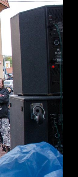

The sound guy using these came in a Mitsubishi Pajero with 4 active monitors.

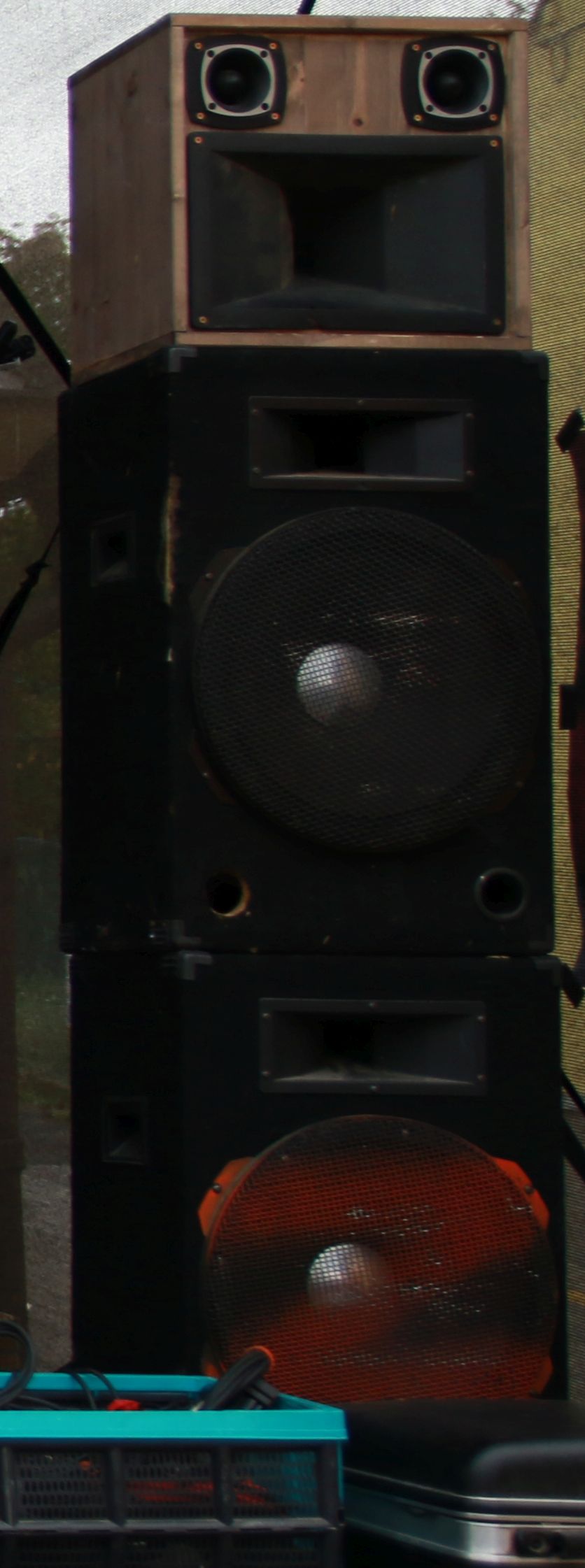

3. A homemade PA system, biamped - bass and tops had a separate amp. This one needed to be on a small trailer - but I liked especially the bass boxes - simple bass reflex with Celestion FTR15-4080FD - a single pair was sufficient even with the non-ideal placement (one on each side more or less). Last year it was with two other subs, but it worked this year really well without them.

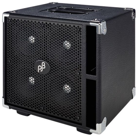

kipman725: This is the tradeoff I am willing to accept. The PA systems used in the past (the HK Audio Actor system) has a -3 dB point at 48 Hz - PRODUKTARCHIV - ACTOR DX System - HK Audio The system you posted looks really nice - if something similar would be possible with a 1x12 instead, it would be perfect.

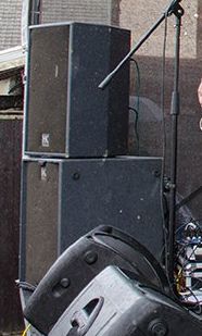

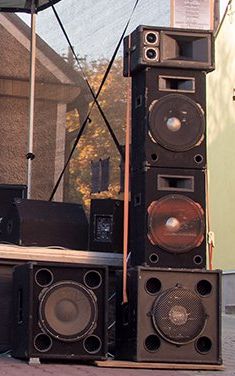

A better setup of the speakers would give a louder and cleaner sound as the setup in picture 1 is a comb filtering disaster.
Better not mix speakers putting out the same frequencies and never put top speakers (mids/highs) in the horizontal plane when they put out the same signal. The 2 bullet tweeters top box in pic 5 should never have been build.
I would leave the top boxes at home, put the speakers a bit higher, point them a bit down and put the upper speakers upside down so the horns (high frequencies) are as close as they can be.
If you play stereo; rotate the lower speakers inwards and the upper ones only a little bit. This will give the least comb filtering and the best stereo experience.
All subs should be together at a wall or be at least 5 meter (more = better) away from walls.

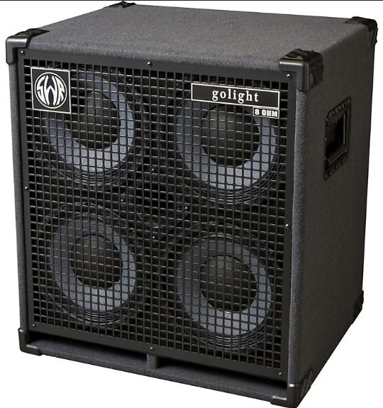

6FE200: SD = 118cm^2, xmax = 4.62 mm, $47.00 (parts express)
4*6FE200: SD = 472cm^2, xmax = 4.62 mm, $188 (parts express), Volume displaced 0.218064 litres
10FH520: SD = 321 cm^2, xmax = 7.25 mm, $267.00, volume displaced 0.232725 litres.
So pretty close to the linear displacment of the 10FH520 but lower cost and greater surface area (reduced cone excursion for given SPL), higher maximum crossover frequency. I would say it looks like a good option if that form factor suits you.
