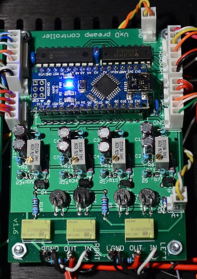

I needed a remote controlled, very high audio quality attenuator for a preamplifier that I built. After considering the various options, I decided to design my own LDR volume controller.
It took a lot of effort, but it works well now, I'm pleased with the result. I would like to share the project with the DIY community, in case someone is interested.
So, here it is:
- customizable impedance, between 5kohm and 50kohm
- customizable number of attenuation steps, between 20 and 80
- you do not need matched LDRs
- LOG attenuation curve
- you can display your own welcome messages on the LCD screen
- the firmware is easy to update and modify
- remote controlled with any Apple remote

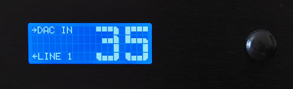

- big LCD screen, the volume level is displayed with 4-char high digits, easy to see from a distance

The Arduino is quite limited, it doesn't even have DAC outputs. But with some hacks, it can brilliantly do the job!
As said before, the PWM outputs are switched to 31250Hz, and thus easily filtered, making an 8 bit DAC. To overcome the low precision of this "DAC", the software can switch the driver MOSfets between two working ranges: low current and high current. This is enough to control the LDR current with acceptable precision.
The ADC inputs are oversampled to 12 bit (instead of the default 10 bit).
The target resistance values are computed for each LDR and each attenuation step. The code then searches for the needed current which gets the measured resistance as close to the target resistance as possible.
During normal use, the current through each LDR is permanently measured and fed back to the DAC control code in order to compensate for temperature drifts.
Talking about the precision: the controller can approach the target LDR resistance within 0.1% at 1K, 1.5% at 10K and 5% at 50K

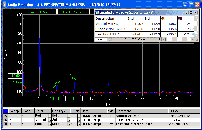

Cool design. Wondering what the benefits of LDRs are over conventional active volco chips such as the PGA2311? I remember reading that they produce a small amount of distortion as current rises through them, although I have only ever used them in instrument compressors where it's not an issue. Matching them was a bit of a pain though for stereo :( .

I did some analysis of the Silonex, Vactrol and Fairchild several years ago:

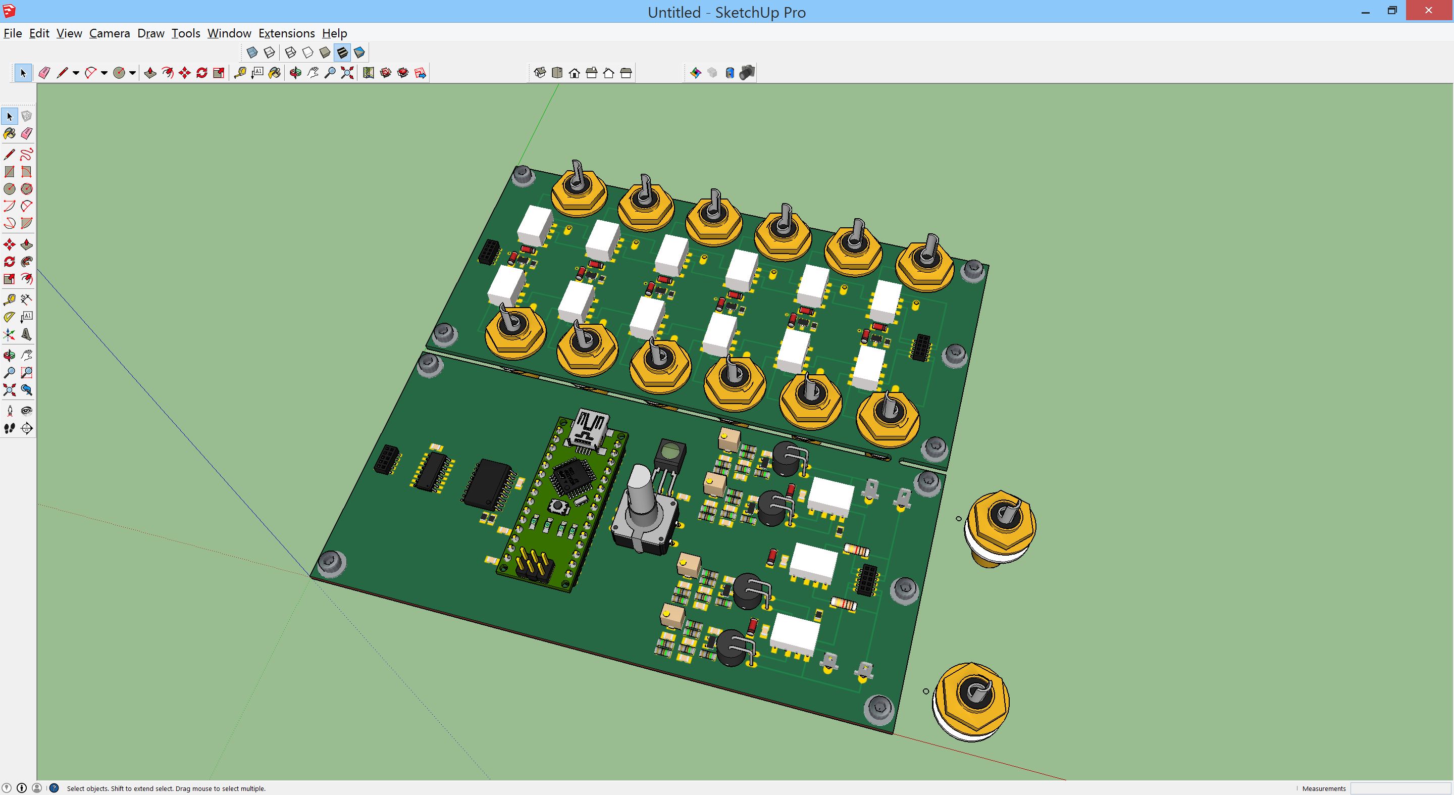

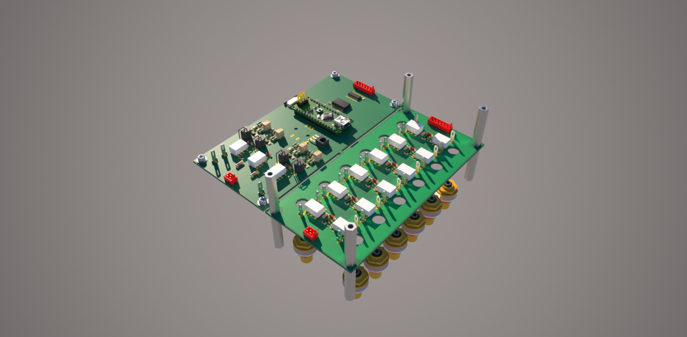

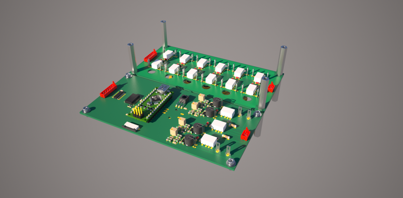

Hello Vincent,
I´ve only one objection in your design: the use of the chinese display; it is not really long term availability and for some people really hard to purchase.
My idea is to modify your design by adding a LCD touchscreen display over the I2C interface (A4 and A5 pins from Arduino): one board with µC, LDR, IO´s interconnected with a 1mm ZIF connector, or other type, to a second board with supplies and LCD (the encoder is superfluous).
The candidate for this display would be from ELECTRONIC ASSEMBLY. I´ve used successfully this type of LCD with touchscreen in military application, but sorry, I´m not programmer!
They provide also OLED displays but in this case only over SPI.
ELECTRONIC ASSEMBLY - root LCD Module
Ok, you have to do some firmware modification to implement the LCD.
I know that a lot of people will then positivelly interested in a GB...
Jean-Paul
