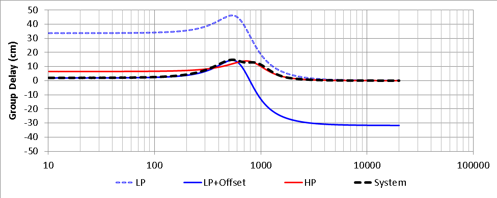

Given (3) and (4) above, a number of efforts have been made to design "quasi-optimal" crossovers that strike the best possible balance between the three goals (A),(B) and (C) (rather than only considering (A) - e.g. conventional 3rd order Butterworth, or (A)+(B) - e.g. even-order Linkwitz-Riley).
Two notable examples of "quasi-optimal" crossovers (5) are the ones developed by SPICA and by Jean Michel LeCleac'h (filtrage).
Both of these "quasi-optimal" crossovers use a physical offset between the physical acoustic centres of the Woofer and Tweeter to try and align their respective emissions over broad portions of the audio band.

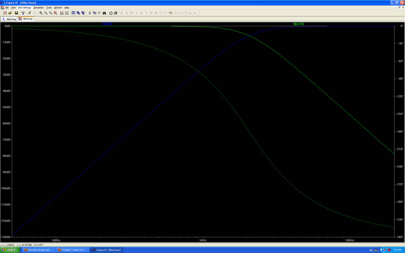

The SPICA crossover uses a 4th order Bessel low-pass at Fx (+ polarity) and a quasi-first order high-pass at Fx (+ polarity), with an Offset = 0.435*c/Fx.
Unfortunately, the 1st order HP is often too bland to be usable with real Tweeters, especially of the horn-loaded Compression Driver type that I pefer.

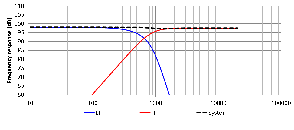

The JMLC crossover uses instead a 3rd order Butterworth low-pass at 0.87*Fc (+ polarity) and also a 3rd order Butterworth high-pass at 1.15*Fc (- polarity), with an Offset = 0.22*c/Fx.
Below are simulations of the frequency response, phase and group delay of this type of crossover for Fx = 650Hz (attachments 1,2,3)
Overall, this is a much more practical solution than the SPICA one, and has been reported to work quite well by a number of users. However, the physical offset between the physical acoustic centres of the Woofer and Tweeter is rather small, and I have found that in the case of a system composed of a large-diametre Woofer and a compression driver + horn, for typical Fx values the horn ends up sticking quite a bit out in front of the Woofer cabinet.
Also, the phase match between Woofer and Tweeter (goal B above) isn't all that good, really, which results in a relatively poor polar response (this is often considered relatively unimportant by the proponents of the JMLC method, who typically listen on axis in the near field).
Finally, the group delay of the Woofer does not match that of the Tweeter at Fx, leaving the two units to emit from non-coincident positions at this important frequency where their output intensities are equal.

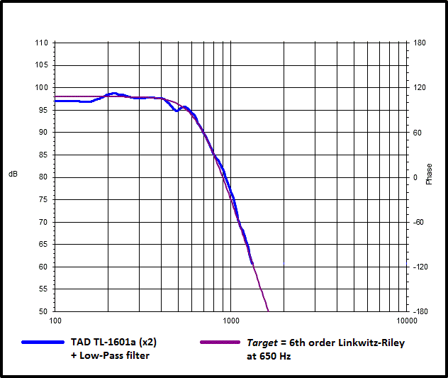

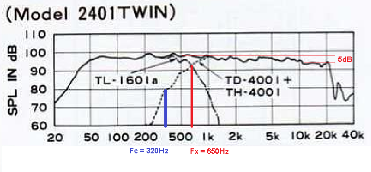

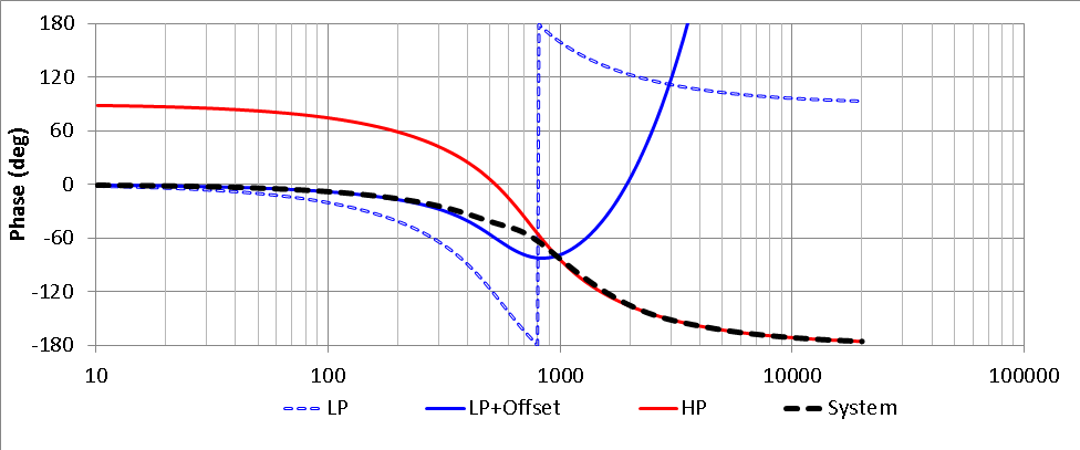

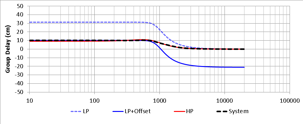

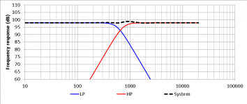

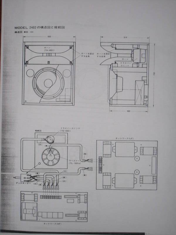

One (passive) crossover that always intrigued me and that has developed a bit of a "mythical" aura in some audio circles is that which was used by TAD in their professional monitor models 2401 and 2402 (attachment 4).

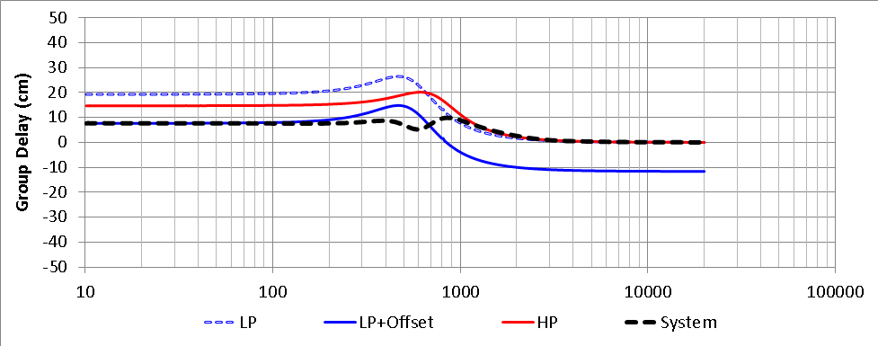

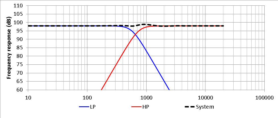

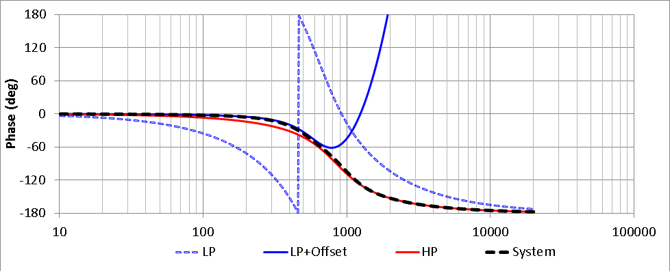

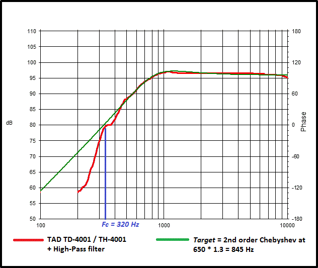

By reverse-engineering the published frequency response plots for the 2401 model (attachment 5), and measuring the approximate physical offset between the Woofer's dust cap and the compression driver's diaphragm, I was able to work out the following design criteria for this crossover type:
Woofer: 6th order Linkwitz-Riley low-pass at Fx (+ polarity) (attachment 6)
Tweeter: 2nd order Chebyshev (Q=1) high-pass at 1.3*Fx (- polarity), attenuated -2dB (attachment 7)
Offset = 0.6 * c / Fx

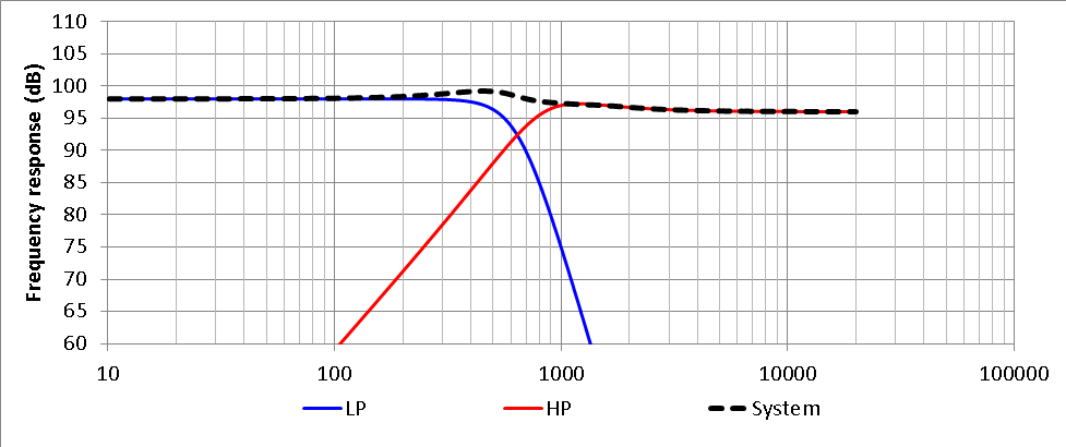

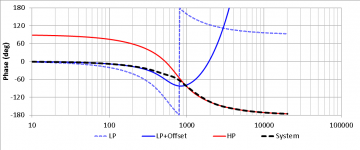

The resulting simulations of the frequency response, phase and group delay of this type of crossover for Fx = 650Hz are illustrated below (attachments 8,9,10).
Well, I must say I quite like it! :)
This "TAD-style" crossover clearly belongs to the "quasi-optimal" family, and exhibits a nice set of desirable characteristics, namely:
- smooth frequency response
- excellent phase match up until Fx (expected good polar behaviour)
- almost perfect group delay match at Fx, and smooth overall group delay curve, with both Woofer and Tweeter emitting from almost coincident positions over most of their respective pass-bands (i.e. very good "time alignmnet")
- conveniently large offset, which greatly facilitates the physical positioning of the Tweeter horn with respect to the Woofer box
I am posting all this in the hope that others may find it useful, too.
Comments are welcome!

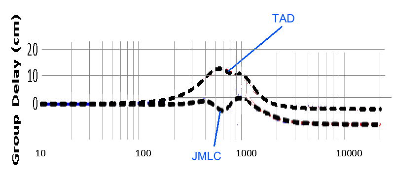

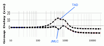

Hello,
I don't find the group delay curve of your TAD simulation very convincing.
Here is at the same scale the 2 group delay curves on the same graph for better comparison.
With more than 15centimeters variation of the equivalent group delay from 20Hz to 2000Hz, I would not say this TAD crossover is a quasioptimal crossover!
Your remark of the JMLC crossover probably give a bad lobing is neither convincing as one of the purpose of the JMLC quasioptimal crossover being to obtain the waves emitted by the bass and the medium being to be quasi in phase...
Best regards
Jean-Michel Le Cléac'h
Dear Jean-Michel,
thank you for your reply.
First of all, let me clear up that in no way was my post meant to discredit your work on quasi-optimal crossovers, or to downplay in any way the quality of your approach per se.
I just wanted to report on my "reverse-angineering" studies about the TAD variant, and compare the two.
Specifically, though, I beg to differ about your interpretation of the comparison of the two Group Delay curves. The JMLC crossover leaves the Woofer and Tweeter to emit most of their respective pass-bands from clearly non-coincident apparent positions (respectively approx. +9cm and 0cm); also, the two speaker units have different Group Delays at the crossover frequency (650Hz in this example).
The TAD crossover, on the other hand, does have a "hump" in the total Group Delay curve in the vicinity of Fx, BUT it ensures identical Group Delays of Woofer and Tweeter at the crossover frequency, AND almost identical Group Delays of both Woofer and Tweeter over most of their respective pass-bands.
I have not had the chance of listening to otherwise identical systems employing the JMLC vs. the TAD crossover, but based on the simulations I SUSPECT that the TAD one just MIGHT sound better, that it all.
Marco

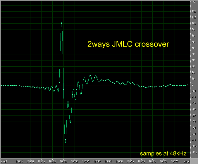

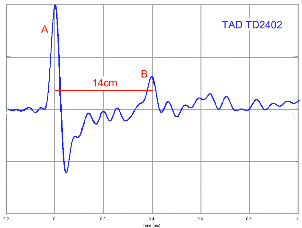

Hello,
You'll find here attached 2 screen copies. The first one shows the impulse reponse (IR) of the TAD TD2402 and the other one is the measurement of the IR of a 2 ways using nearly the same loudspeakers but with a JMLC crossover.
As you can see there is a 2nd pulse on the IR of the TAD TD2402 around 0.4ms (equivalent distance = 14 cm) fully explained by the group delay curve you shown to us.
Best regards from Paris, France

Hello Jean-Michel,
Well, y wonder how jou got such a big second echo impulse !
My results taking in acount this filter , even +/- aproximative, are,
as you can see, quite different.
Hello Jimbee,
The response of the TAD TD 2402 is taken from the firts link here (green frequency response curve) :
http://2.bp.blogspot.com/-HttNapLF7gA/TbjIKSwG56I/AAAAAAAACZA/Fi1_W0NDCnE/s1600/diffraction+horn.png
http://4.bp.blogspot.com/-3wCe1MaSJ...9%E5%85%A8%E9%A0%BB%E7%B7%9A%E6%80%A711ms.png
Both 2 measurements show that second peak,
May be it is due to some inner reflection in the TH4001 horn though.

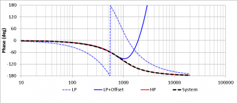

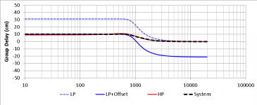

More simulations, and possibly an improvement
Hello,
In response to some insightful comments made by Jean-Michel Le Cléac'h (here and on other French-language forums), I have made new simulations trying to further improve on the TAD crossover.
This is what I have come up with:
- Woofer low pass: 6th order Bessel at Fx * 1.25 (-6dB of attenuation at Fx)
- Tweeter high pass: 2nd order Butterworth at Fx * 1.3 (-6dB of attenuation at Fx)
- Offset = 0.4 * c / Fx
The result is even better phase match and a smoother Group Delay curve, still with a practical offset between Woofer and Tweeter.
Comments welcome.
Marco
