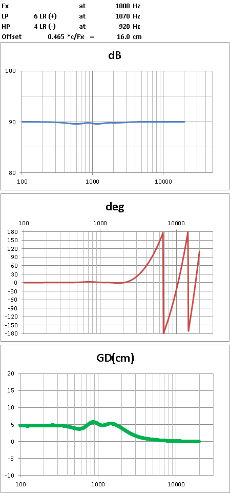

Hello,
One maybe other interesting target to get large offset would be matching LR6 low pass and LR4 high pass. Phase match is so so , curves cross at -4,6 dB, but group delay is rather constant and axis response is in 0 dB / -0,4 db:
Low pass : LR6 at Fx * 1,07
High pass : LR4 at Fx * 0,92 , -phi, delay : 0,465 c/ fx

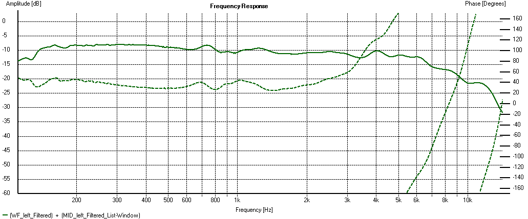

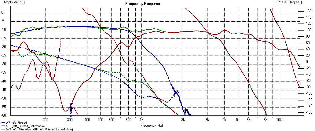

Incidentally, it can sum pretty hard with the low pass section crossover, giving dips (often not desirable) in the resulting overall impedance curve.
Using a Butterworth_24 passive on the LP and the hand tweaked 4th order Linkwitz on the HP gives a fairly low impedance at sum, where the 2 lines meet for quite a long time :
- in red, LP Butt_24@700Hz (includes speaker, Zobel, and XO components)
- in blue, HP Link_24@700Hz (includes speaker, LPAD, and XO components tuned to get -6dB@700)
- in black, resulting electrically summed response and phase ( seen by the amplifier )
I can also try to match a LP Link_24 with the actual horn section (acoustical Bessel_18), perhaps slightly different offset to find 😉,
but impedance curve of the LP will be more regular and go up sooner in the frequency domain,
leaving an overall nicer impedance curve :

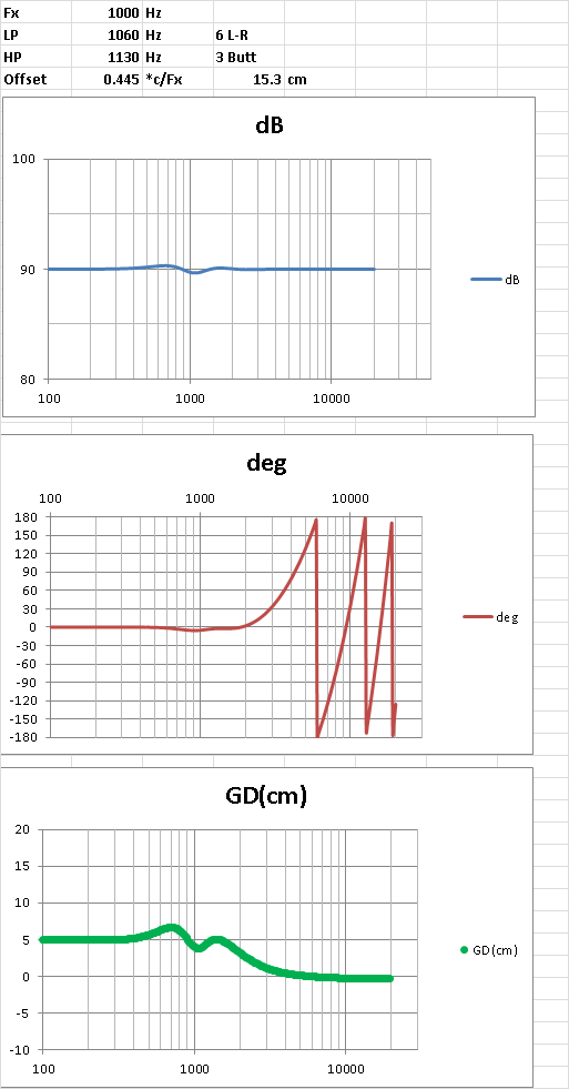

Hello nAr,
"I wouldn't want to be rude, but I think 3rd order on the high pass would be most desirable, with passive xo ... "
If you want a 6-3 there is a way near Marco's formula :
Low pass : LR6 at Fx * 1,06
High pass : Butt 3 at Fx * 1,13 , -phi , delay = 0,445 c/Fx
good axis response ( + 0,3 - 0,3 dB ), curves cross at -4,6dB :

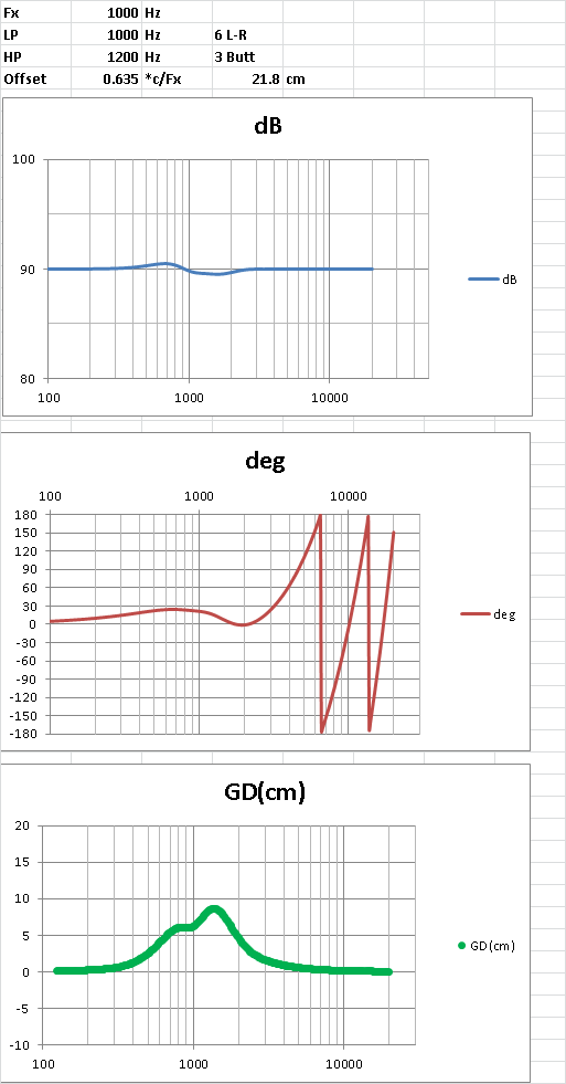

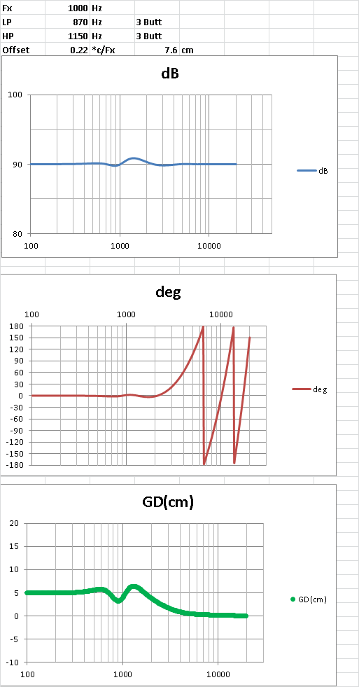

So, to recapitulate, here are the simulations of three of the crossovers discussed in this thread:
(1) JMLC's original Butt 3 + Butt 3
(2) My TAD-derived LR 6 + Butt 3
(3) Jimbee's tweaked LR 6 + Butt 3
It seems as if (1) and (3) present the smoothest phase and GD curves, with (3) affording a double offset vs (1); (2) gets one the most offset, but at the cost of a relatively bumbier phase and GD...
Thank you Jimbee!
...and (4) Jimbee's LR 6 + LR 4:
as good as (in fact, slightly better than) (3), and with a slightly larger offset - bravo!

UPDATE: real measured results
...Finally, here's the measured response of my newly realized filter of this kind (Woofer LP 36dB/oct LR + Horn HP 24 dB/oct LR à la Jimbee 😉), with Fx = 900Hz (as you can see, the horn is also low-passed at 7kHz, as in my case a Tweeter then takes on the last 1.5 octaves after that).
Please note the excellent ensuing linearity of the overall (Woofer+Mid) phase response till almost 3 kHz (second attachment): indeed, a "quasi-optimal" result!
Kind regards,
Marco
Kind regards,
Wow ! This just confirmed this is a filter I want to try. Many thanks!
How does it sound?
Well, it sounds real good to me 🙂 (But then, "beauty is in the eye of the beholder" - or the listener in this case, isn't it? ;-))
...more seriously: it does seem to me to produce a commendable cohesiveness in the sound across the whole frequency spectrum (in fact, rather impressively so, given the visual discontinuity between the large 15" woofer and the relatively small 1" horn). It also gives a very focused virtual image, not unlike that of a good full-range driver.

To recapitulate
For the record, here's a list of "approved" 😉 “quasi-optimal” crossovers in order of increasing offset:
3rd order Butterworth Low Pass, -3dB @ Fx*0.87 (+)
3rd order Butterworth High Pass, -3dB @ Fx*1.15 (-)
Offset = 0.22*c/Fx

6th order L-R Low Pass, -6dB @ Fx * 1.06 (+)
3rd order Butterworth High Pass, -3dB @ Fx* 1,13 (-)
Offset = 0.445 c/Fx
6th order L-R Low Pass, -6dB @ Fx * 1.07 (+)
4th order L-R High Pass, -6dB @ Fx * 0.92 (-)
Offset = 0.465 c/Fx
Offset = 0.22*c/Fx
Offset = 0.445 c/Fx
Offset = 0.465 c/Fx
