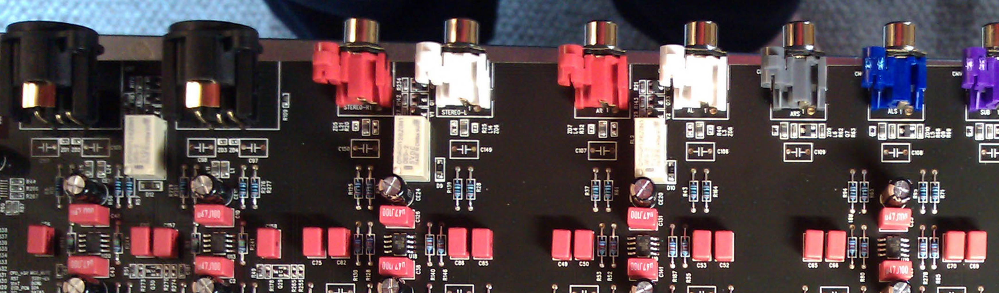

Oppo has come out with only few pictures of the boards of BDP105.
A preliminary examination of the inside pictures it shows that Oppo used a high performing chip op amp for headphone stage. This chip can run up to 2-3W, so is not any problem to drive the most of the headphones. The lowest driving impedance of this op amp is 8 ohm. One can see the placement of this stage on the analogue board here by. It looks to me that the headphone op amp is DC coupled to the output (through resistors)... I`m almost sure now that all the other outputs of the BDP105 are AC coupled. It seems that is planted a large capacitor on the signal output path on each channel! This surprising me very much, and I think is very unfortunate...
It seems to me that the DAC chip itself is used in a different way than in the earlier model (95). A short clarification about the ESS9018 DAC chip: this chip have 8 independent DAC channels inside. Those channels can be connected (hardware) together (2, 4, 6, 8) When all the 8 channels are connected in parallel (for only one stereo channel), one have the max accuracy of the resulting signal. 8 DACs working together and output the same signal (one may use two ESS9018 to have a LR stereo in such case). In stereo configuration of one DAC, are used 4 + 4 channels connected together for max accuracy. Multichannel configuration use all the 8 channels independently.

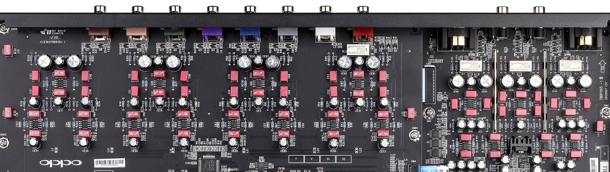

In the BDP 95 model, the stereo output were obtained from 4 + 4 channels (4 channels connected together). This assured max accuracy for the stereo signal in BDP95 model. In the upcoming BDP105 it seems that Oppo used a configuration for ESS9018 which assure 2+2 channels for balanced/unbalanced output, and 2+2 channels for headphone output. I`m not very sure about the allocation is strictly in this way, but is very sure to me that the Sabre chip is hardware divided between RCA/XLR output and headphone output.
Personally I`m quite critic to this design. I should want that one could have the possibility to use 4+4 channels of the chip for both (switching) normal out and headphone out. This way could assure the max accuracy in both cases. When one use the headphone is no any reason to have half part of the DAC chip hardware dedicated to another output which is not in use, and opposite. This judgement is made as a consequence of what is to be seen in the high resolution inside picture of 105 model. Oppo are welcome to correct me if I have seen wrong in the picture, or to precise more on this aspect...

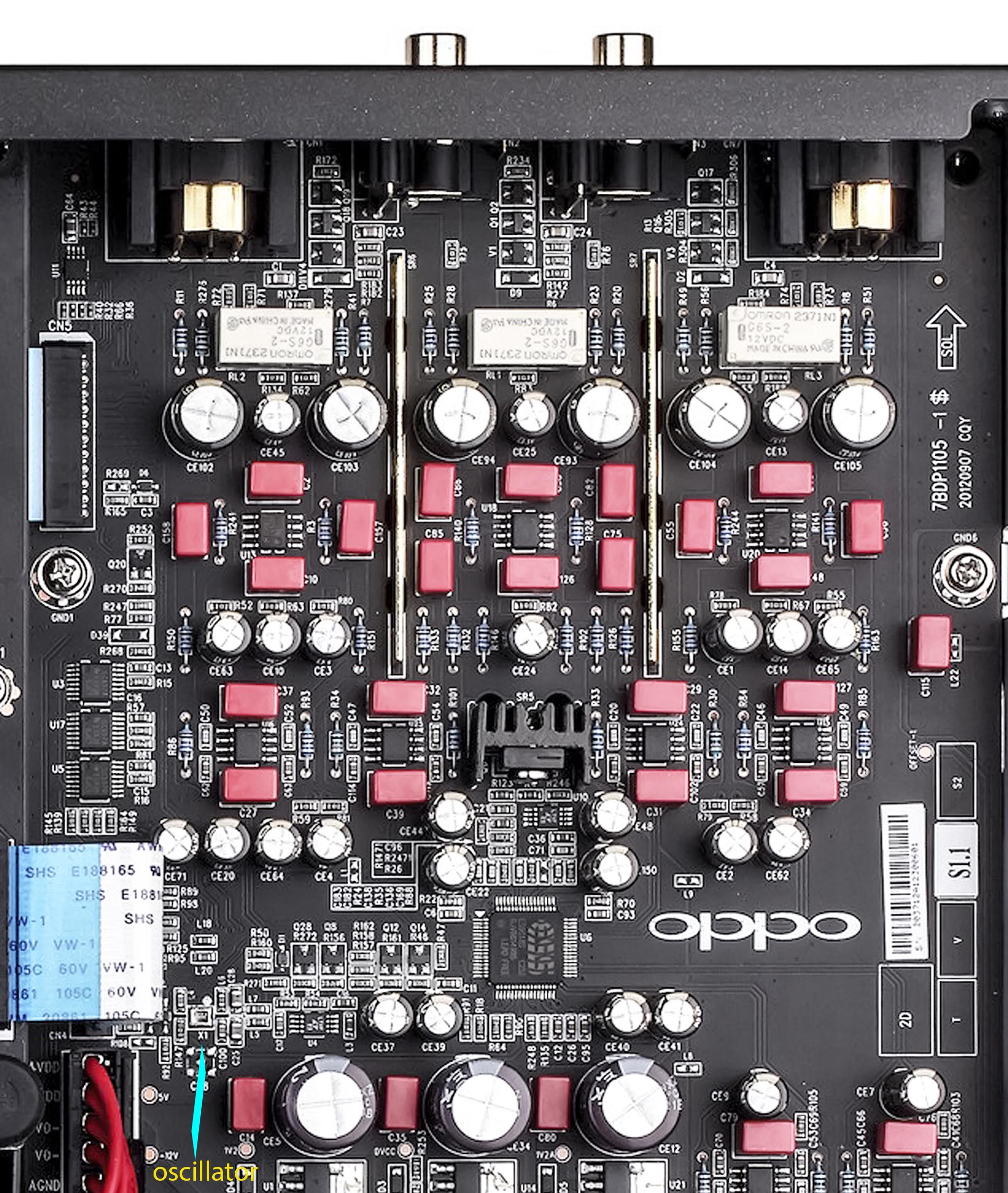

Some (detail) pictures of the board(s) of BDP105 (published by Oppo)

I think I have now an explanation about why Oppo has chosen the AC coupling on all the outputs of the 105 model (if this coupling will be confirmed at last). They could not control in production process the 0v DC offset at the output of the final op amps. An 0v DC offset is very important to assure the high performance of the channels amplifiers (in an DC coupling). An high DC offset before the output capacitors, do not necessary mean that the final amplifier stages work at high parameters... and the useful audio signal which goes through the AC coupling is at very high quality one...
But everything was fine for the 95 model, where all the channels were DC coupled, and the DC offset were in acceptable low limits. The AC coupling choice for the 105 model as a solution against a high variation of the output offset, or the difficulty to control this parameter in production process, it may be a consequence of choosing another type of op amps in 105 model, than it were used for BDP95, lower quality of the passive components, or the opamps in 105 are of a lower quality/parameters ones, and of course cheaper... Both those alternatives are not something positive for Oppo and for the new/upgraded player model...
To control by design and then in production the offset of output channels for an DC coupling, it may not be a difficult task for some professional designers. The datasheet of the ESS9018 itself recommend some solutions to well control the output opamps offset. At Oppo has chosen an old fashion coupling, which is definitely a low quality one, for outputting the audio signal, it seems to me that they were forced to do so, by a bad (again) electronic design in this analogue area, or because of economic reasons (a lower quality components from an accepted provider). The economic reasons mean in this case that they want to invest less and sell the final product for more... If this hypothesis it will be true, then it may not "sound" quite well for Oppo`s reputation...
Back to the DAC channels allocation problem, and the downgrade for the 105 model (comparing to the 95 one) in stereo stage.
Oppo could proceed to a very real and effective upgrade if they should use an double DAC mono configuration (one ESS9018 for each stereo/headphone channel stage). This mean that all the 8 DAC channels will work for one of the stereo channels. In this way ESS9018 deliver the max of 133/135 dB dynamic. Such design would be very possible on the same board, and sure enough, with the same software (or very small changes). I can not see that such configuration should have a very important impact on the final price of the player. It may be in to the same 200$ over the 1000$ price of the former model... The ESS9018 chip it cost 60$ when one buy one or few chips. If a big producer as Oppo buy thousands of such DAC chip for a big production, then the price it may decrease very much. I can not see that using one DAC chip more in this new player could be a economical problem and big impact for the final price of it...
Those problems which come out in the case of the 105 model, and another ones which were for the 95 model too, an stated upgrade which it looks in real more like an downgrade (for the analogue stereo stage) in the new model, it make me a quite low impression about the electronic (analogue) design department of Oppo...

Even though BDP105 have already some design problems, I think it have some advantages too, over BSDP95 when about modification possibilities. It is more modular, and one do not have to handle with a very big board as in 95 model. The fan less is also another advantage. The analogue PSU it seems to be another big advantage. But I do not know much details about this new PSU in 105. I just think it may be better (the toroid transformer is already)
It may be more easy to take out all that capacitors on the outputs and realize a DC coupling (maybe it will need better final opamps...).
But it could be a problem with those DAC 2 channels which are grounded... Here will be necessary a big mod... But I`m not very sure about the firmware how will handle with those 2 grounded channels, if one will want to use it....
As a conclusion, my option will be at last the 105 model...

About the capacitors (AC coupling), I think is just wasting time and money with upgrading to another ones. Those capacitors do not have to be there!
Just remove all and establish DC coupling.
Oppo explanations it seems to me as stupid or misleading. They justify the AC coupling with few cases when were reported (maybe) problems because offset at the input of those types amplifiers ???!!!
A whole production and design of a new player model is adapted to only few cases where an amplifier input offset have disturbed the DC coupled output of the plyer.... This it looks to me as very strange.
We know all that BDP95 have an DC coupling and is very well this way. So it have to be! If Oppo should mount an load resistor at the end of the DC coupled output it will prevent any offset caused by the next connection to that output. Not AC coupling is the solution!
As a conclusion, I will suggest you to forget the upgrading of the output channels capacitors on BDP105 (when you will have it). Just remove it all.
You may check first if your amplifier have no any offset on its input (this is not usually at all!). You may also check (before this operation) if the offset of the final opamp (before the AC coupling) is at the reasonable level (best 0,0V). About just this I doubt seriously: that Oppo have succeed to have out of production lines an final stage opamp with 0v offset. It looks to me that that because they chosen AC coupling, to fix out the high offset at the final opamp in DC coupling, for this new model of their player...
But the final conclusion will be when we will have that player on the bench....
