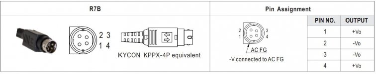

Follow the color wiring diagram. The DC power conn has six pins, and two of those are connected to the chassis and cable shield. The connection to the chassis is made on the small power filter PCB.
The dc power panel connector has 4 pins that you solder wires to as well as a "pin" on either side of the connector. Look at 6L6's guide and you will see what I mean.It looks like the pins on either side may be for soldering the connector to a circuit board.In addition it looks like they are attached to the metal sleeve in the panel connector.If that is the case I checked online and the MeanWell plug metal sleeve is attached to the negative(2) pins of that plug,i'm not talking the panel connector,i'm talking the male plug on the power supply.You can go online and check,it states the sleeve is connected to the -ve pins.So if you try and connect one of those "outer" pins on the panel connector to the chassis you will have shorted out the thermistor due to the 2 negative plug pins being connected to the plug metal barrel. I'm not sure why the color wiring diagram shows those pins being connected but don't do it.If anyone has followed that diagram then there should be a warning notice put out.
I was curious about this also, and I appreciated your previous posts. I did not want to disagree with your "red herring", when I think you were/are onto something. I can confirm with a DMM and the attached that the "tabs" once the male plug is inserted are continuous with -Vo and mains earth.
Per the attached schematic below showing that the thermistor is between chassis GND and -Vo, (and also verified with a DMM), I believe you are correct. Thus, I chose to leave out that section of the wiring until it was 100% confirmed that I was not shorting the thermistor.
Everything from me... should be taken with a grain of salt as a newcomer to electronics, but that is how I thought it through and how I came to the conclusion and thus the choice I made for my personal build.
BTW - It makes LOVELY music, and I haven't shocked myself into oblivion by leaving out that specific wiring.
Ok,thanks for verifying this.So then the wiring diagram should be modified or people made aware NOT to connect those tabs to anything ,which is what 6L6's picture shows but is in disagreement with the wiring diagram.
EDITED* PERSONALLY GOING TO WAIT AND SEE ON THIS, SOUNDS LIKE IT'S NOT A BIG DEAL (TO NOT ADD IT).
Per Nelson:
“Probably we should have included a lug.
Doesn't have to be done, but it's good practice to make that connection, even
though the power supply meets international isolation safety requirements.”
If you look at the filter schematic and with the info I have just presented then if you follow what you have posted then you will have shorted out the thermistor,its a mistake.
