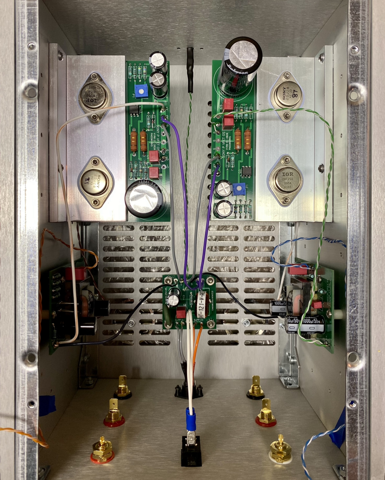

The way the hole pattern is used, you can move it all the way back and have the inputs face the RCA Jack, or you can mount next to the OS and input is facing OS. I grappled with both, then decided for the option closer to OS (but flipped and mounted with two screws)
I flipped and mounted mine all the way to the back. It seemed like that was the way it may have been designed, so I just rolled with it. A bit snug, but it all fits nicely.

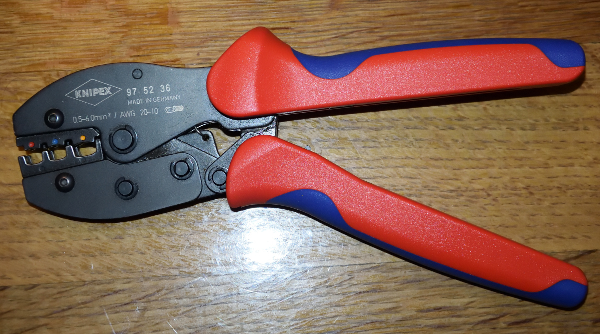

About crimping and crimp tools I use this one which has always worked perfect if the correct gauge wire is used for the crimp connector. The crimp connector must have the correct DIN specification (or another similar norm). The best crimp connectors are those has has a built-in copper ring as copper will harden during the crimp pressure.

Pro tip: On the subject of crimping vs. solder connections, one should always use one or the other connection technique; never both. It's a myth that doing both is better.
A good crimp connection is generally more reliable than a soldered connection, since a proper high-pressure crimping tool will achieve a gas-tight "cold weld" between the crimp-on ferrule and the wire metal. This not only achieves a very low connection resistance, but keeps out environmental contaminants which might corrode the connection. The crucial factor is using the right tool - I highly recommend using a ratcheting-cam type crimp tool in order to get adequate leverage & force at the die to make a proper connection. Inexpensive rigid plier style tools can be inconsistent, and many users don't apply enough force.
Unfortunately, if you attempt to solder an already crimped connection, you're likely to do more harm than good. The application of heat will relax the stresses in the crimped metal which are holding the connection tightly together, degrading the crimp strength. Further, the solder is unlikely to properly penetrate the full mating region, whilst intrusion of fluxing materials which cannot be cleaned out into the small gaps opened up by the thermal expansion of the two crimped metals introduces active chemicals which can lead to premature corrosion. For this reason, crimp+solder connections are generally forbidden by code / regulation in many if not all safety-critical applications.
Solder by itself is also a perfectly fine connection technique, and one which is easy for us DIY-er's to accomplish (and inspect) with good consistency. However is widely recognized as less reliable than a properly-executed crimp (though probably not enough to matter in our use cases, so long as you can solder with enough skill to avoid cold joints).

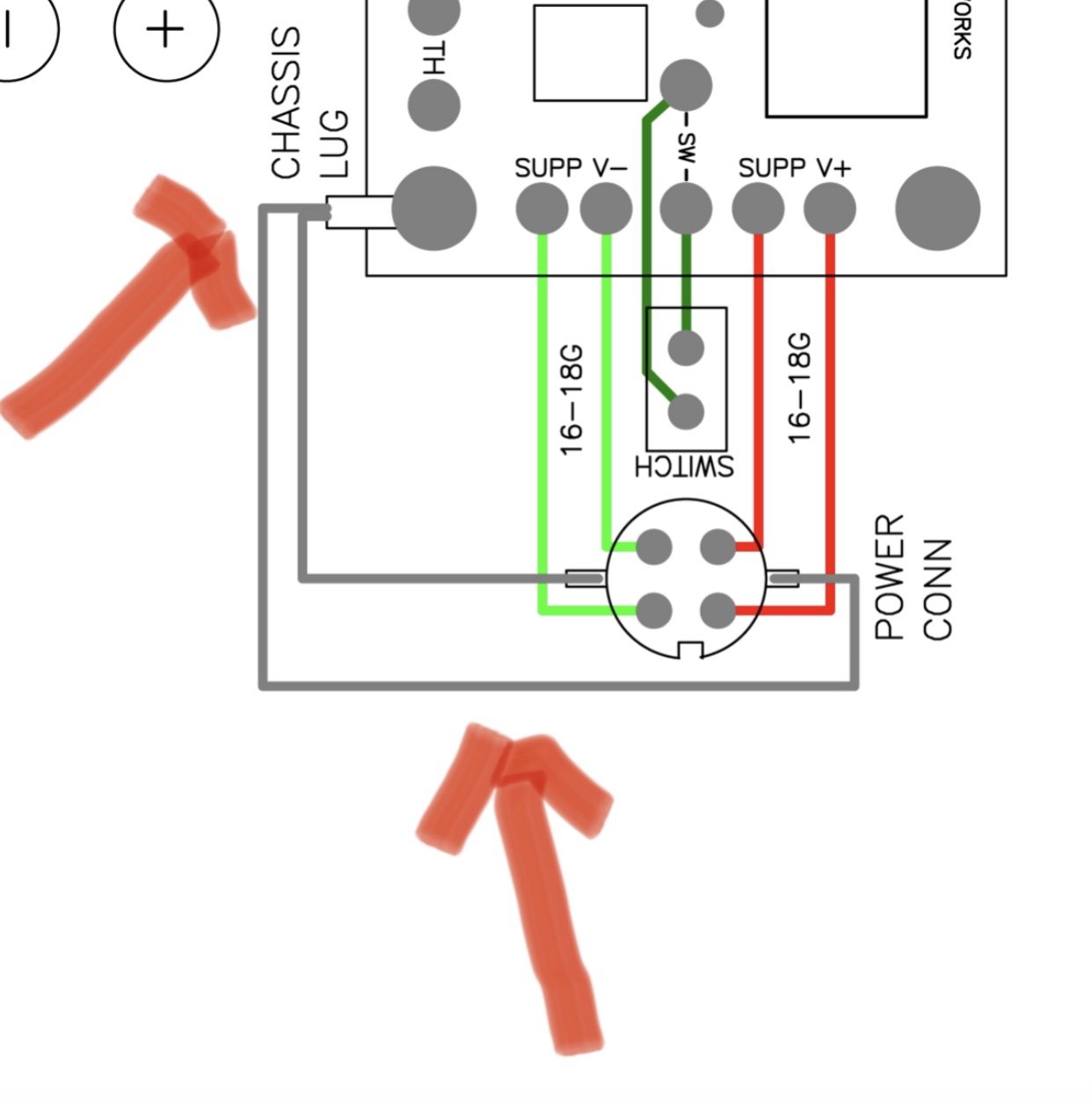

Follow the color wiring diagram. The DC power conn has six pins, and two of those are connected to the chassis and cable shield. The connection to the chassis is made on the small power filter PCB.

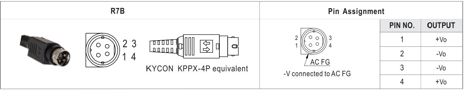

The dc power panel connector has 4 pins that you solder wires to as well as a "pin" on either side of the connector. Look at 6L6's guide and you will see what I mean.It looks like the pins on either side may be for soldering the connector to a circuit board.In addition it looks like they are attached to the metal sleeve in the panel connector.If that is the case I checked online and the MeanWell plug metal sleeve is attached to the negative(2) pins of that plug,i'm not talking the panel connector,i'm talking the male plug on the power supply.You can go online and check,it states the sleeve is connected to the -ve pins.So if you try and connect one of those "outer" pins on the panel connector to the chassis you will have shorted out the thermistor due to the 2 negative plug pins being connected to the plug metal barrel. I'm not sure why the color wiring diagram shows those pins being connected but don't do it.If anyone has followed that diagram then there should be a warning notice put out.
Joined 2019
I was curious about this also, and I appreciated your previous posts. I did not want to disagree with your "red herring", when I think you were/are onto something. I can confirm with a DMM and the attached that the "tabs" once the male plug is inserted are continuous with -Vo and mains earth.

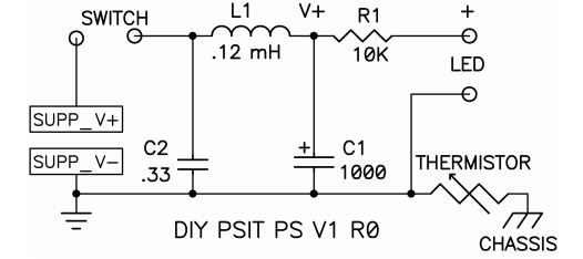

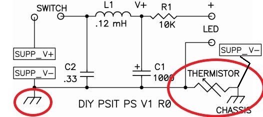

Per the attached schematic below showing that the thermistor is between chassis GND and -Vo, (and also verified with a DMM), I believe you are correct. Thus, I chose to leave out that section of the wiring until it was 100% confirmed that I was not shorting the thermistor.
Everything from me... should be taken with a grain of salt as a newcomer to electronics, but that is how I thought it through and how I came to the conclusion and thus the choice I made for my personal build.
BTW - It makes LOVELY music, and I haven't shocked myself into oblivion by leaving out that specific wiring.
:cheers:
EDITED* PERSONALLY GOING TO WAIT AND SEE ON THIS, SOUNDS LIKE IT'S NOT A BIG DEAL (TO NOT ADD IT).

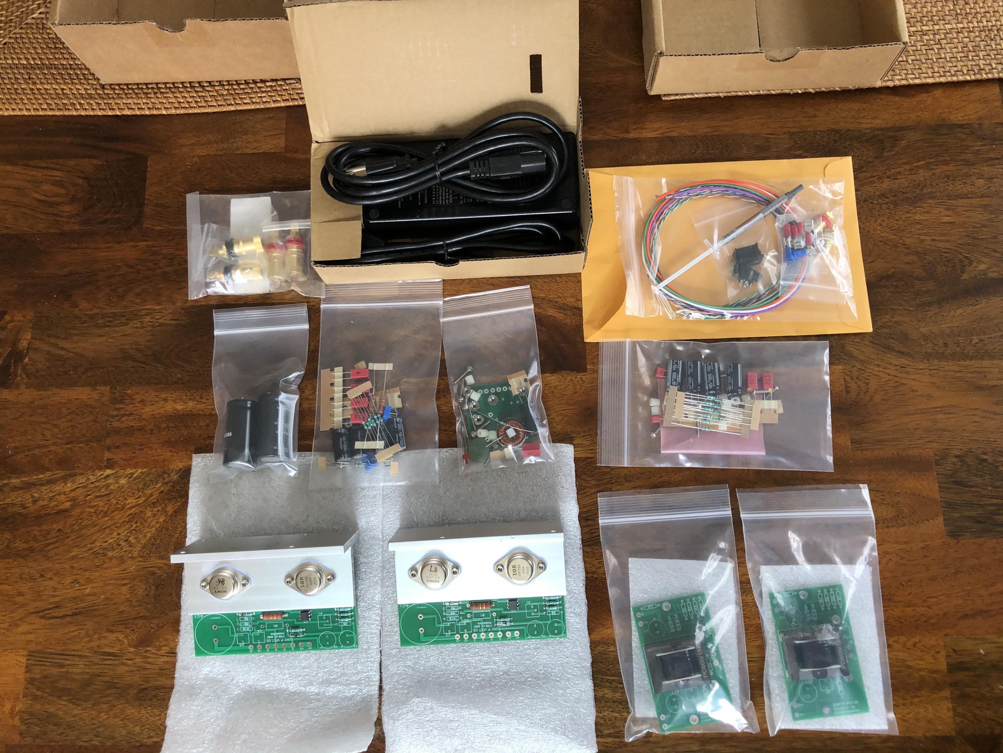

The Eagle has landed...well at least the first half of it.
That was pretty fast considering that I think I was the last name drawn from the hat.
I was lucky enough to be close to the shipping origin in MA.
Strangely, the package left MA, went to RI and then back to MA before coming to me in CT. Oh well, who cares?
I did a quick check on the contents looking at the boards for issues that have popped up already.
It looks like the silkscreen for C1 on the OS boards is as it should be.
The FE boards have R7 present.
Anything else I need to remember to check?
I’ll be doing an inventory of the packet contents, testing and labeling resistors etc once I can finish a little work on my F2Js and clear my bench off.
