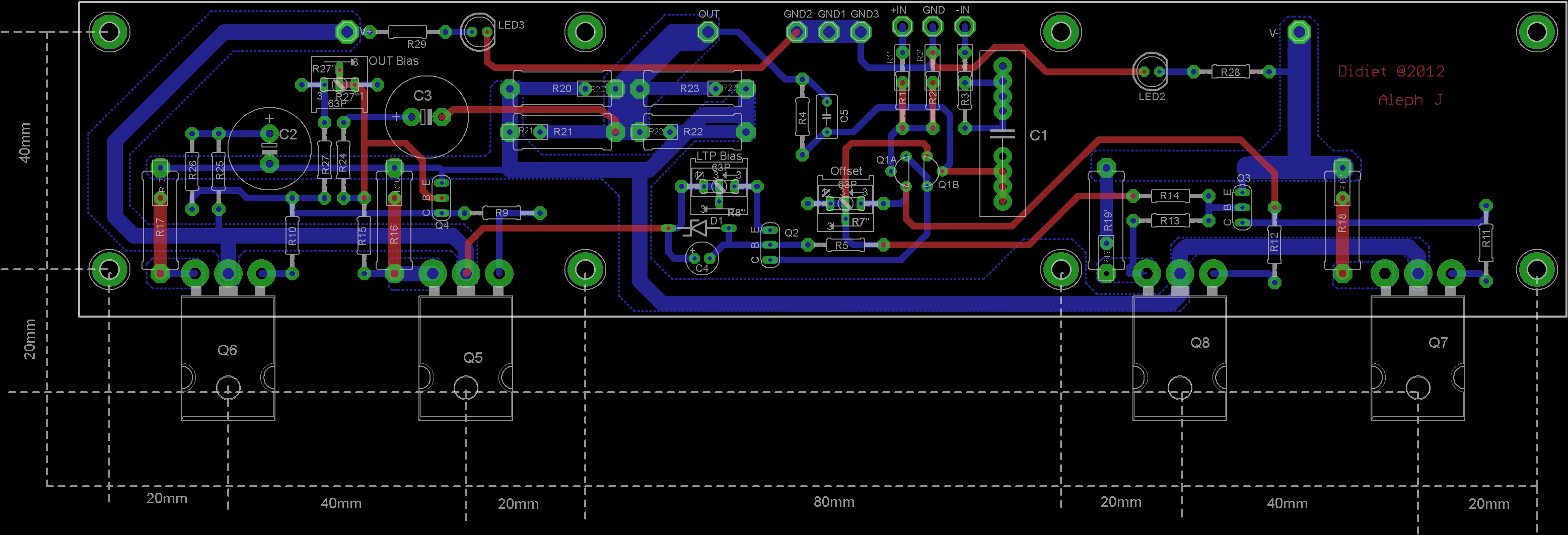

Request for interest!
If you are interested in a set of these boards, could you please reply in this thread? This is merely to gauge what the interest is in this project.
It seems to be getting a fair amount of views, so now is the time to speak up if you haven't yet.
The scope of this project will be limited to the 'Official' Aleph J schematic - with our slight revisions... Specifically it will only be for 2 fets each in the output section and the current source. The driver will be the pair of 2SJ74, as J109 are practically impossible to source anymore.
The layout and scope will not significantly change from this -
Remember, Nelson himself said that he considers the Aleph J to be the best of the Alephs... Combine that with the ability to build it on the Universal Mounting Spec and this should be a winner!
-Jim

JT asked me to chip in
few cunnin' additions
Baldrick ZM
edit - leave place for small value gate resistors for both jfets in LTP
Baldrick ZM

Zen Mod -
Thanks for the insights! I think there is room for your suggestions...
What is the purpose of the resistors on C and E of the current source?
And why add gate resistors to jfet LTP?
I'm only asking because I'm an electronics beginner compared to most. 🙂
