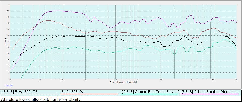

From another thread started recently we can see some speakers actually use these variations to their benefit:
I think the Wilson Sabrina will probably be praised for natural sound and good imaging capabilities.
For those with EQ, try it, you might like what you hear 🙂.
