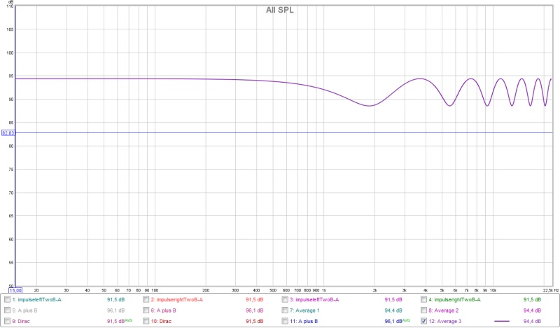

If you listen to a stereo loudspeaker in the commonly used 30 degree triangle and have an averaged sized head, in the sweet spot you will get combing from the left speaker reaching the right ear and the right speaker's direct sound. Obviously also the right speaker reaching the left ear and the left speaker's direct sound.
If you look at what that comb pattern looks like:

It might explain why a dip at 3-4 KHz is favorable. A peak at ~5.5 KHz lines up perfectly too. Throw in a mild Q peak at 1850 Hz and it gets even better.
The higher frequency dips and peaks get more head shading and won't be anything as severe, what I show here is a worst case scenario.

This is an average of the frequency response of the direct and the following combing. Do you see the dips and peaks at the same places? Thanks to BYRTT for tracing Toole's measurement. (I believe this one was recorded in a reflective room, according to Toole's standards)
Remember, the upper graph I posted represents what happens at the sweet spot after about 0.270 ms. The direct sound has already hit your ears. Move out of the sweet spot and things change rapidly. The left and right ear get different comb patterns. Only in the sweet spot both ears get the same dips and peaks for all phantom center info.
Some mild variations at these frequencies are favorable, countering the dips and peaks seen here, especially in the phantom signal with both speakers playing the same material.

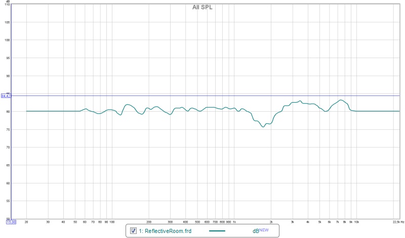

I think the Wilson Sabrina will probably be praised for natural sound and good imaging capabilities.
You are highlighting the importance of FLAT frequency response...
While I agree that flatness contributes to naturalness, many other things (distortions) will trump on it...
(Regarding the relationship with imaging, I have no idea...)
But FATIGUE may appear regardless of FR flatness. It cannot be seen from FR chart. But an impedance chart might show one or two hints. But most is in driver's NLD and the crossover works.
I think you are missing my point, Jay...
I'm actually promoting non flat frequency response for speakers used in a Stereo triangle.
Bump at 1850 and 5500, dip at 3700 and 7400, not much is needed, but try it and listen.
