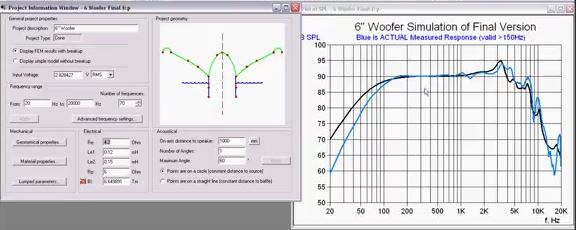

Juhazi's Finecone video is fascinating.
https://www.youtube.com/watch?v=nlaGb67RPwc
Dustcaps, cone material and damping, edges. All quite interactive.

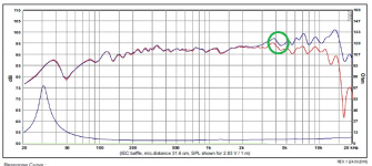

SB Acoustics seem to be moving towards flat frequency response with lively materials for this mid.
SB Acoustics :: 6½" SATORI MR16P-4
I'm absolutely certain it has some phase issues around 4-5kHz. Marked in Green. That's just cone geometry.

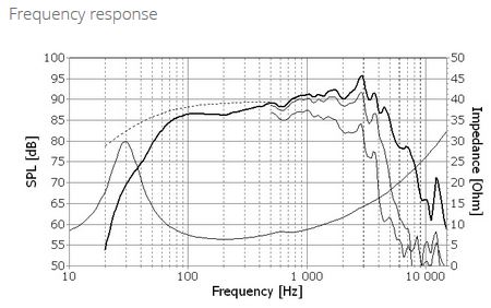

H1659-08 U22REX/P-SL

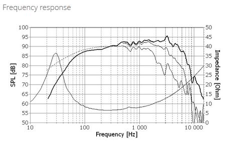

H1288-08 CA22RNX
Always hard to decide if you want to go with mechanical/material or electrical control of the slopes and breakups. I really don't know. 😕
It's beaming. A 6.5" with vented motor and Fs=31Hz, that's not a midrange but a subwoofer 😀
