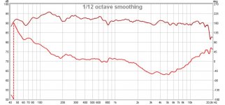

My first try of Harsch (comp to LR4)

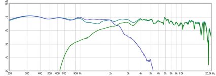

I've made a test speaker to see if I like compression drivers (well one at least) and to test an idea of how to control vertical directivity. I looks like this:
It's a Beyma CD10Fe on Eighteensound XT120 between two woofers (5") that were salvaged from a small floor stander from Audio Pro. Dimensions of baffle are 25x69 cm (10x27"). (The reason I'm so detailed in this post is because I've never really looked at crossovers before, so please tell me if I'm doing something strange.)
I first used a little PEQ (minidsp, only subractive) to flatten the curves:
This is how I first set up the xover (LR4 1300 Hz):
Looks quite nice IMHO.
With phase:
Distortion:

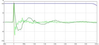

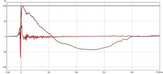

How about step response?
Oh. Not very good.
Lets test the Harsch method (1300 Hz as well):
Much better phase.
Much better step. Impulse is still first -70 % before +100. Fixable? I chose a reasonable delay from a physical point of view (deep waveguide) and then added the delay from the Harsch method. After that I tweaked (increased slightly) to get a cleaner step response.
I only have one speaker done (only bought one CD) and the amplifier is way too noisy (or the sensitivity of the CD is too high) for me to give any comments on sound quality.
EDIT: Measurements done outdoor, ~1.5 m above ground, 2 m distance. Only CD measurement windowed, the rest is using 1/12 octave smoothing.
/Anton

Thanks sharing onni looks quite nice, regarding -70% do you have LF/HF drivers wired in same polarity as they supposed to be both for the Harsch XO and LR4.
Great work Onni! I have marveled at your 3d FEA sims and 3d waveguide printing and now you also make speakers for real. Test boxes are exactly the way to go and glad you are trying out xo with minidsp route. CD's are indeed noisy because they are 108dB sensitive. So a clean quiet source is needed to get rid of hiss. It's not the minidsp but typically the computer sound card. Switching to a good external DAC helps.
Agree with Byrtt that you may have polarity of CD reversed. Flip that and you will need to readjust delay.

Flat phase before crossover?

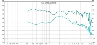

You are correct in your assumption that there was something wrong in the wiring, either the amplifier (TPA3116) has incorrect markings, or I've misinterpreted the markings on the woofer. I can't seem to get it working though, is it because the phase needs to be flat before adding the crossover?

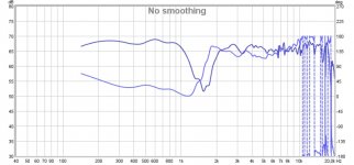

Here is how they measure before adding crossover (wired so I get correct direction on step response):
Woofer:
Tweeter:
Together:
And this is what happens if I follow the method:
That is, setting 0.3 ms delay in the woofer for physical time alignment (is there a way of getting this from the measurements?) and setting 0.38 ms delay on the tweeter (0.5/1300 Hz). Impulse/step response:
If I then invert the tweeter I get this:
Is it all due to the phase slope of the tweeter? If so: can I add something (all pass filter) to correct this in the minidsp?
Note: all measurements at 1 m distance, 1.3 m height and windowed (2 ms before, 5 ms after). Directly in front of tweeter.
/Anton

Use the "overlay" feature in REW and plot the step response for woofer and tweeter with the phase such that both go up. The overlay will show the delay between the tweeter pulse and woofer rising edge. Adjust delay to move these together. A delay shifted more than 180deg will require a phase flip on tweeter. That means your delay of is off by more than a half cycle at the XO frequency.
You are close. You also can tell when you do it right in that combined response will fall a little below the plain woofer response.

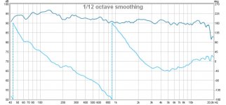

Hope below plots can help as target curves, these are made in JRivers digital DSP engine, soundcard then hardwired between analog I/O and REW can be made listening inside loop because of a genius JRiver virtual soundcard addition to sound system. System bandwidth are set with a BW2 HP at 70Hz and BW2 18kHz LP but the LP get steeper because of REW and soundcard bandwidth limit of 24kHz cut off. So they are real electric measured filters that you can use as ideal target curves your system should replicate in acoustic domain. Attach two frd files you can import to REW as visual target slope in "All SPL" or in "Overlays" window, these are normalized to 67dB at moment but just offset them to other SPL leves in REW is no problem. HP these plots is set the textbook 0,38mS (1/1300x0,5) delay, add or subtract to this setting to calibrate the physical acoustic offset at 1300Hz you probably have.
FR plots are 1300Hz Harsch and LR4 XO, IR/SR/Phase/GD are Harsch/LR4/Bandpass 70-18kHz with no XO.

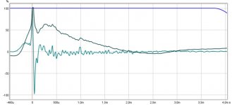

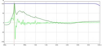

I recently swapped the polarity of my comp drivers (or mids in below measurements). Now they step in the same direction than the mids (and every other driver as well). Phase distortion increased from 180deg to 360deg (compared to minimum phase plot) and the measured excess group delay increased, yet the sound is snappier with drums and other percussions instruments, piano. Dynamics seem more dangerous, waking up the half-sleeping listener. 🙂
I believe the snappiness comes from the fact that same direction stepping drivers can create bigger "one direction" pressure changes (rarefaction/compression). The wavefront of given transient is either compression or rarefaction, not some mess of both in tightly spaced manner like in "regular" multiway speaker. Tactile sensors and ears detect this as more explosive sounds (even though there could be more phase distortion like in my case).
These are 0deg near field measurements what exaggerates the midwoofer's output.
Phase of original setting:
Phase of the new setting:
The old setting has one phase wrap, the new setting has two (although the lower one is almost out of the Synergy horn's pass band):
Step of the original setting:
Step of the new setting:
Excess group delay of the old setting:
Excess group delay of the new setting:
Basic GD plots of the settings:
