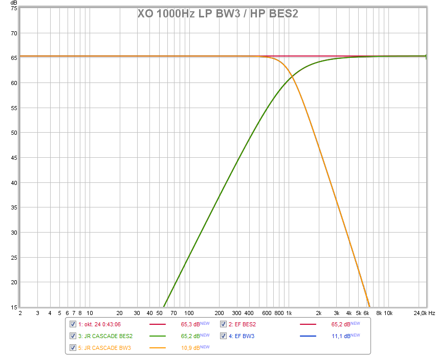

This is part one covering the Electric textbook slopes in JRiver, another post will cover helper target slopes for acoustic filters:
Having the electric slopes inside a JRiver PEQ container is of big flexible help and powerfull because inside that container one is able to example split/mix/route busses in upstream part of the container, then add different complex filters going downstream and mix/route them again lower stream inside same container, think that gets harder or maybe impossible using some free 3. party VST plugins.
Problem is regarding electric textbook XO slopes JRiver only has BW 1/2/4/6/8 order build in.
Most will probably know to create LR slopes it takes two cascaded BW filters to create a LR, example BW1 in series BW1 gives a LR2 and BW2 in series BW2 gives a LR4 etc, so now we able to make above mentioned standard BW filters plus a handful LR filters created/based on the BW ones.
At this thread also needed is BES2 as seen at post one and Pano also need a BW3 which is not listed in JRiver. To create BES2 electric textbook filter at example 1000Hz cascade LR2 (2xBW1) at 1000Hz with PEQ at 1000Hz Q=0,58 +1,3dB, and to create BW3 electric textbook filter at example 1000Hz cascade BW2 + BW1 at 1000Hz + PEQ Q=0,84 +3,0dB set at 1000Hz.

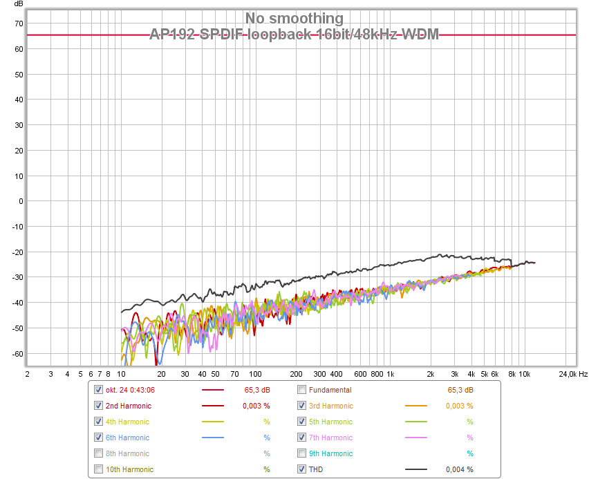

For documentation below is AP192 sound card hardwire loopback SPDIF I/O, REW send to JRiver virtual sound device and listen at AP192 input. Because of loop can't at present use ASIO driver and higher sample rate on the same computer therefor run java drivers 16bit/48kHz. As can be seen at legend the ones named "EF BES2" and "EF BW3" is third party free plugin from this link RS-MET and their traces is exactly overlayed with the two named "JR CASCADE xxx" which is made as written above. Two other pictures is just to document with no filters set in JRiver we should be able to trust result of sound stream from hardware and software.

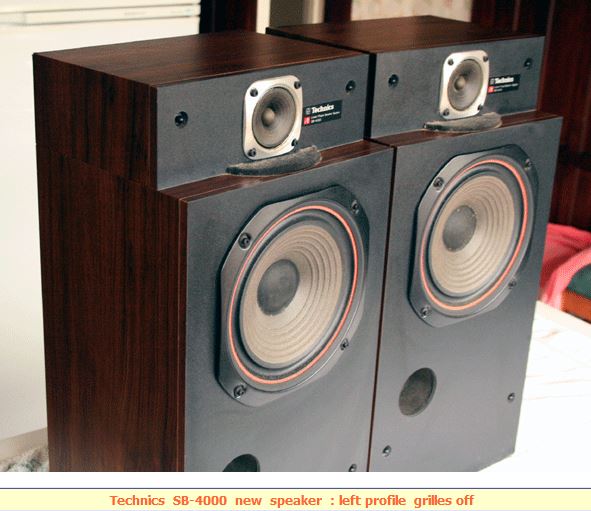

I think we are looking at a paper speaker like this time-aligned Technics SB-4000 to get transient perfect.
4th order 8" bass isn't hard, because that is what they do on simple second order electrical filters. And you can notch the Fs of a cone tweeter with a first or second order filter to get close to the 12dB/octave target slopes.
So we know what this speaker looks like. 😎

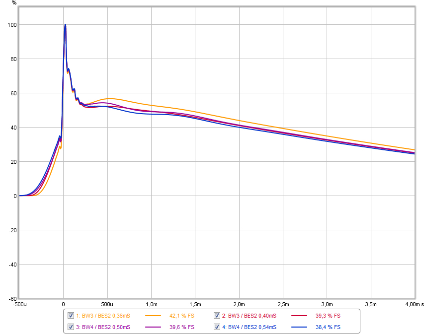

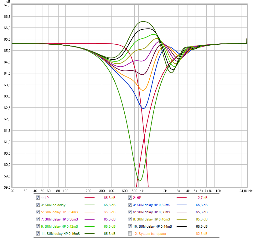

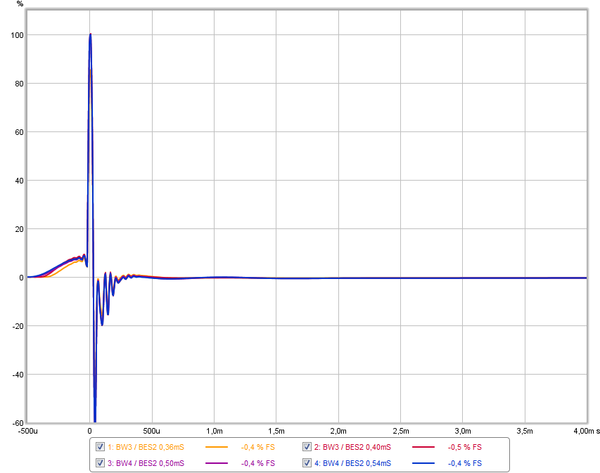

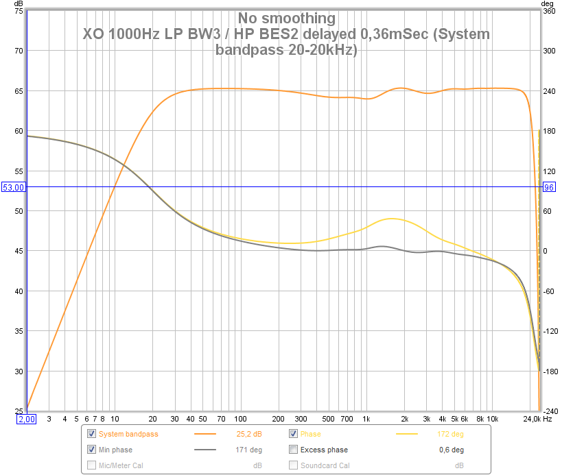

Here is wiggles, never zoom into this vertical range : ) as seen in first picture, see legends to understand, the 0,36mSec is the math Pano posted.
Picture 2 is Phase.

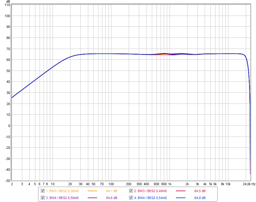

Picture 3 is much nicer 50 dB vertical range with 0,36mSec delay for tweeter and a system passband set at BW2 20-20kHz.
Picture 4 is IR/SR for picture 3.
Picture 2 is Phase.
Byrtt,
Thanks! Those curves look great - it is so clean as if you did it analytically by mathcad or something. Hard to believe those are actual measured electrical signals. Can you show how Pano arrived at the magic 0.36ms delay as the optimal based on equations only?
In Fig 3 with frequency response on larger scale, I see that there is dip that starts at 350Hz and this can have some benefits of removing the "thickness" in vocals to allow more discriminating monitoring of voices a la BBC's LS5/3A which has an intentional dip at 350Hz.
The SR doesn't look as good as the Harsch I don't think - there is a large overshoot peak.
I think now I understand how my Kazba coaxial managed to have a SR that looks something like this when I set electrical as LR2 on both LP and HP. The natural fall off and the electrical LR2/LR2 probably made some asymmetric slopea. Then when combined and the natural acoustic delay provided by the recesses coaxial driver arrangement, it put a delay on the tweeter and it worked out to be quasi transient perfect. I wonder if this may be perhaps why LR2 XO's may prove to be so effective with coaxials? Oh, you have to keep postitive polarity on both.
They look good have you measured if they transient perfect ab fabric or modded them to be there.

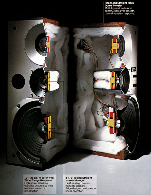

Check out these other phase linear (transient perfect) speakers from Technics (horns and waveguides to achieve time alignment) - beautiful cutaway. They don't do that kind of stuff anymore. Seems these have XO's in the 3k to 4k range.
Technics SB-X50 on thevintageknob.org

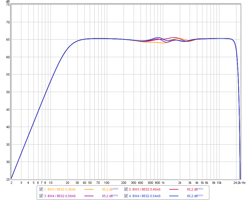

Some of the clean think come from the dialog box after push "Capture" icon, in that dialog box there's a default image width botton that always need to be pushed to have fonts and traces to be as sharp as possible in plots and in a way i wonder why it don't optimize image by itself.
Pano posted below regarding delay.
Below is BW4/BES2 verse BW3/BES2 inside a system bandwidth 20-20kHz, there is two delay examples for each slope setup see legend data.
Picture 4 filter effect looks good when vertical range is set a whoopee 160dB scale from -50dB-110dB as datasheet for A12P.
