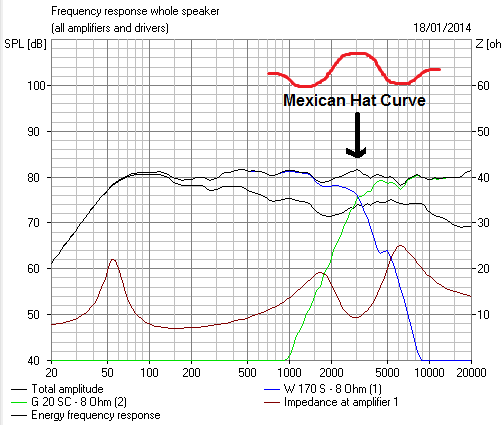

The mids' acoustic low pass is quite sharp, which is propably the source of the delay.
In SR it can be seen that the midwoofers start to step little before than the comp driver (around 0,4ms before) but the step of the woofers is "sluggish" to rise due to the restricted bandwidth/low xo-point (low freqs are slower 🙂) and sharp acoustical xo'ing.
I don't use any passive xo for the mids (just the acoutical), keeping things simplistic and SET friendly. Need to start up Xsim for the new setting, if something could be done to get the steps little bit closer together.
In synergy and other coaxials the time coherency is nice feature since the step response is ~the same no matter which angle you measure the speaker. With non-coaxials the time coherency is more "imaginary" and happens more or less perfectly only in one point of space.

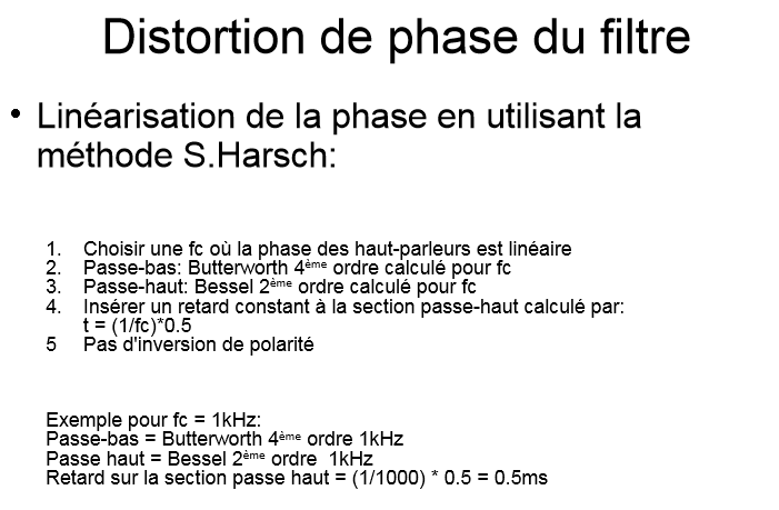

xrk971, enjoying this thread very much. I was curious about polarity for the two way Harsch transient perfect filter. Seems to be positive for time-aligned?
Don't think too hard about this at all, because it's an issue that I came across with time-aligned series filters, and not transient perfect because no 90 degree quadrature I think. But good phase alignment often goes hand in hand with 3dB peaks at crossover or a mexican hat shape. A big takeaway from your ideas here, is that flat frequency response is not compulsory or always desirable. 🙂

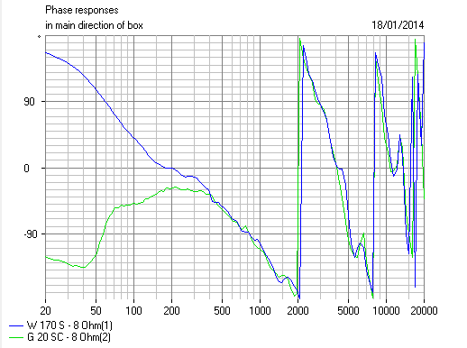

TBH, I'm still a bit confused about the half wavelength time delay, but I think it's about 45 degree phase difference at crossover. Somewhere between -6dB phase aligned and -3dB quadrature aka 90 degrees butterworth style.
Because it looks like about -4dB. Looks like Harsch is saying place the tweeter acoustic centre half a wavelength back from the woofer's acoustic centre if you're not doing delay stuff. That's UNUSUAL! 🙂
Sys7:

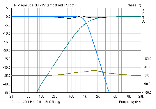

Polarity is all positive, and the half cycle delay gives a 45 deg phase shift at XO and helps to flatten the 3dB bump to several smaller bumps (squiggles). You know you have it right when the combined response dips slightly below the bass only and it wiggles up and down. The proof though is in the step response 'pudding'. 🙂 You can hear it too very clearly on acoustic instruments.

That AN does have a remarkable resemblance to the Harsch BW4 and BES2 target curves. But the box has a flat baffle and there is no way to implement that kind of delay passively without either a stepped baffle or a waveguide to move that tweeter backwards. I think with careful selection of a woofer with a proper acoustic setback and a custom waveguide you can achieve time alignment with a passive Harsch. In fact that is one of my to do list items.
For low XO points where radiation from the back of a woofer is perfectly acceptable, flip the woofer around magnet out to buy yourself circa 50mm of delay. Ugly as hell but would probably work .)

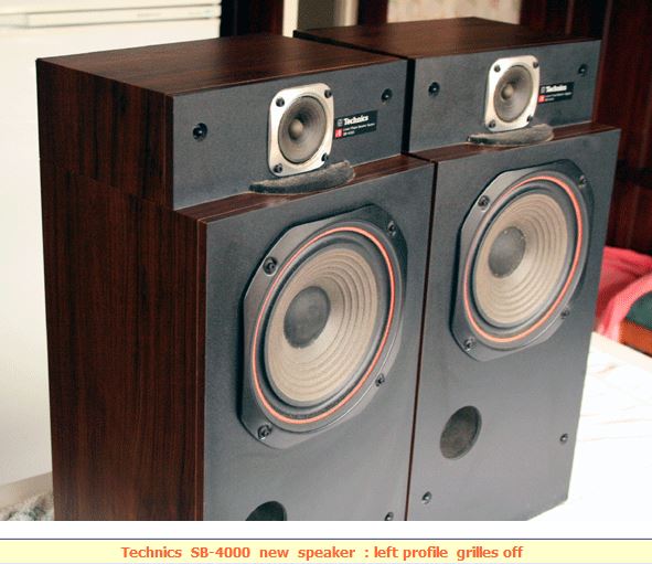

I don't think physical time-alignment is hard. It ends up looking like this Technics idea (below) with a big bass. And I'm not averse to flipping tweeter polarity.
But truly, xrk971, you are doing some excellent work here. It's all starting to fall into place for me. A half-wavelength at 3kHz is nothing really. A few centimeters. 😎

You mean to get tweeter in same positive step polarity as woofer and not to cheat win some physical offset distance ..... 🙂 don't think missed Steen Duelund would approve last as he wouldn't approve a recording that is inverted .
If you flip tweeter polarity it is not quasi transient perfect anymore. It sounds different - basically a time aligned symmetric LR2 - not the same as a Harsch XO.

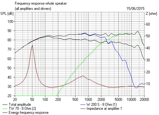

One significant problem with this Harsch approach is that the HP function on the tweeter has a very shallow rolloff. Typically using a first order HP function on a tweeter that has a low resonance frequency is a no-no. A first order crossover can allow the excursion to continue to INCREASE below the crossover frequency if the tweeter's response is not also falling off, which is the case with modern low Fs tweeters. This is why a second or higher order crossover is typically used.
In the old days the resonance frequency of tweeters could be 3kHz, and the excursion would level off on its own below Fs since it is a second order system. Adding a simple cap or first order network was sufficient, and this can be done in conjunction with the tweeter's own rolloff to make a third order acoustic slope. If Fs is 500Hz, the "leveling off" doesn't happen until 200Hz, by which time the excursion is getting too large for the tweeter's suspension. When you use a Harsch crossover with Fc at 1.5kHz (for instance), there is only first order attenuation on the excursion until resonance, which is much more than an octave below, and excursion can continue to increase below Fc.
I strongly suggest that anyone using the Harsch crossover should check the tweeter excursion.
