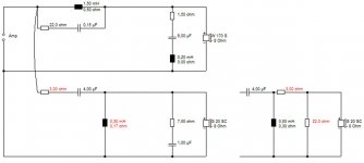

Nice little cameo there, ODougbo. The old elliptical filter notch at 4.5kHz, eh? 🙂
This would be 2mH series, 2R 0.2mH 6uF shunt on a single bass driver.
I'm not surprised that a 10R input resistor on the tweet was too much attenuation on a loud parallel MTM. FWIW, 10uF looks rather larger than I'd expect too for what, 2.5kHz crossover? Probably boosts the midrange at crossover, which is no bad thing.
I've been trying smaller bafflestep coils with this sort of thing lately. Just makes the sound livelier, and in practise sitting a speaker on a cabinet boosts the bass anyway. Say, 0.68mH in your case.

Hummm don't know what to think now. As mentioned the bass is rich and powerful and never heard them sound like that before. But is the mid down too far? Is the tweeter working hard enough?
Is there an easy adjustment by changing the series cap and adjacent series resistor, or will changing these values tilt other aspects of the design?

In general you just make the bafflestep coil smaller and adjust everything capacitative up. It makes for a crisp sound and projection and clarity in the midrange. I don't like speakers that thump on bass. And anyway, bigger bass excursion increases distortion.
Room gain is huge below 300 Hz IMO which can overcome a seeming modelled dip on bass. I think people overdo bass. Put the speaker near a wall, if not built into it, and it sounds bassier anyway. OK dips and peaks, but you get used to them. I treasure a good vocal and a tight bass, not a thumping or booming one that annoys the neighbours. 😀
And, yeah, I think an 8" two way gives a very balanced sound in ample rooms. But I could probably live with a 5" bass in a tiny bedroom. For sure, huge speakers in tiny rooms are a disaster. You then need stands and a close listening (nearfield) position just to reduce the boominess by getting them away from the wall and floor.

Hi Folks,
Just had to try some combinations from post 14.
After several attempts this is best so far.
The middle looks great but also the tweeter has less rise above 4k.

You'd have to model it really, but it makes a tank across the bass coil. Really a 10kHz notch. The size of the 22R resistor determines the depth of the notch. Common treatment for metal cones too.What is the .15uf cap doing ?
Another notch at 5kHz with the shunt 0.2mH and 5uF and 1.5R. Typical for 6" bass. All in all, aligns driver phase well.
Ah yes, I forgot that caps can resonate with the inductance of a voice coil.
And ideally notched.
