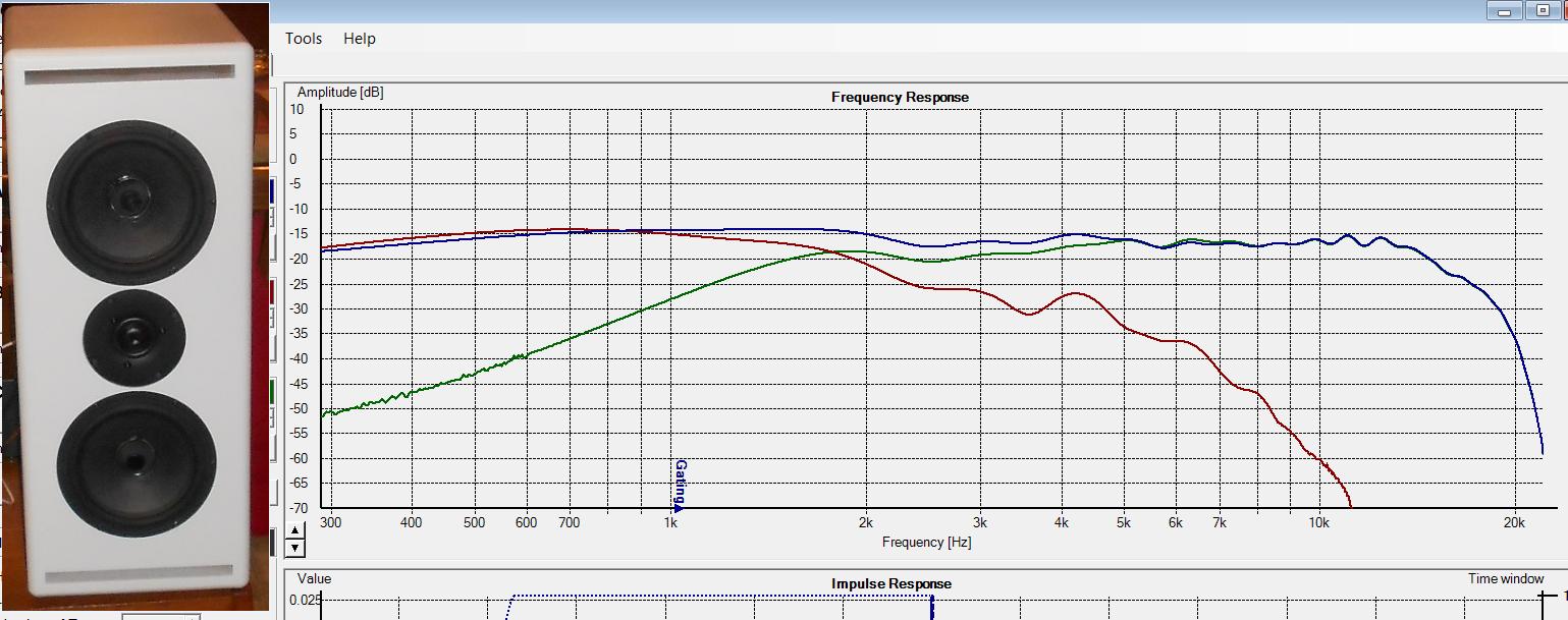

Now trying this combination, which is working well also.
Mic response test is mostly level.
That's $20 worth of parts on a $45 tweeter - btw.
Forgot how much wool to use so started light, 3oz per woofer, that's a bit on the light side, but can hear what the woofer is doing. There is some overhang in the low bass without the sub xo (set at 120hz now); and/or the active xo set at 2,500hz (no passive) works nicely too.
Curious if bigger boxes tuned lower would tame that upper bass, maybe move port to back of the box?

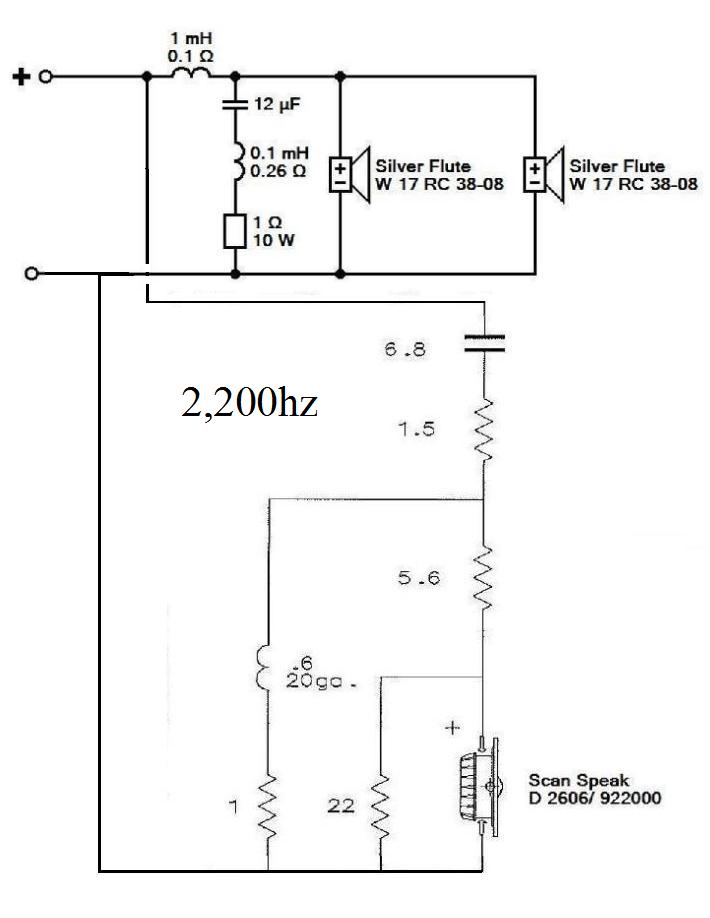

The gemme tanto only has a single cap on the tweet.
I agree on the notch.
Those flutes have a narrow peak at 4khz and 5khz.

Removing the dust cap didn't remove those peaks ?

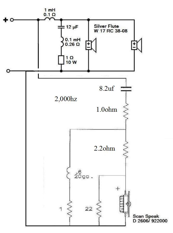

I'm thinking yes, I'm back within +- 5db, xo-ed over at 2,000.
Actually There was a breakup every now and then, which is gone now and they sound silky smooth. Could have been have been one or both of these things I guess:
* Replaced the $9-1.0mh coils with 14 awg air-core.
* Lowered cap size from 10uf to 8.2uf and raised level.

Highly recommend following the woofer circuit on post #22. It works beautifully, also had better results with 1.0mh air core inductors.
