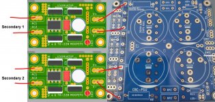

Hi Dave,
Just connect the V+ and V- of the LT4320 tht to the CRC .
You can connect the transformer secondaries to THT LT4320 directly.
If you are planning to use the snubber components, provision is already made for SMD snubbers under the THT LT4320 under AC tabs.
Though what you have shown seems to be correct, but leads to too much wiring.

Doh, Like this?
I thought the jury decided not to use snubbers?

yes, the connections are correct.
Just use them without snubbers.. you will notice definite improvement as reported by many diyers.
