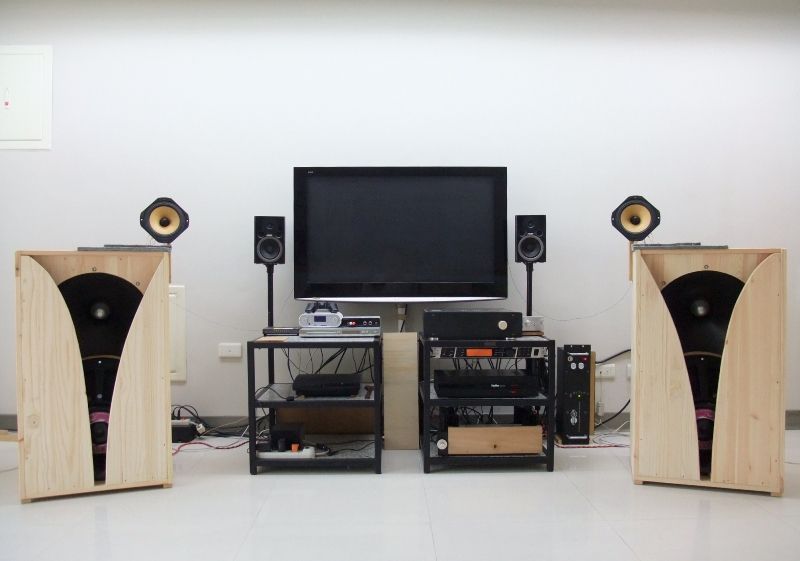

The last trial on sideways was not satisfied, so I put it back to upright again.
And considering the alignment of drivers and characters of distribution by frequency, I thought it'd be nice to try upside down - large end on top. So I did.
I like it right away. It's smoother and better integrated overall.

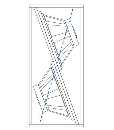

A dashed blue line connects approx locations of the cone necks. As can be seen, the lineup of acoustic centers is in the opposite trend of the baffle. As my Karlson is not fullrange and needs HF unit on top, so it'd better take the reclined alignment and put the HF on the rear half of cabinet to make the whole thing radiates slightly upward.

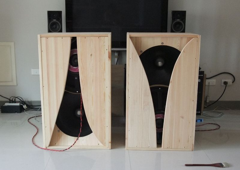

In addition, I've been thinking to mod the wings to reduce the resonances. So, here they are:
The rear side is on the left; right is the front.
There's about 5-6 cm width being cut off at the widest. And slimmer wings are on the same side of cabinet. So it's 10-12 cm difference of path lengths in total between the left/right sides of cabinet.
Overall view:
There's indeed improvement by the asymmetric wings, but it's not a complete cure to all resonance problem. I guess the degree of asymmetry is not enough.
Nevertheless, for co-working with another unit on top, I like it upside down. It's much better than previous setup.

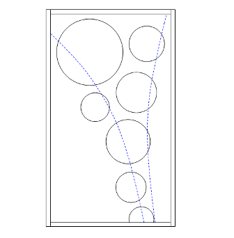

I have another idea - a combination of the 2 above, maybe applicable on the rear side at least😀
(or upside down, blue dashed lines give the approx range, black circles are actual cut)
I think it's useful to differentiate the dipole cancellation paths and spread the resonant peaks within the cavities.

Is that the EV VMR sitting on top?
