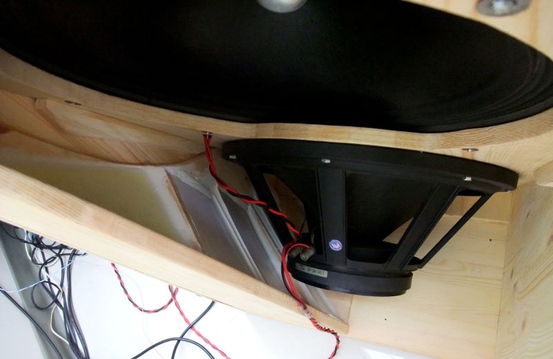

To get some music, I added the Jordan's Flagon (with a cap for simple 1st order HP) to fill the upper half of spectrum, while the woofers were unfiltered, playing all they can. Turned it up, I had the following observations:
* Very dynamic and lively sounding from mid to bass. Unfortunately the Jordan on top is not a good match. It seems they are in different scale of dynamics. Mid to mid-bass hits hard, while the HF can't keep up. So the balance is not right at the moment. I need more time in overall tuning. (And, eventually I'll use other unit with higher efficiency, also in dipole for consistent directivity from low to high)
* Some resonances get more pronounced when playing loud. All panels seem very calm by touch, so I suppose the problems would be mostly in the cavity between drivers and wings. Will try more damping material. Seems there'll be many things to do on this ...
* Unexpectedly, there's little higher frequency in the sound escaped from the narrow part of aperture. It's mostly bass here. Higher range sound is radiated from the lower driver with less blockage. Should I put it upside down? But then the driver on top will be facing down. Hmmm....

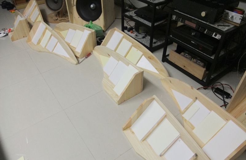

The area of aperture is about 52% of total Sd by calculation -- I make them several sections of trapezoids and sum. This could be somewhat small (for a Karlson). In my previous slot-loaded dipole, the area of slot is 40% Sd. That only loads one side of driver. Now it's 52% but on both sides, so the compression is more severe than before.
Maybe it's the reason I feel the pops, or, it comes together with some effect of resonances.

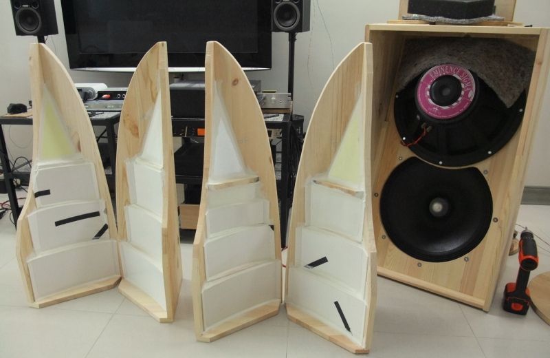

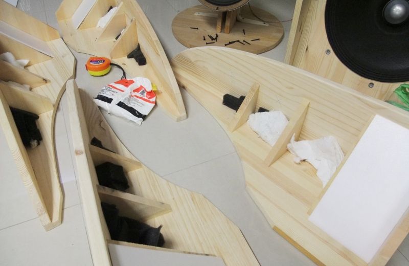

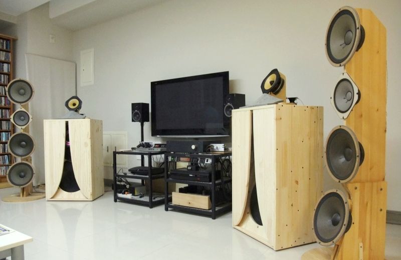

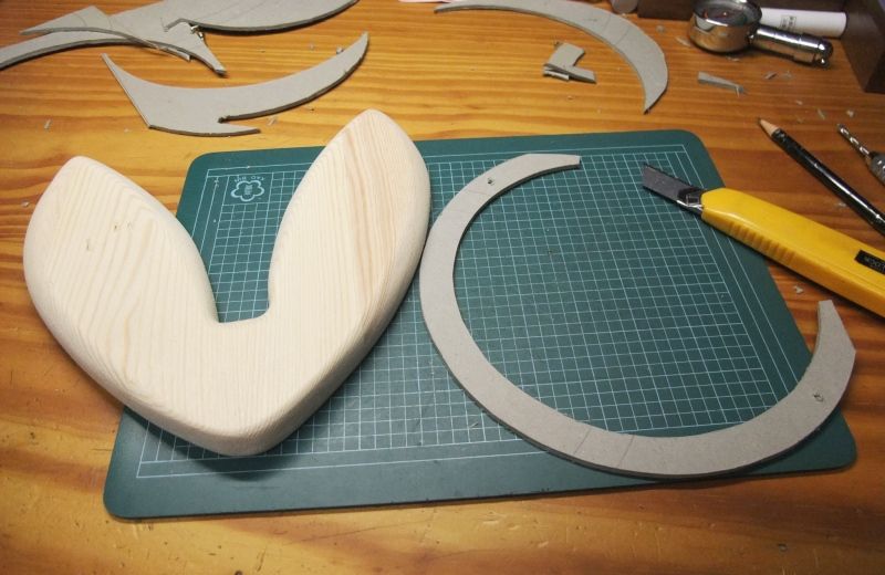

Say, I've done the following during the last weekend:
Sealing the cavities formed by those triangle bracings, with a little damping material inside, and double-wall (5mm PS foam board and 3mm foamcore) :
I drop the idea of expanding PU foam and take these leftover materials first. But it's so time consuming. And it hurts my back working on floor. 🙁
I want to reduce the space between drivers and wings by these slant surfaces.
This is taken with only one wing being fitted:
(if with both, I can't take the shot. Not enough space and light.)
To my surprise, again, the reduced space of the cavity doesn't affect much to the mid (higher range of this thing). Some resonances seem reduced, but barely detectable, I'm not quite sure yet.
It turns out the obvious improvement is in the lower bass. I feel it gets enhancement and plays more effortlessly. Maybe the reduced space loads the drivers more. (The fs is slightly dropped, from 16Hz to 15Hz.)
By the experience up to now, it seems the narrow part of aperture affects the lower range more than the high. So, maybe it's worth to try the asymmetric opening suggested in the earlier post, if anyone follows this. (who, me? let me catch my breath...)
At the time I tested them, the sealant wasn't completely dry and hardened yet. So I couldn't turn it up enough to reveal the full potential. Then I had to re-adjust the XO etc., many things were waiting.

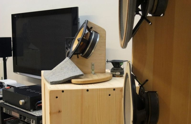

For the top, I swapped the Jordan Flagon with 7" Focal mid:
I mount it by my old trick - using a single board as the spine to support the magnet and rear side of frame. (and you can see the upfiring tweeter behind the mid)
A 20 uF cap is in series with it. That's a 6dB/oct slope beginning at 1kHz or so. In this range, no baffle is needed. And, helped by the powerful magnet and light cone, it's capable to play up to 15kHz.
This unit is tilted up by 24 degree. By this angle, its axis (the most powerful lobe) is aiming at the point on ceiling right above my head of listening position. So the reflections from my back would be largely reduced by multiple bounces and long paths. The floor reflection is also reduced, as it's largely off-axis seen by the floor. Also, for off-center listening, it would be more even. I borrow (steal) the idea from Gradient.
The whole thing:
It's funny that the Focal mid looks so tiny in the system, but it's the loudest. Compared to the previous Jordan, the level on amp has to be turned down a lot.
More dynamic and lively sound aside, the best thing is now the whole system is dipole (except the very top of the spectrum). This makes the in room response more even, with stable tonal balance everywhere in the room. It's also what I'm used to. (Jordan Flagon itself is a decent and cute little speaker, just not for here.)
Two naked dipole arrays are playing ambio channels (R-L / L-R) of Hafler circuit by another amp. And there's another central tweeter behind the TV which is also upfiring not visible in the photo... (So it's actually a 4.1-ch system with 17 drivers and 6-ch of amps...)

Looking good. I like the Focal driver in dipole. You can buy bare Focal drivers? I thought they only use them for their speakers.
You could buy Focal drivers for DIY until a few (10?) years ago or so. I built my first fully from scratch speakers with them. Dynaudio used to sell to DIY market too, back in the 90's.
Ah, so many things... I'll keep doing experiments in the cavity, until I'm satisfied (or completely exhausted).
I also have to 'clean up' some minor problems in the signal chain and amps, too. Testing time is very limited during the weekday, I don't have the chance to crank it up, yet. 🙁

CLS, when you play it - is there a powerful jet of air squirting through the narrow portion of the aperture - and is the wind noise an issue? I bet it's pretty powerful but quiet - something about the Karlson shape vs a regular duct. Keeps much quieter for how fast air moves through there.
Maybe he is talking about how scary the cicada's face looks? They are actually friendly harmless bugs. Big and grotesque but harmless.
Now back to speakers.
No wind noise. Near the slit, the pumping of LF soundwave is obvious, but I don't detect any noise. The edges of wings are rounded a bit, with about 2-3 mm radius, not shown in the photo. For such frequency, maybe it doesn't matter. Just nicer to touch and for peace of mind.
And, in fact, the feel of the impact is better perceived from a distance, where a wider range of frequency can be heard as a whole. It's all bass in closely front of the slit, similar to the port of a vented box.
Tested more these days, the filled cavity indeed reduces resonances, I can remove some of the notch filters, but not all. I'll keep trying. It seems more damping is needed. Or, maybe I'll have to cut the aperture larger, argh~
I didn't mention in the previous post that I also made this in the last weekend.
Make a guess 😀
Make a guess 😀
